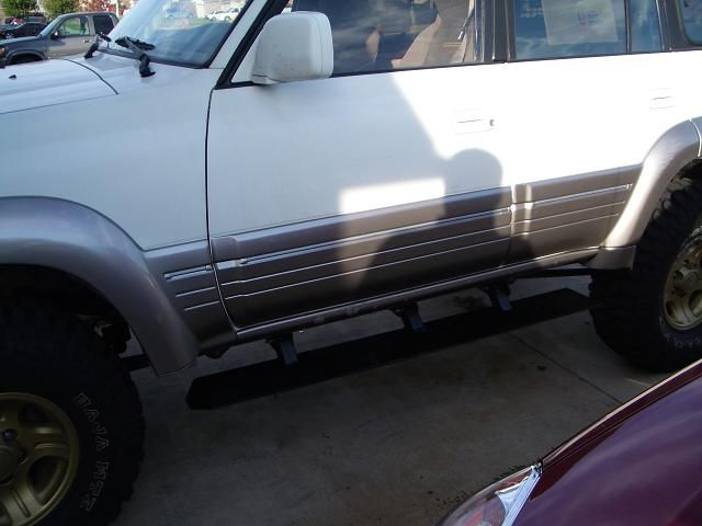

You'll have to ignore the paint - I'm going to Herculine once I get the passenger side done. There are pins that hold them in the up possition. I have air cylinders that will be plumbed eventually to power them up and down. In the down possition they are a little lower than stock running boards. In the up possition they are as high up as any slider. Shape is custom made from 8", 3" and 2" x 3/16" steel. Shape obviously protects the whole rocker, and does not have any catch points. Outriggers are 2x2x1/4" square tube. Pivots are 3/8" grade 8 bolts. I have room to bore out to 1/2 if need be. I showed the frame mounts in a previous post.
Well, here's the pictures.....
