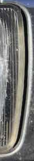

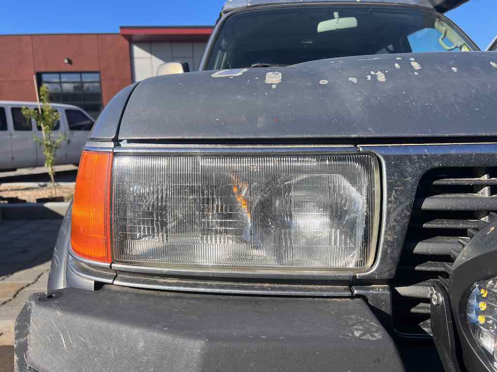

Here is my 94 grille with the later style headlight:
They aren't the same shape on the inside vertical edge. One is more vertical, the other is more curved. I'm not trying to start an argument, I've just had to deal with this. If you put the newer light on the older grille, it becomes quite obvious.
View attachment 3415511View attachment 3415512
Thats not a 95-97 LC light, that is an LX light. As mentioned, those are quite different.
Three variants.
91-94
95-97 80 series
96-97 LX450
On the 80 the difference is grille-to-headlamp brackets. On the 450 it's the inner vertical slope of the lens as noted in post #7 above.
