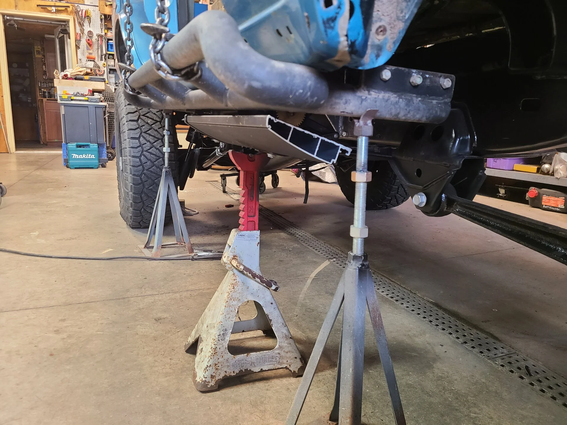

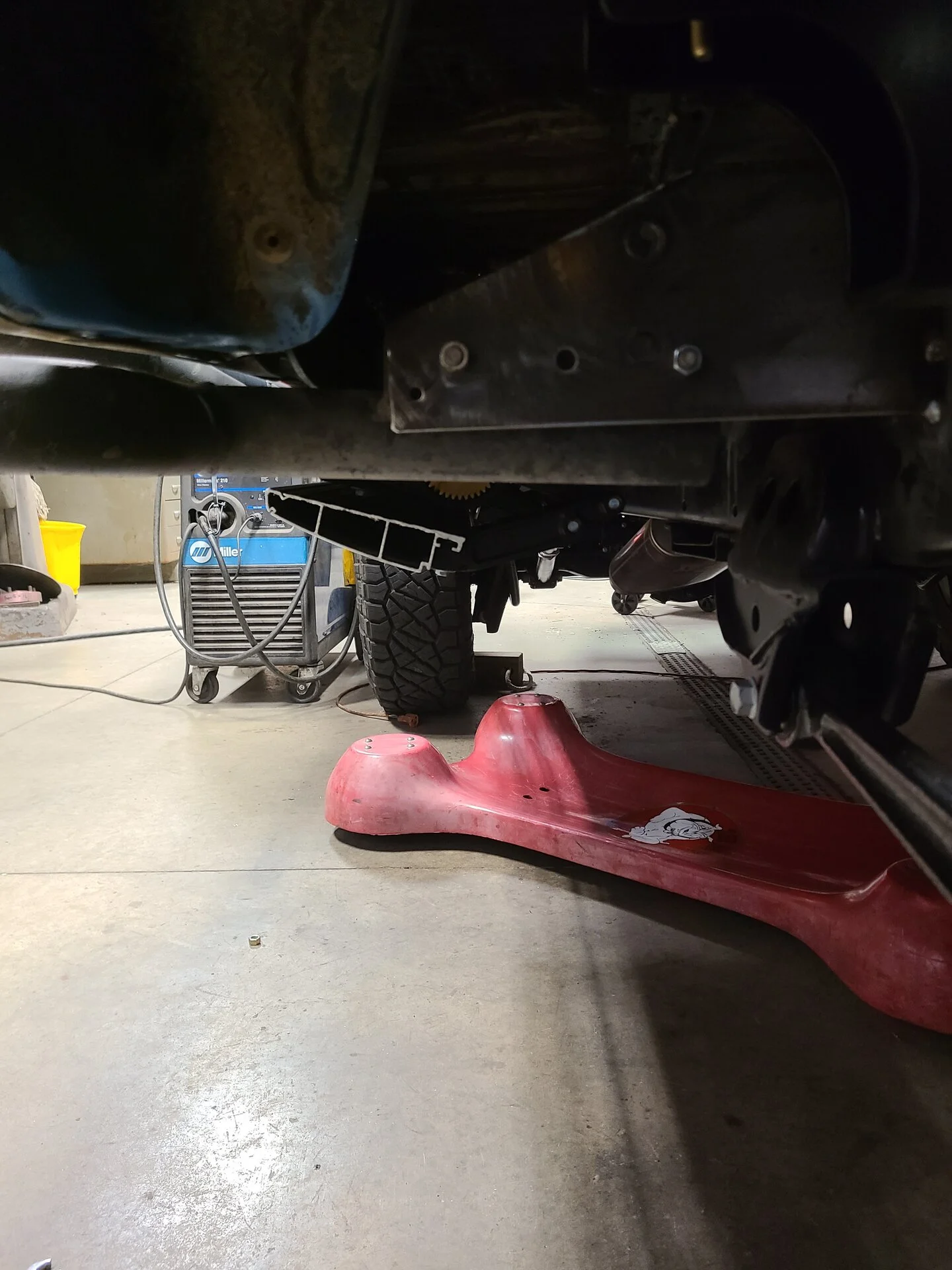

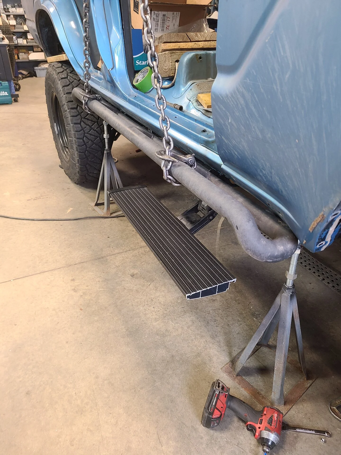

I think I see why they aren't offered for the 80 🤣
The rear portion of the frame flares out too wide, and there's no room for the mechanism. This is as far rearward as it will go.
I'm concerned at the amount of overhang at that rear door.

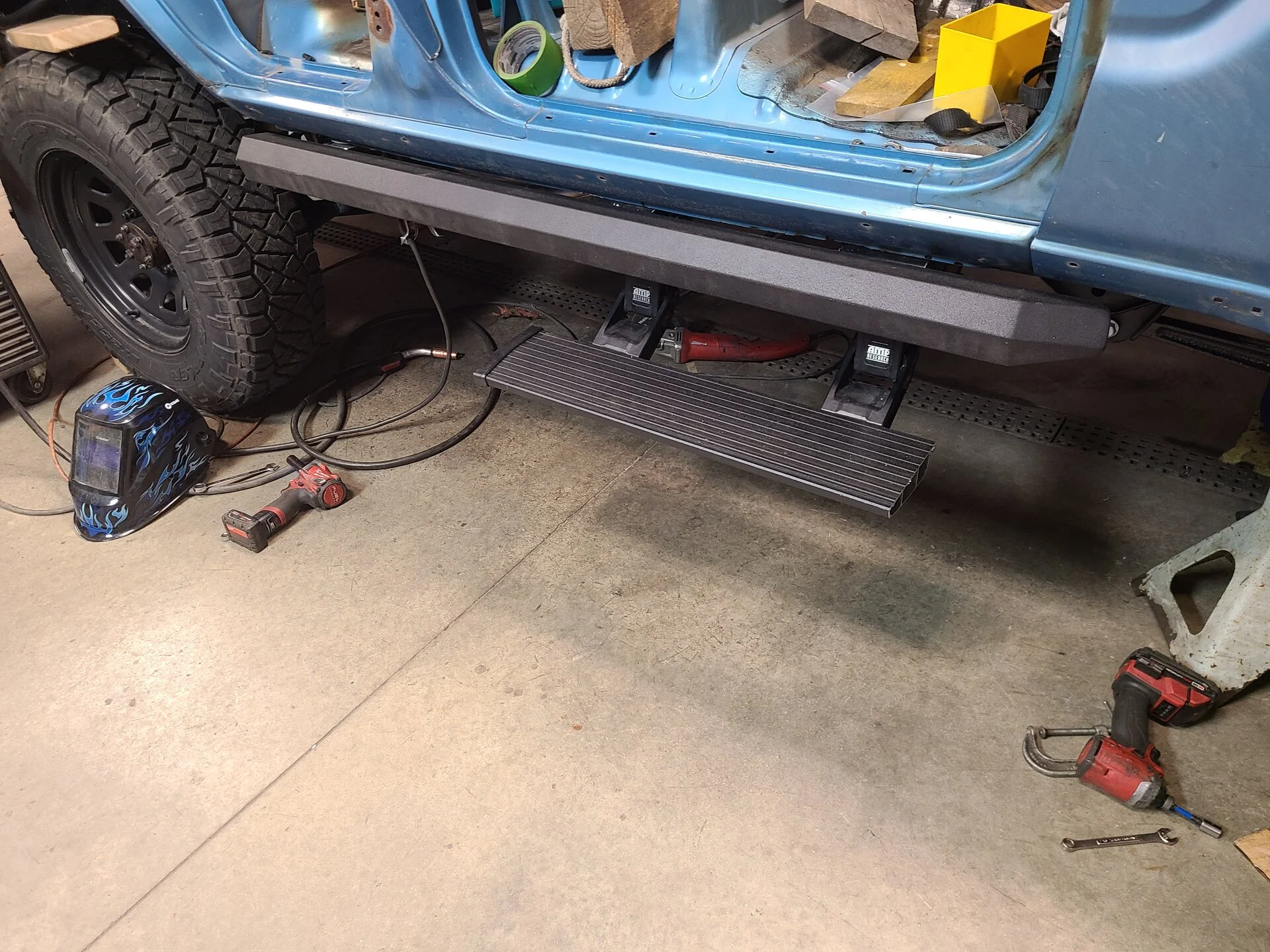

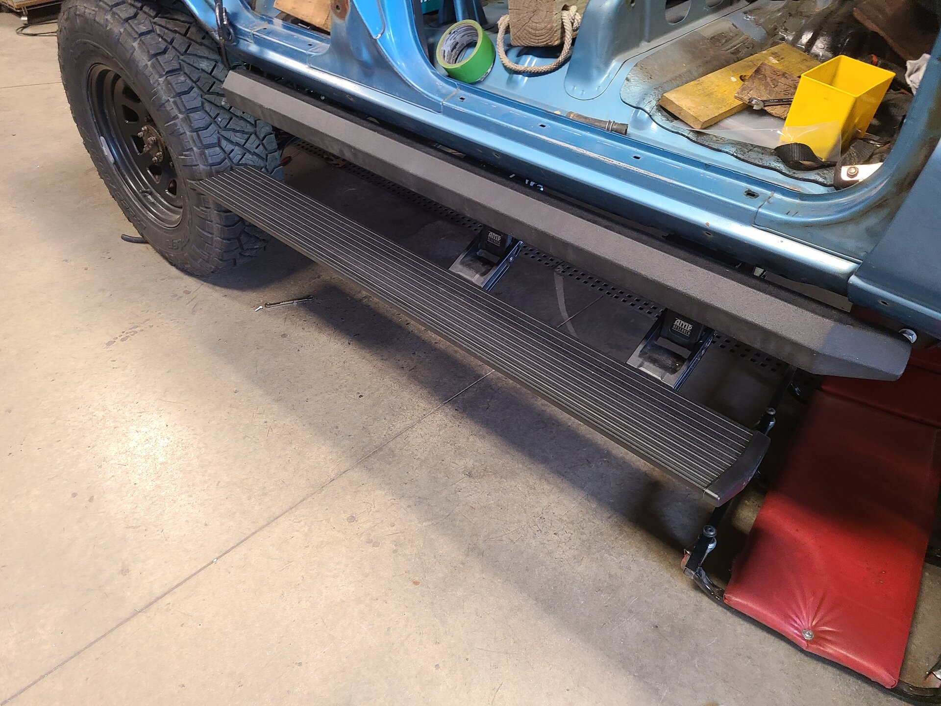

This option is getting back to my original thoughts.
Use the rock rails that were originally on the truck, and incorporate the motorized step.

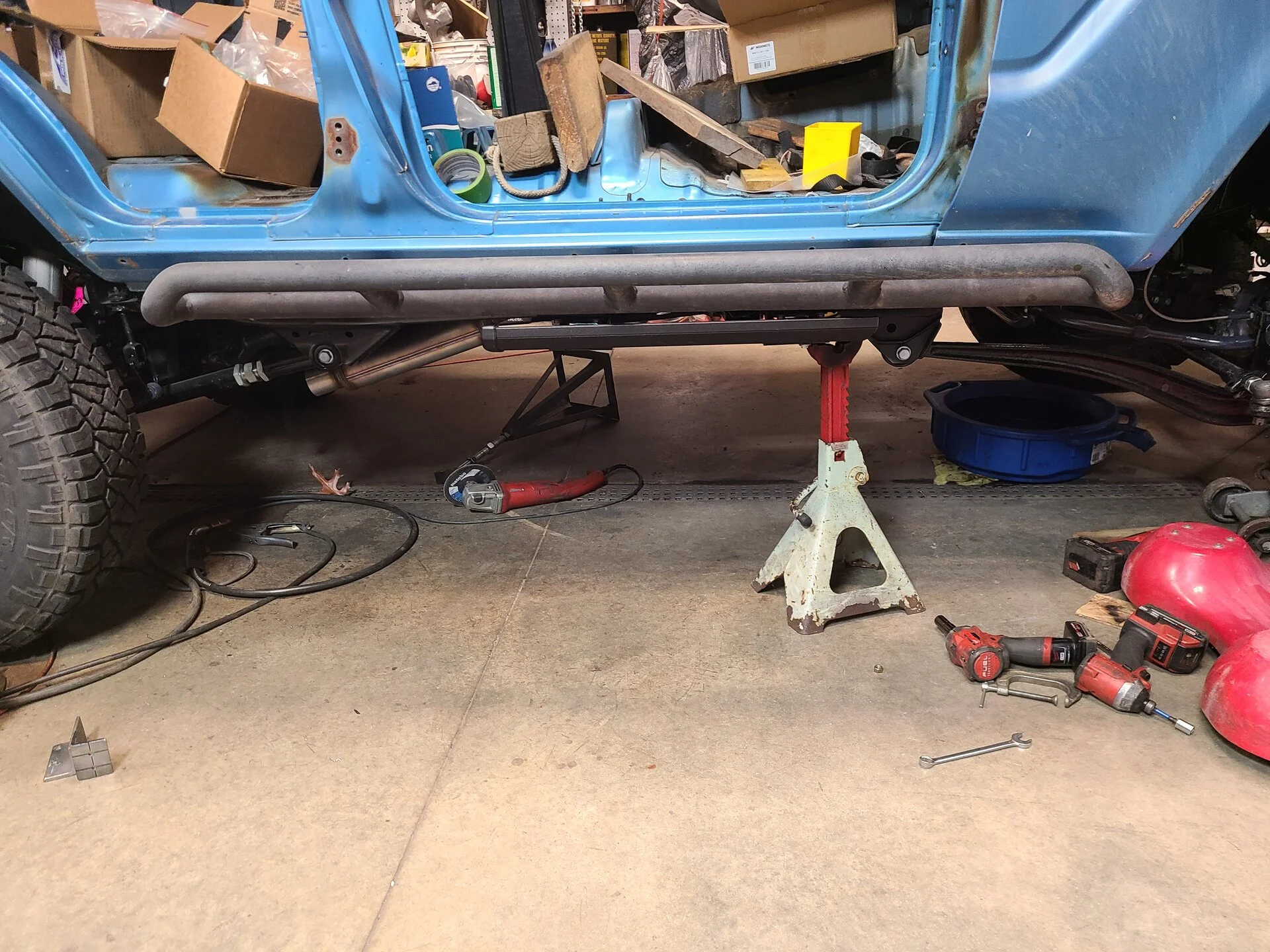

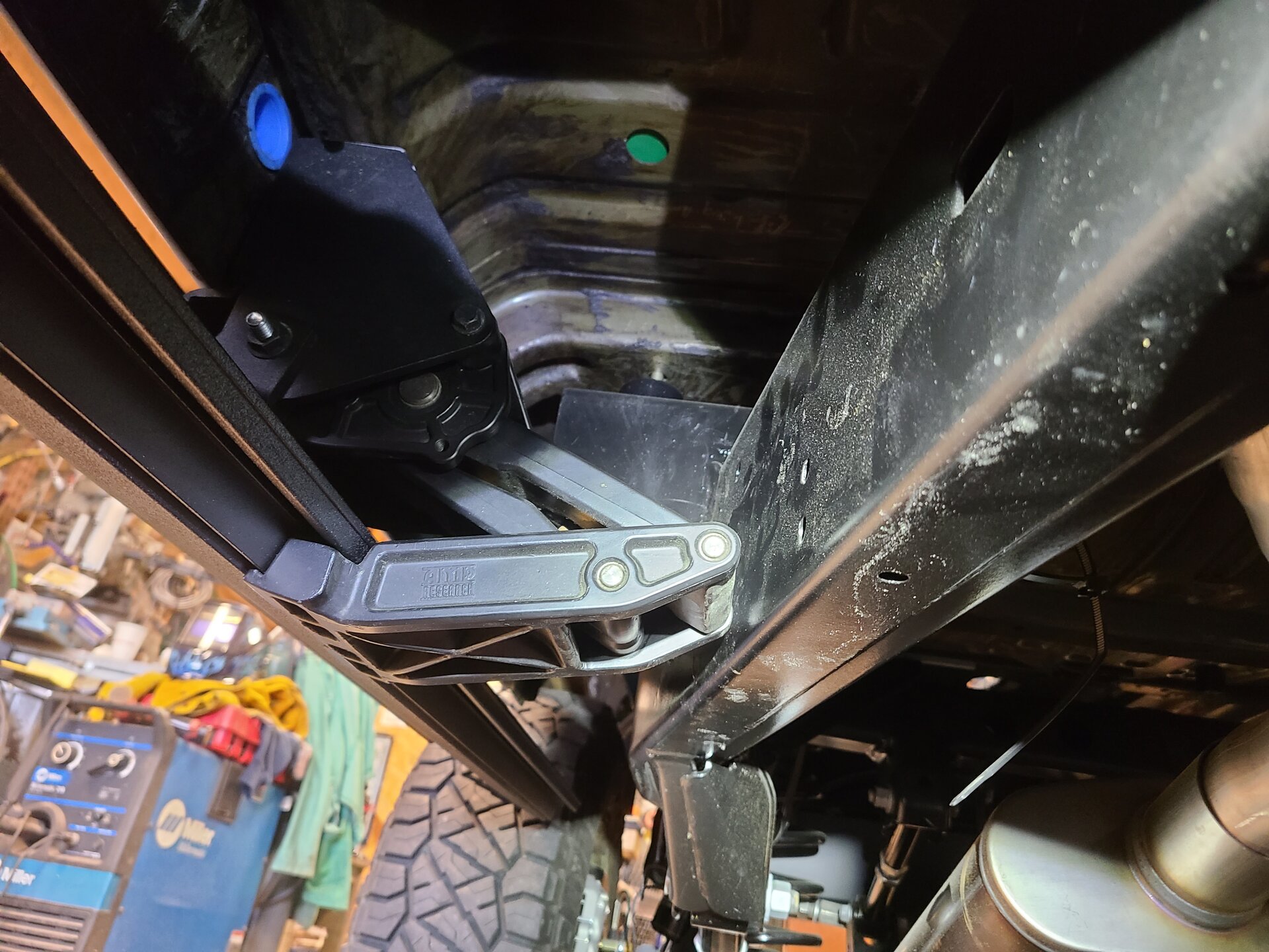

From below...

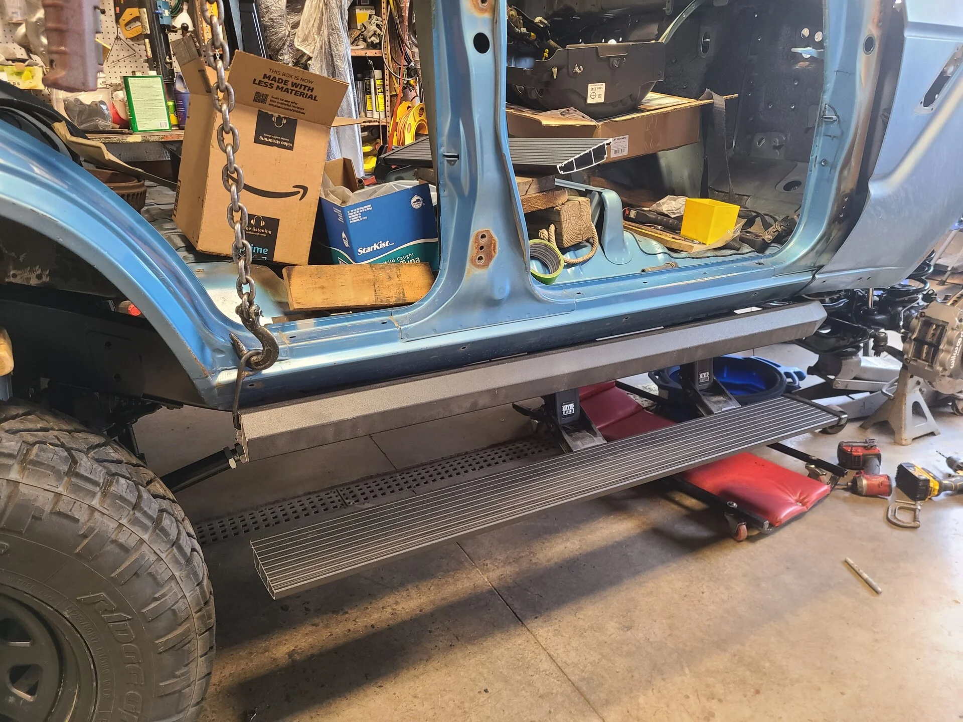

Final installation on the step will allow for the original Amp PowerstepXL rock rails for mall crawling with the jeeps.

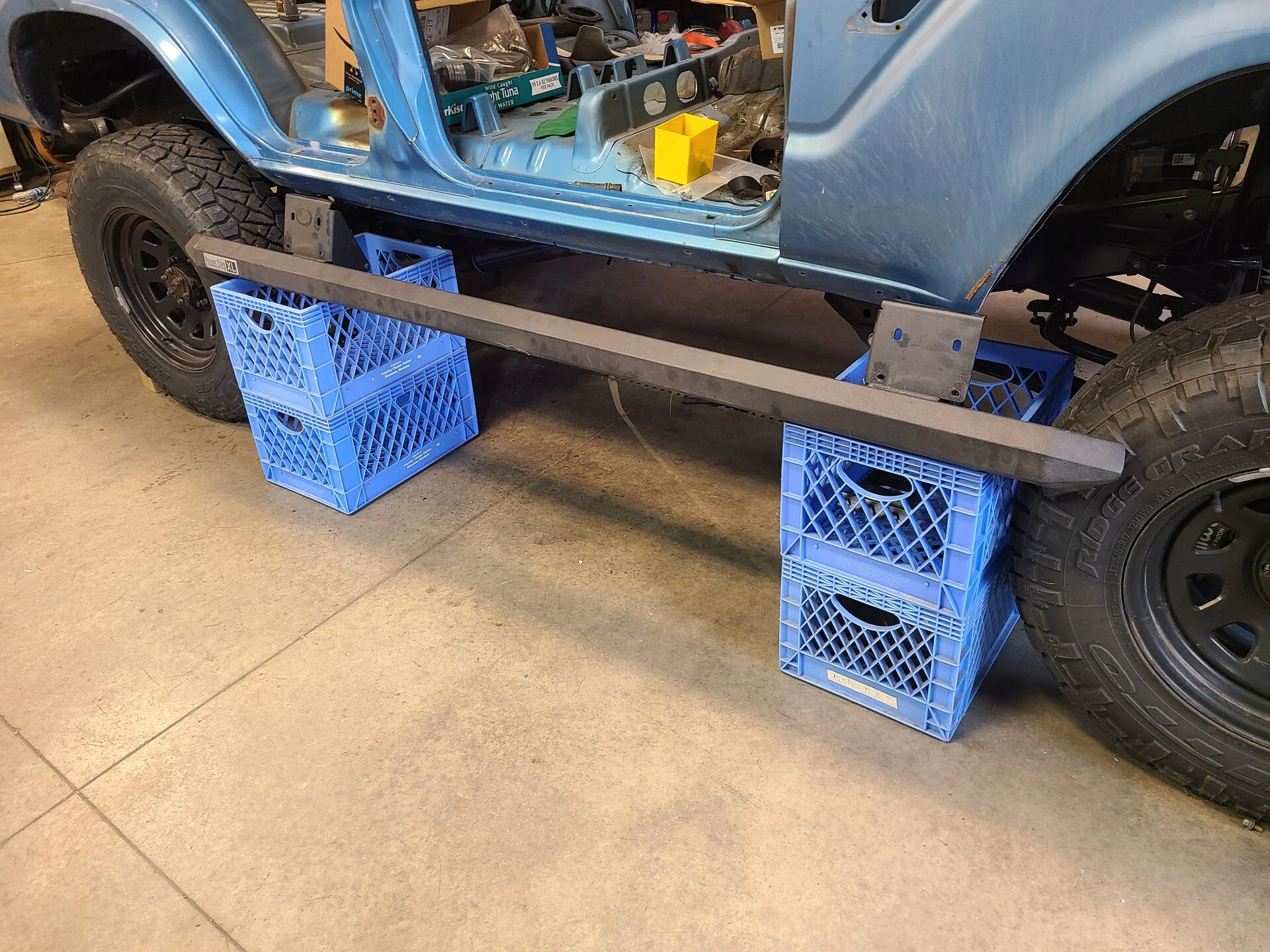

Or...
The real rock sliders for keeping up with the yota buggies. 🤣
I mean... if you ever do wind up using that rock slider, you'll have to walk back up the trail and pick up the pieces of the step. Still, I do prefer the look and I'd rather have the real slider if I ever needed it.
Yea, I will add a little bit more protection on the leading edge, at least, but you are on track. 👍
