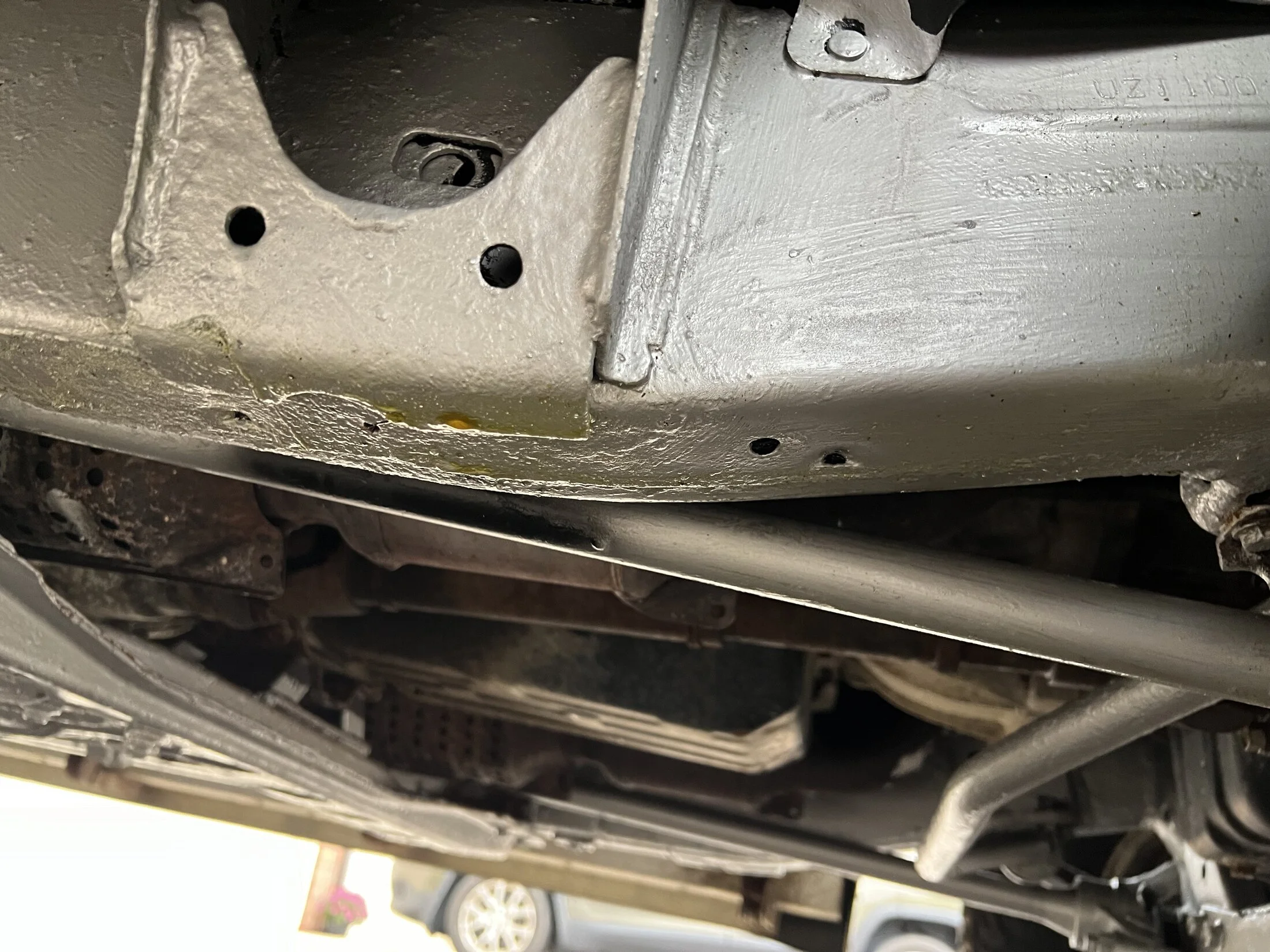

Hello,
Theres a yellow/green thin oil leaking from the passenger firewall area. I couldnt really find the source yet. It seemed pretty far down by the frame and ac lines. The brakes are working normally and the ac still blows pretty cold. Not sure what it is. Any help would be appreciated. Also the ahc was deleted but the lines are still there.
Yellowish green is usually AC oil/freon with dye. Ultra-violet light will confirm

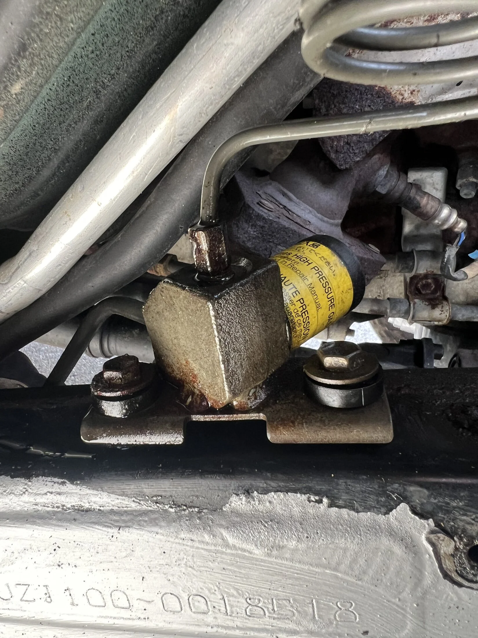

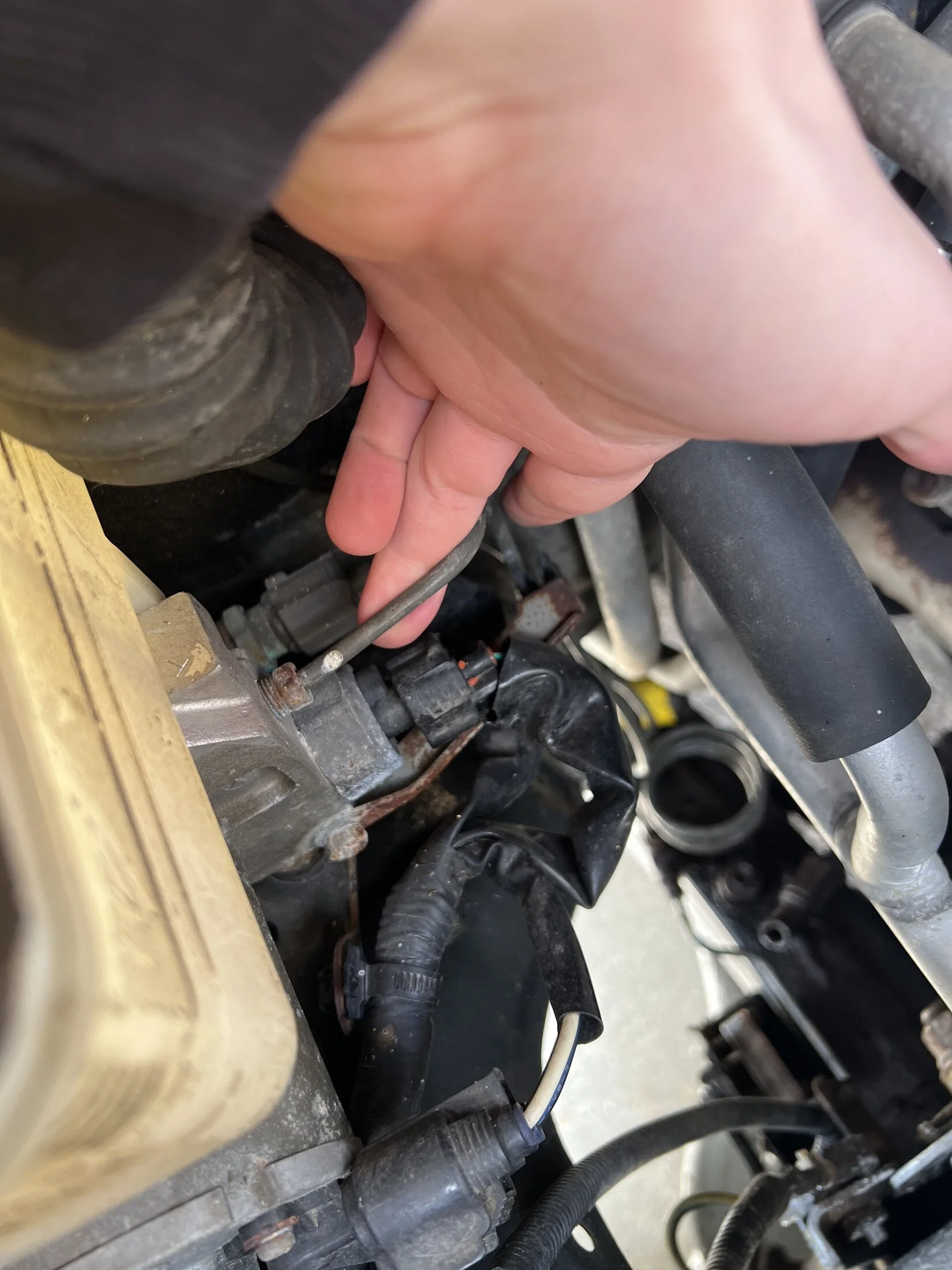

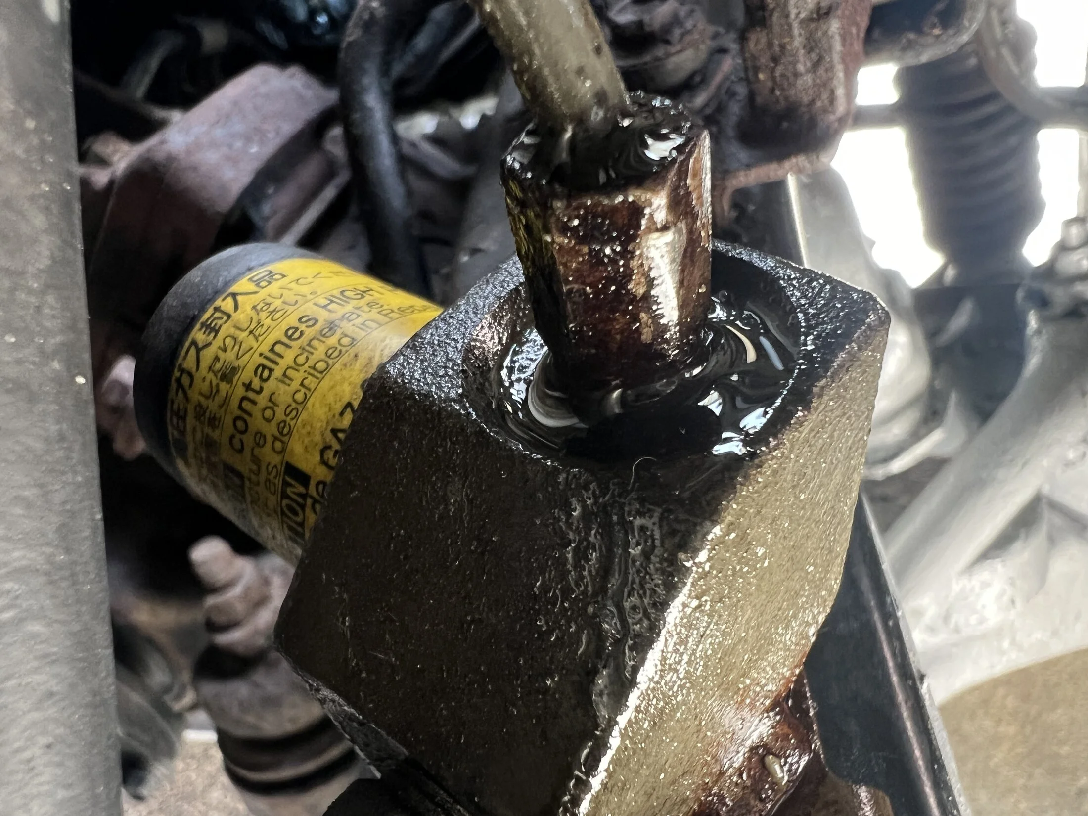

Found the source of the leak. The line comes from the ahc pump which isnt really connected anymore but might still have fluid. Should I just disconnect and drain the line since the ahc system was disconnected.
