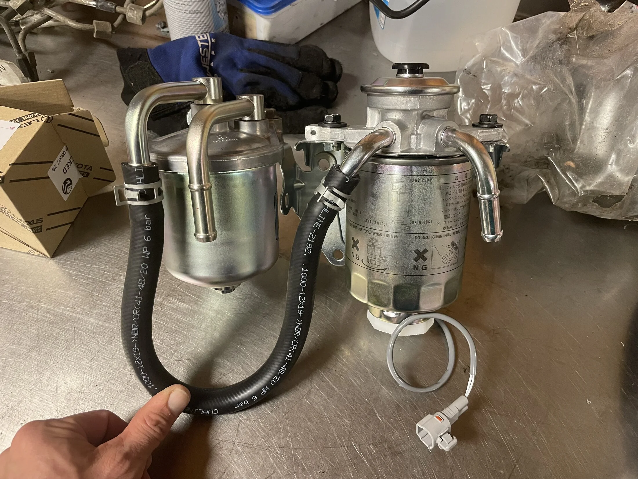

You might want to consider the HDJ79 dual in-line fuel filter set up. You can mount it wherever you want in the engine bay with a couple of rivnuts or a simple bracket.
