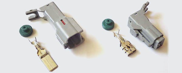

Now working on fuel. I've had trouble finding the 3-pos connector for the IP. It's available here, but $100 delivered seems insane. I will likely just wiring something up temporarily while I figure out another solution. Chinese vendors offer them at like $0.50/piece but you have to order 10 and wait like 30 days. Idk if people have other recs. The New Zealand harness burnt up in the fire, according to the PO.

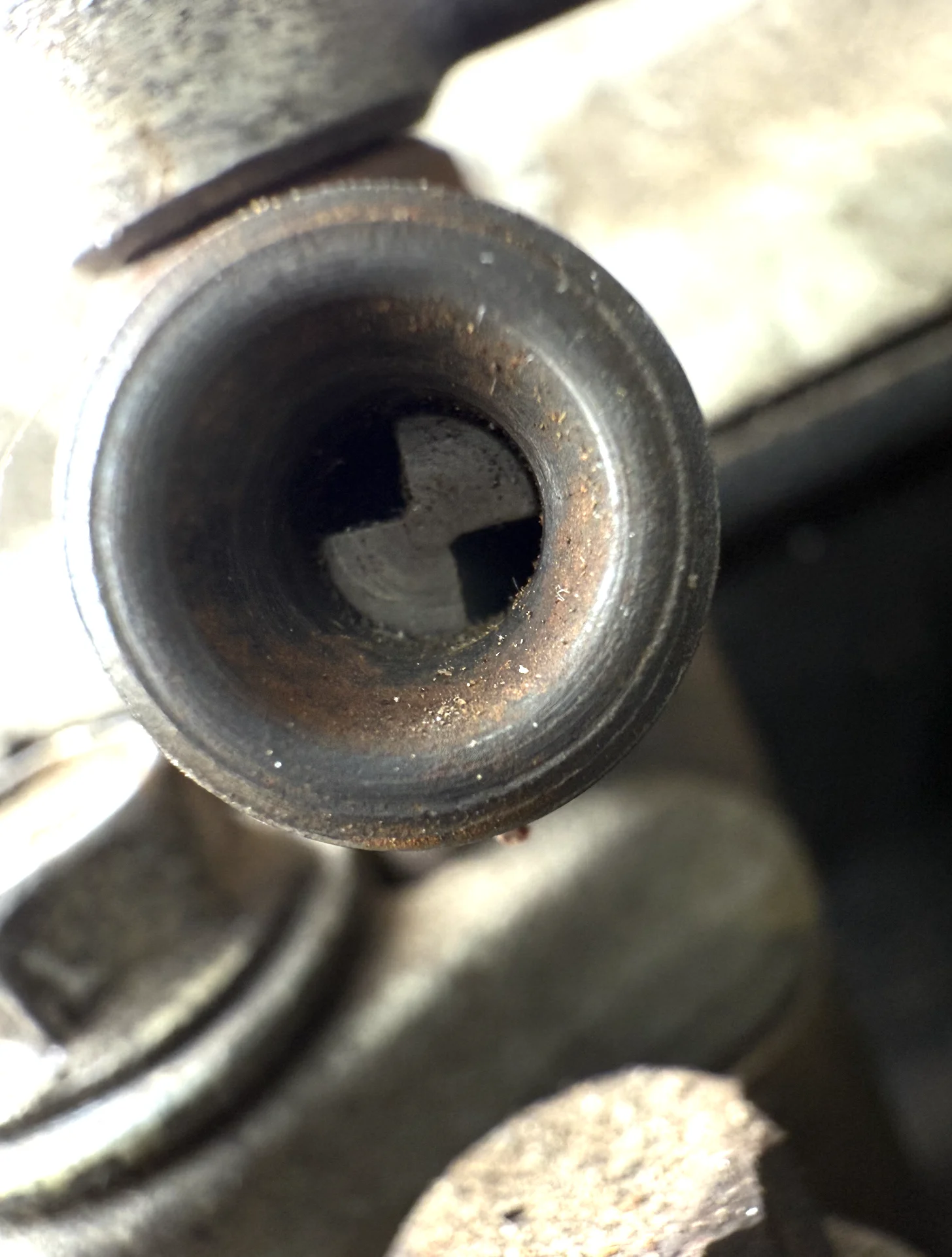

The injector inlets have sat uncovered for the last 8(?) years so there is some oxidation/dust that is visible. The "right" solution would be to pull the injectors and have them reverse flowed and cleaned and potentially rebuilt, but if that is the inevitable outcome regardless I wonder if I might as well see if it fires up before I spend another month waiting for injectors to come back.
I will rig something up with IV tubing and a shop vac such that I can pull out all of the accessible gunk.
Here's two sources for Sumitomo connectors that might have what you are looking for:
