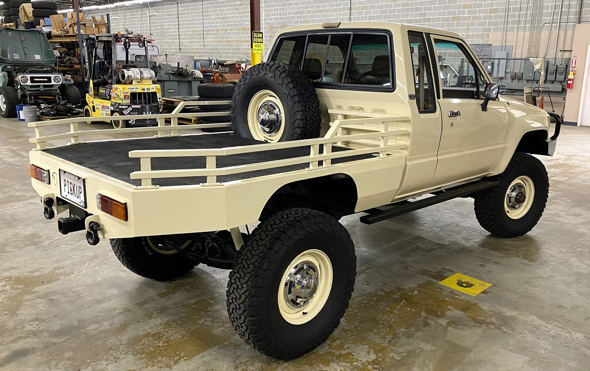

Say someone were to get this, would any US spec Toyota pick truck bed fit this LN107 Hilux if the entire fire truck box/bed were to be removed? Or would sourcing a specific bed fom overseas be necessary? Asking for a friend..
Where there’s a will theres a way.
I bet you could “make” a earlier tacoma or t100 bed work
You likely would have to relocate chassis mounts which would be easy enough.
Why not unbolt all the firefighting boxes, and have the sides fabbed up the matchthe rest of the bed?
The short answer is no. There were no crew cab trucks of that body style sold in the US.
By the way that truck was originally white. (045)
Well its mine. I'll start with cutting off what I can and then see how it looks/works. If its horrible may have to decide between having a tray built for it locally or sourcing a bed from the middle east or similar location.
And yes if i repaint its going back to 045
