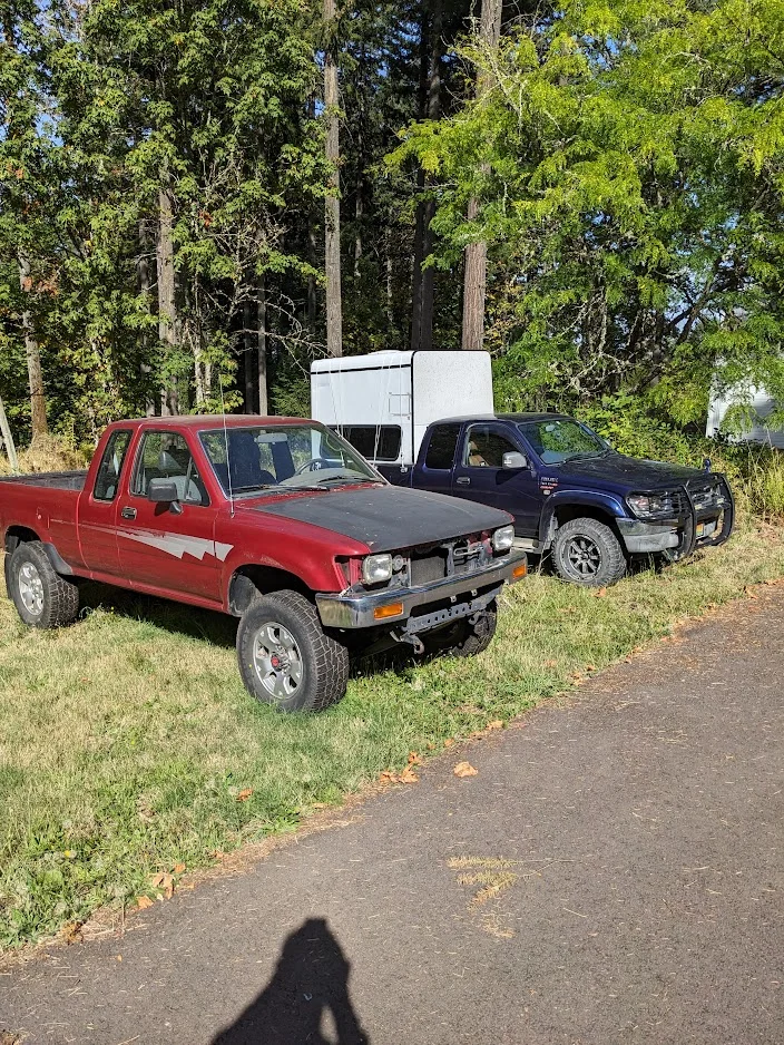

FWIW - I initially was thinking of selling the red US pickup and using the $ to start the build on the Hilux. I only paid $5600 for the red pickup 12 years ago, then added the Tacoma wheels/tires for $250 (IIRC) - so I don't have much into it. The engine is tired (240K miles) and the clutch is slipping badly (it wasn't when I bought it). But I decided I probably couldn't get much for it with the clutch bad, and that if I had the clutch replaced I could give it to my kids (who sorely need a second vehicle as a backup for their Audi SUV, and could use a pickup as a utility vehicle instead of asking to borrow mine).
I intend to keep that monstrous canopy and build upon it for camping/overlanding/etc., and eventually tow it behind my flatbed truck ('97 Ram 3500 4WD with Cummins & 12' flatbed cab chassis DRW) which I intend to also build upon.

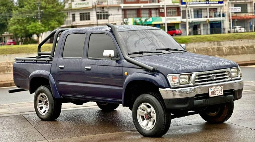

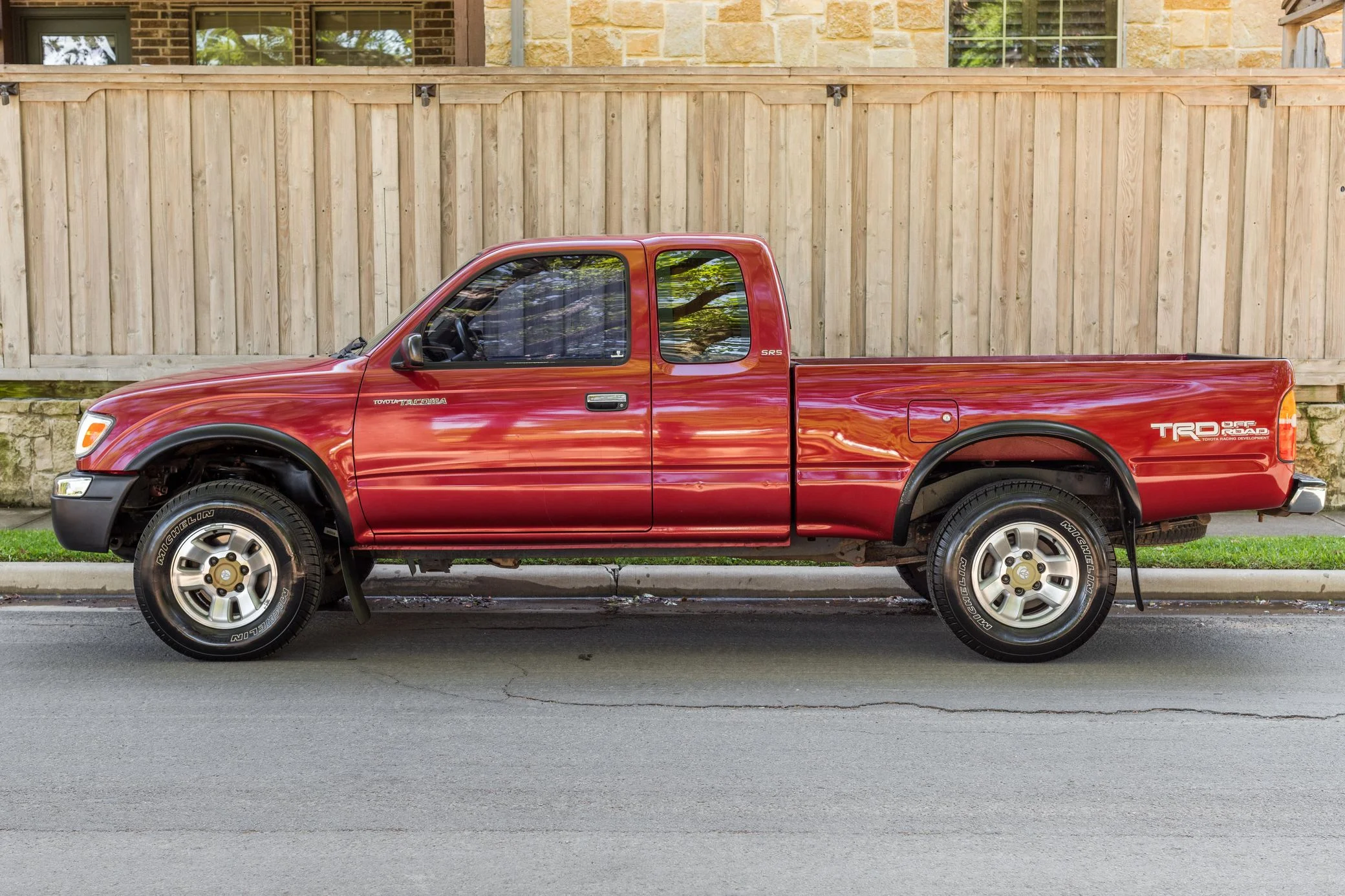

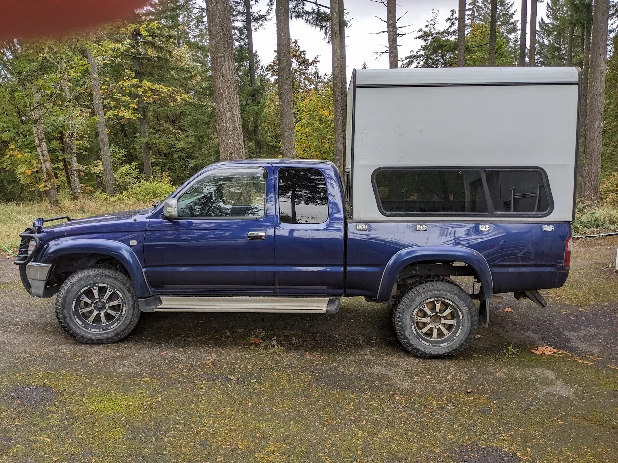

looking at the fender profile of your hilux, it looks like it shares lines with the early tacoma.
'98 Hilux:
'98 Tacoma:
Kinda hard to compare with the fender flares on the Hilux possibly changing the outline of wheel wells, plus mine has the grill guard which obscures some of the shape at the front of the front fenders. But the fenders of the Tacoma seem to have a more rounded shape, especially the front.
I intend to remove the running boards and replace them with rock sliders. I don't intend to do hard off-roading with the pickup - rather I would use a dirt bike or an ATV of some sort. However, I do want more protection for the pickup body, and I don't think the running boards provide that - I think they would just get torn off and possibly damage the rocker panels in the process.
subtle, but that cab is definitely a bit longer.
does it have a real bench in back or just the pad mounted to the cab back?
the front fenders and grille section i imagine would interchange. fender break line is definitely different. but note the door profile.
the fascia of that era here definitely look more like your 92. none of the plastic headlight bs and similar grille.
and why i mention the early taco vibe.
i assume you have the double glove box and no air bags?
The Hilux has two glove boxes on the passenger side, airbag in the steering wheel, but AFAIK not on the passenger side. I read somewhere that passenger airbag is an option for the Hilux. Mine also has ABS, A/C, electric windows and door locks. The window for the XCab portion has dark tint - not sure if that is stock or not.

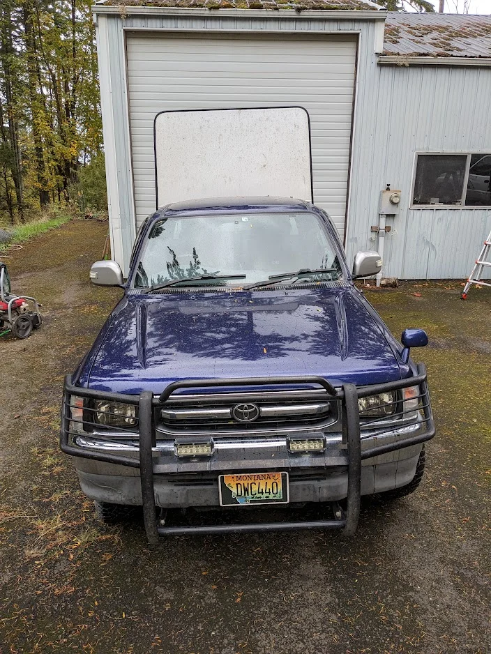

The front of the Hilux:
That guard will be coming off and I will replace it with a bumper that accommodates a winch and preferably a skid plate. Maybe an ARB or TrailGear bumper. The TG front bumpers also have an option for a hitch receiver. I would have either front bumper modified to be really stoutly attached; if I need to be recovered from being stuck I don't want the bumper yanked off, and I want to flat tow the pickup too.
The Montana plates will be replaced soon as OR DMV sends my new ones.

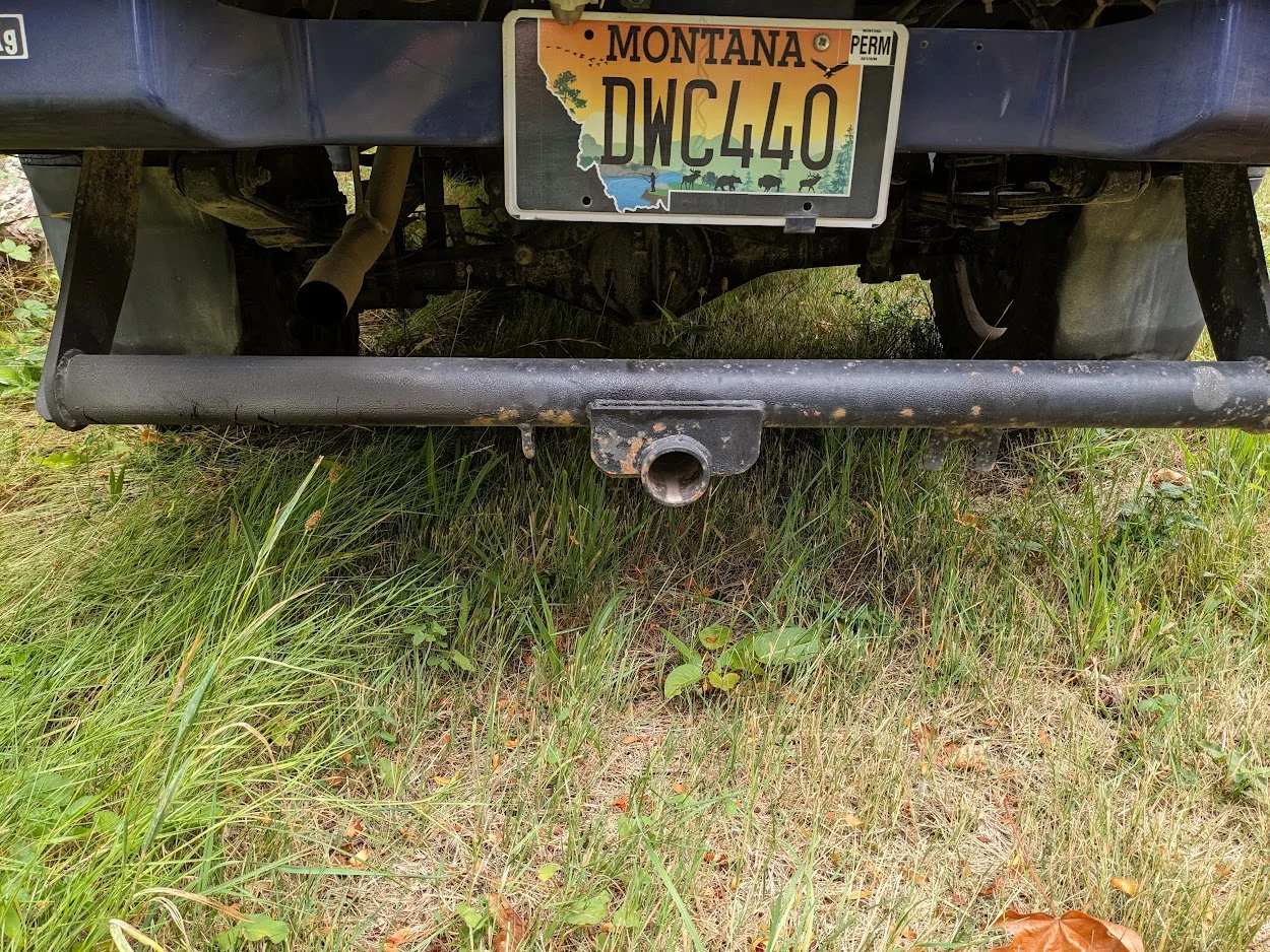

Rear has a weird hitch receiver which I can't find any info on, and I am going to R&R with something that has a better exit angle, and has a square receiver. Probably a bumper with a swing away spare tire carrier/etc., and really stout attachments for recovery.

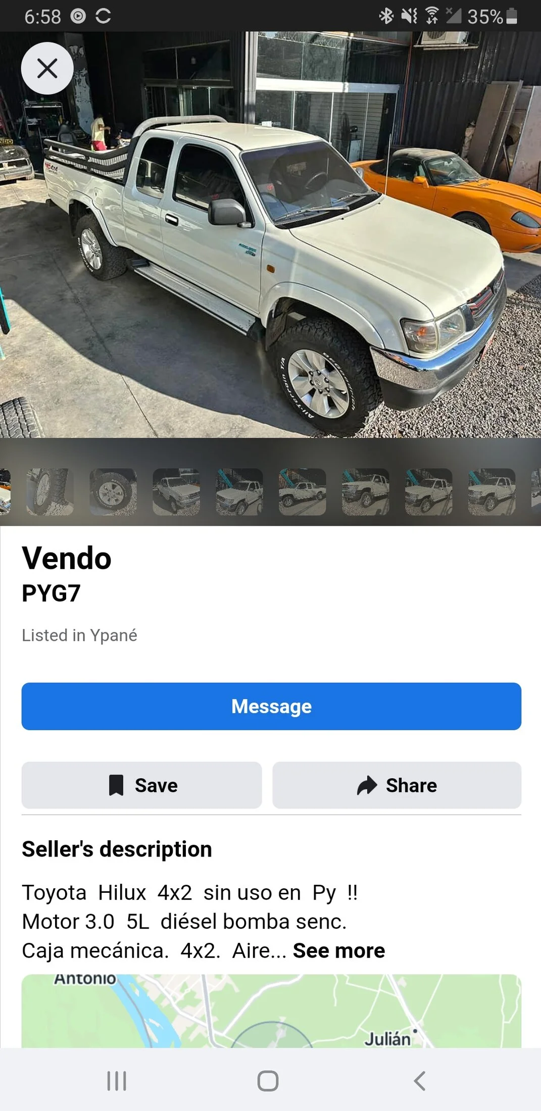

the xtra cab is not really a thing here. pretty much all dual cab.
Yeah, XCab is popular in the USA, not so much anywhere else.
Almost all of the Hilux PUs I saw for sale anywhere were dual cab, some regular cab, and XCabs were rare - I've only seen 2-3 for sale in the USA.
I absolutely wanted the XCab as all the dual cabs had a much shorter bed. I want to haul a dirt bike/ATV without having the tailgate down, and I want the canopy on and locked up if I am hauling a dirt bike (I don't want to temp any low lifes while parked in a city) - not sure I could get an ATV inside the canopy though. I am 6'6" tall, so the more space for sleeping inside the canopy the better. As far as I can tell, the wheelbase is the same for the dual cab and XCab.
