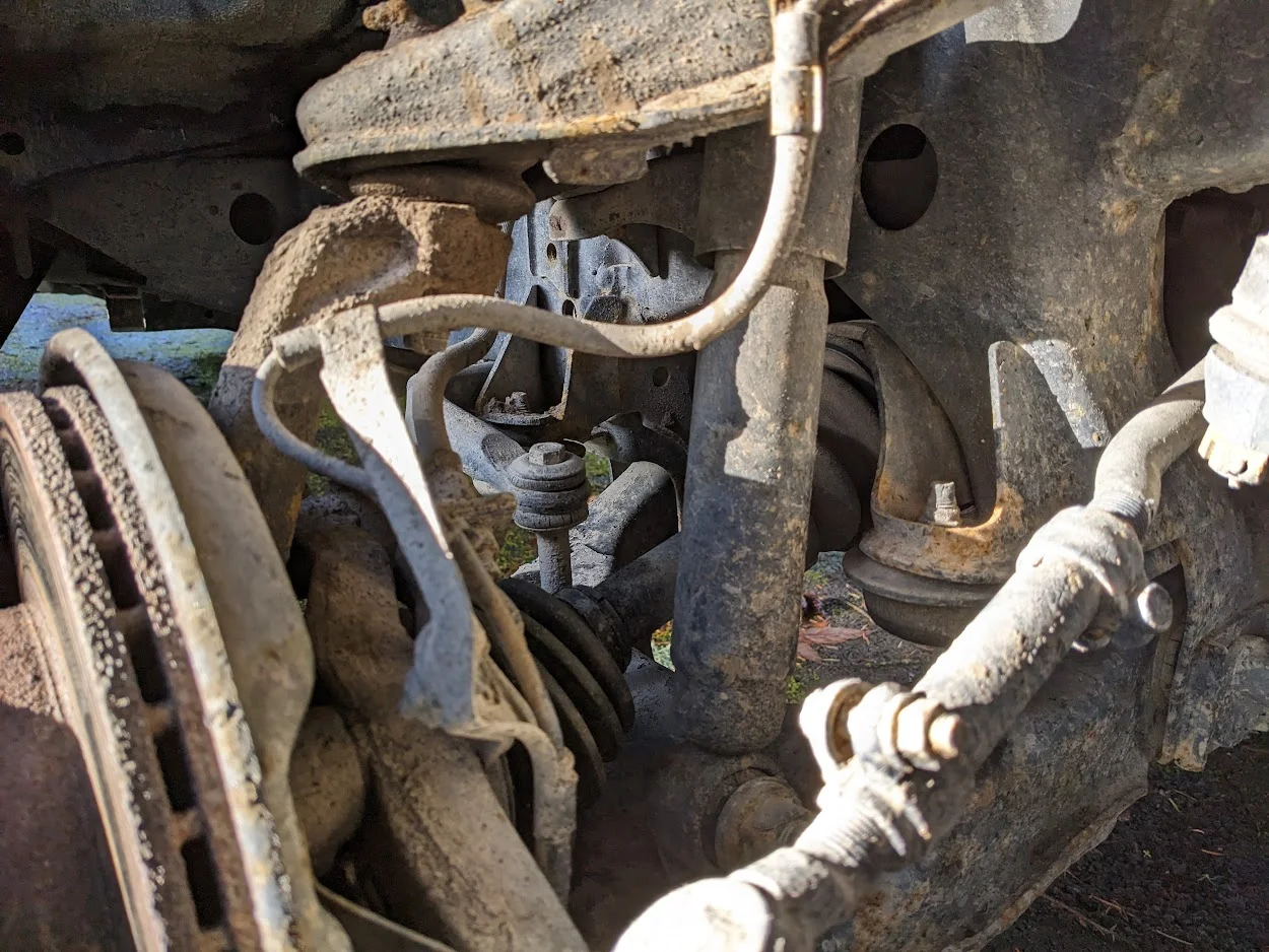

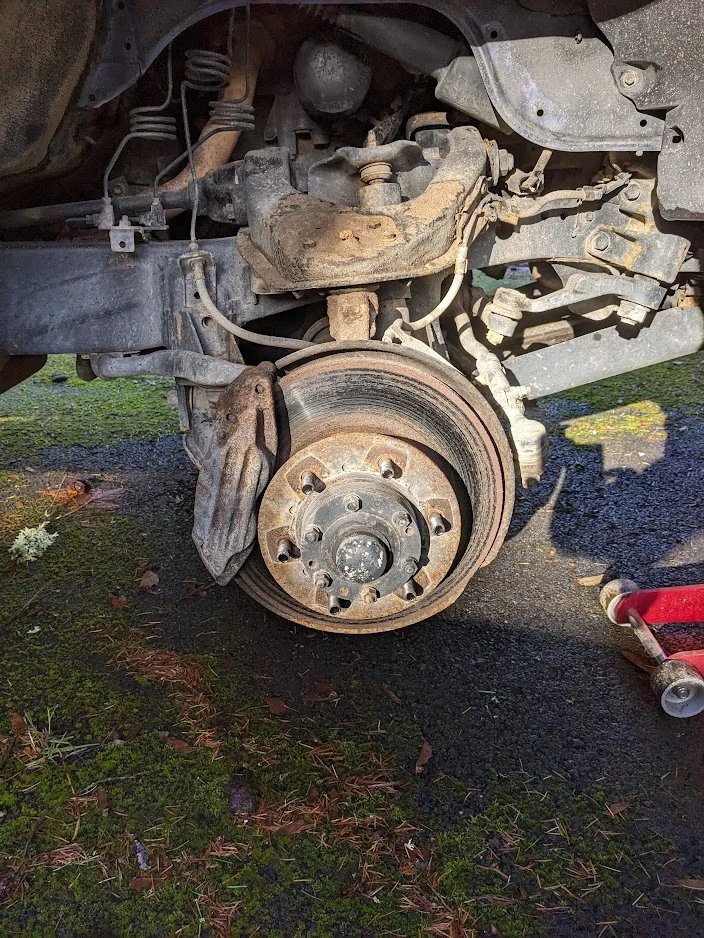

I was trying some wheels/tires (265/70-17) so I took some photos of the suspension:
I did not crawl under to confirm torsion bar, but I assume that because there are no coil or leaf springs, that there are torsion bars.
Wacky. Good to know
Just to clarify, I don't know that T100/4Runner parts fit, but if I had a Hilux here I would be looking closely at ToyoDiY and measuring to see what might be good substitutions. There is so much interchange between parts that I can't imagine some of the same era trucks wouldn't share components, especially in regards to brakes, suspension and running gear. As an example there are tons of little trim bits/parts that interchange between my 86 70 series land cruiser and my 99 Tacoma. And Corolla parts are a gold mine for little things that cross over.
these are the torsion bars.
i assume these parts interchange with the 86-95 mini/4runner stuff like we talked about already. you can verify part numbers and interchange using Toyodiy.com.
t100 stuff uses longer arms and axles because of the additional track width (66") vs (58" for torsion trucks)
