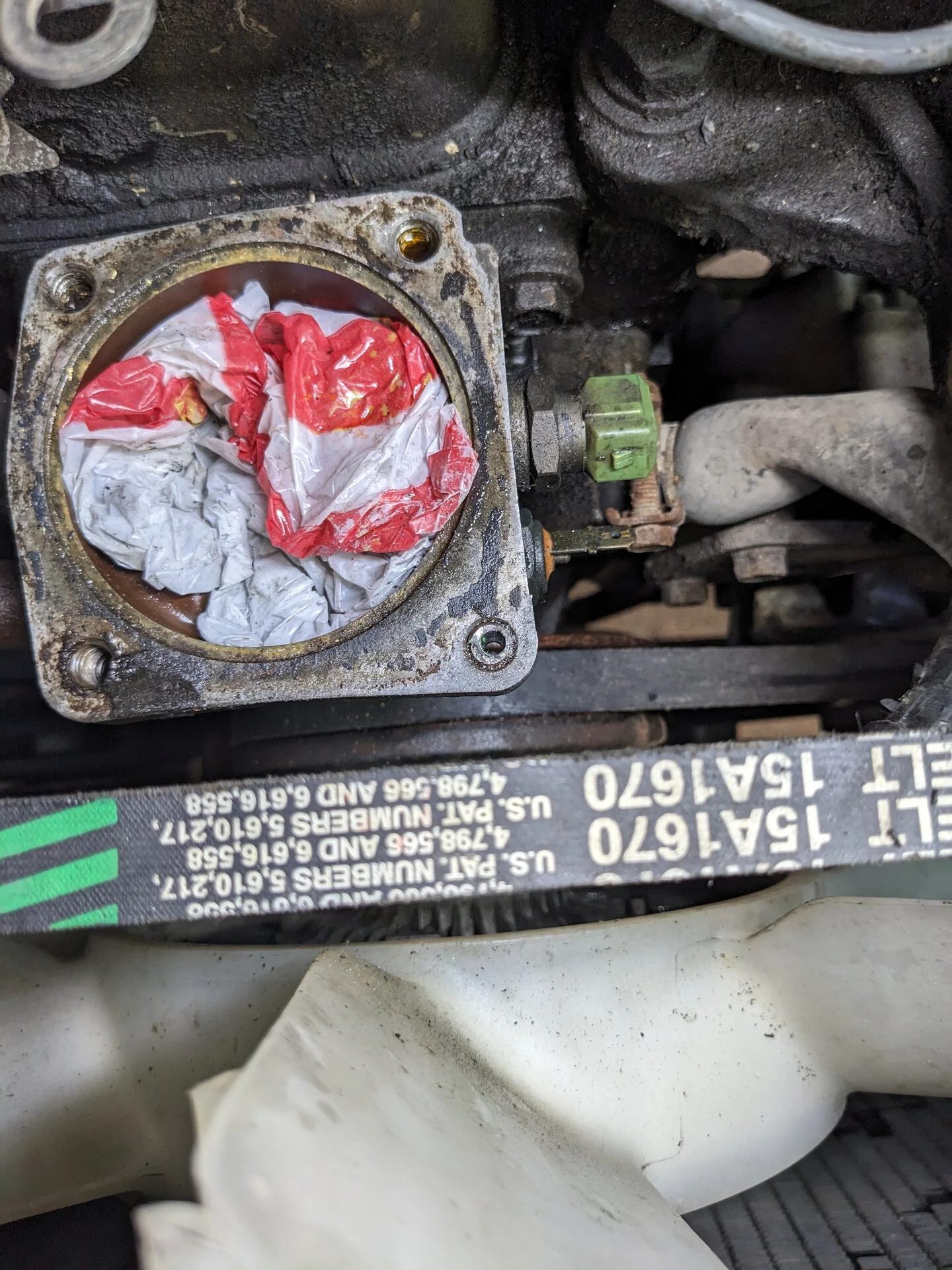

More important Land Cruiser repairs completed today:
It was cold out, I swear. I promise it's much longer when it's turned on.
