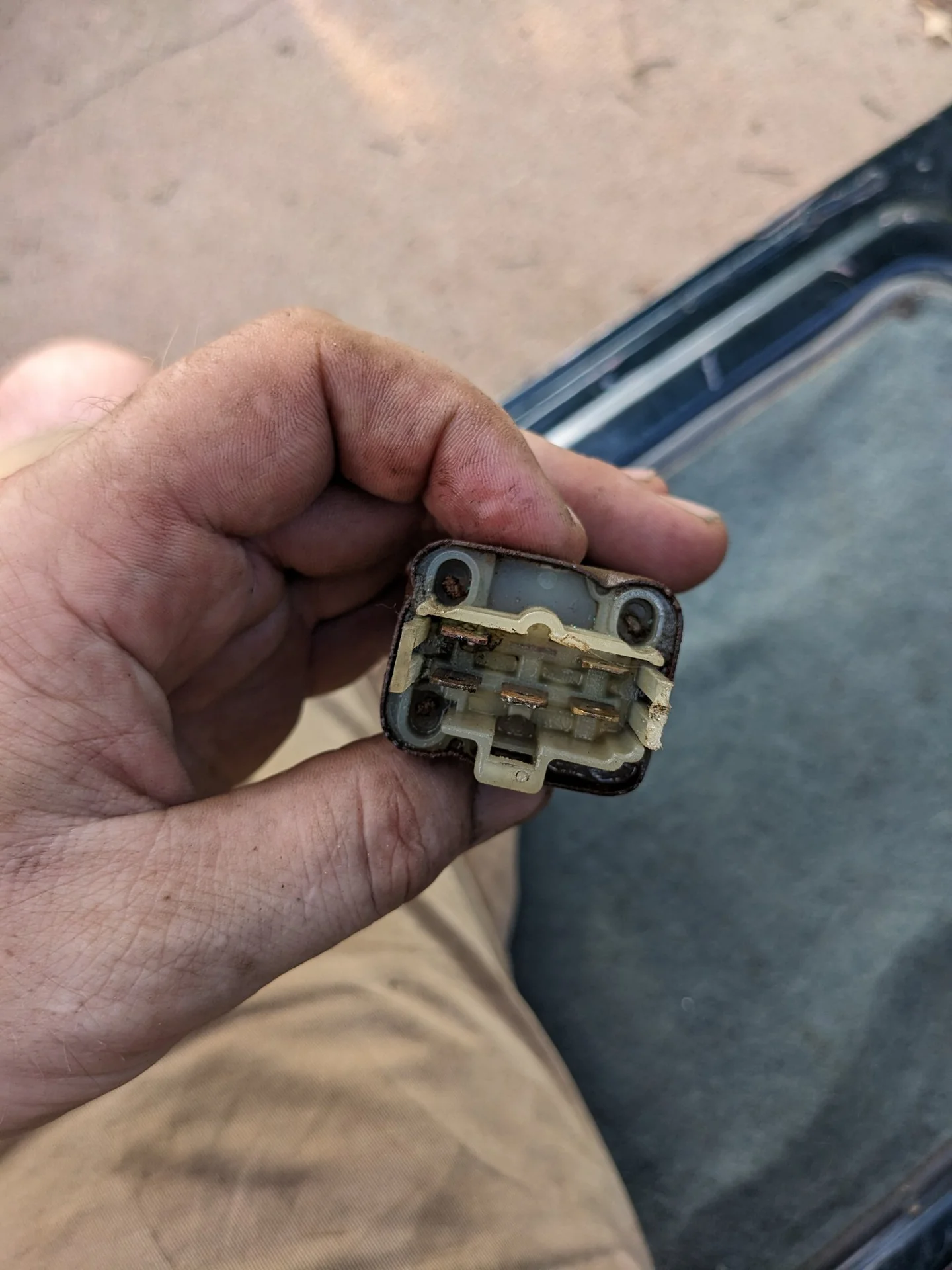

One of the spades on this relay busted off while trying to clean it. Already had the soldering kit out so I decided to try and solder it back in place. Mostly just to see if I could, I'm going to get a replacement for the relay, but at least I know I could if I'm in a pinch in the future.
