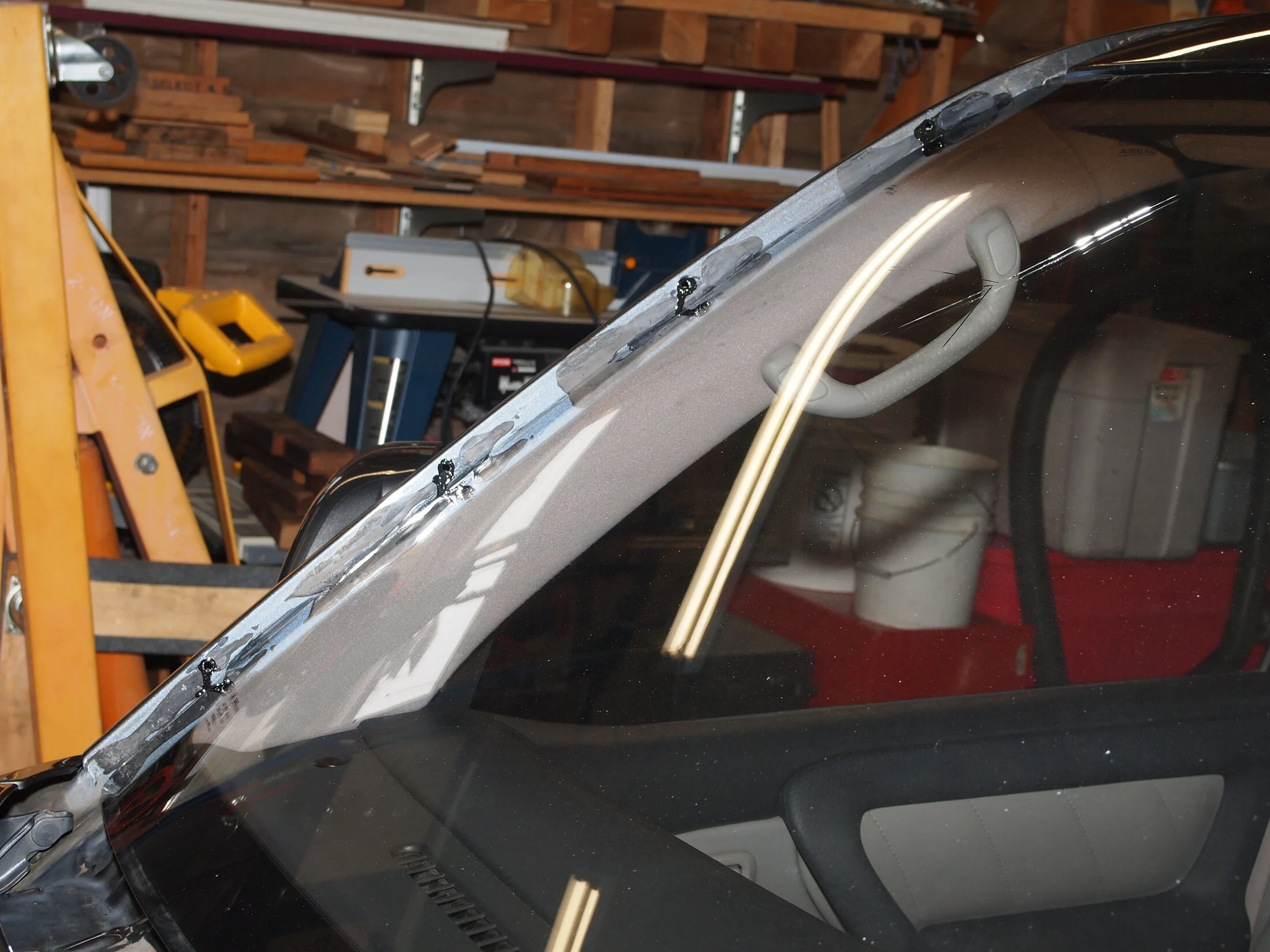

I recently tackled the rust surrounding my windshield and boy am I glad I did. After much grinding and painting the windshield and molding are in but I am having trouble with the three lower rivet holes on the drivers side moulding. They don't fit snug and keep popping out, but just those three holes. I am using Toyota oem rivets. My thought is the corrosion made the rivet hole just slightly too big. Any advice on what to do now? Should I look for a larger size rivet? Are there any other ideas to fasten and close the hole without using screws? Any advice is appreciated.

I recently installed the garnish on my windshield and had the same issue. Ended up using a standard aluminum rivet slightly bigger with black rtv dabbed in the hole and rivet end. It really depends on how much larger the hole is now and the overall condition of that channel along the windshield. The idea is to have something preventing aluminum rivet contact with steel, being dissimilar metals and all. Personally, if I were to do it over, I think rivnuts installed properly would be a rock solid long term solution.

Thanks for the suggestions everyone. Just ordered some 4mm rivets so wish me luck.

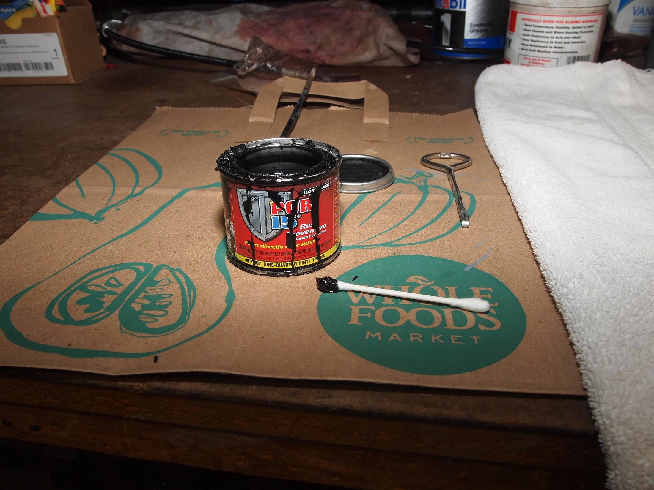

Paint hole with POR-15. Built up layers. Go up to 3 to 5 layers max. If you judges hole to large, get next size up rivet. Windshield installers often varois size aluminum plastic coated rivets, they'll give you. 90269-05034 Windshield rivets (over sized)
