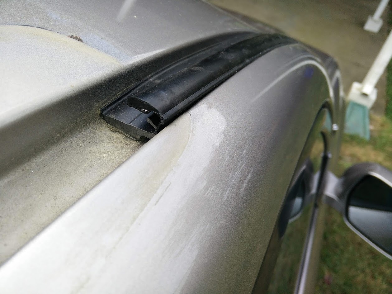

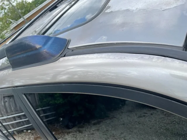

75533-60060 - "With sunroof, front, with luggage carrier. Outside #1, with luggage carrier."
75533-60031 - "With sunroof, front, without luggage carrier. Outside #1, without luggage carrier."
"With luggage carrier" is shorter and the foot of the roof rack covers the gap. "Without luggage carrier" is longer and will cover the gap if you don't have a roof rack. Functionally the same, aesthetically different. I don't have a roof rack and there is a gap between the moulding and the rails on top. It looks a little weird, but doesn't cause any leaks or anything. I am unsure if using the longer moulding and a roof rack would cause any interference issues.
