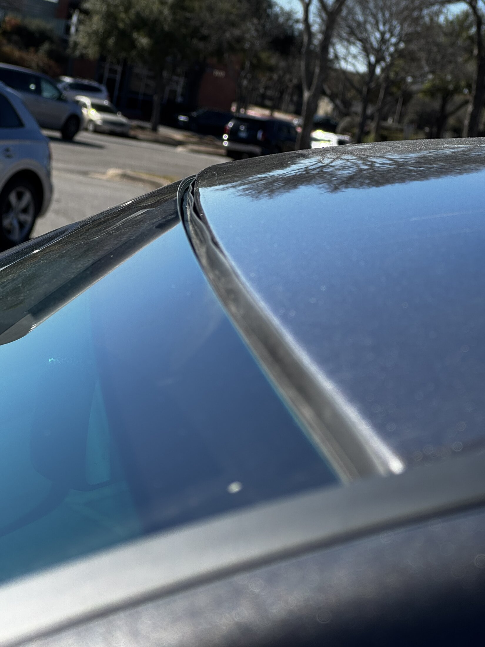

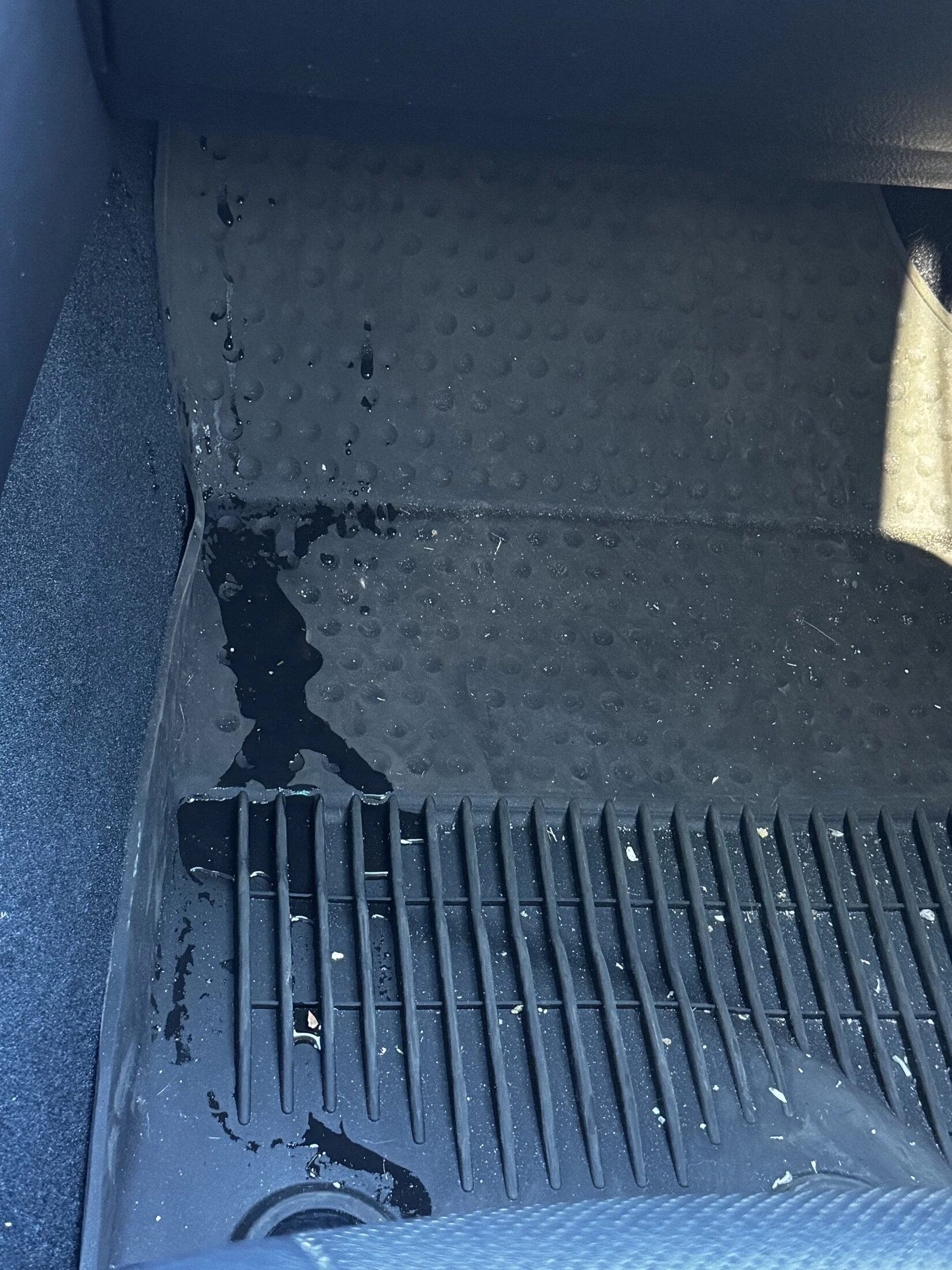

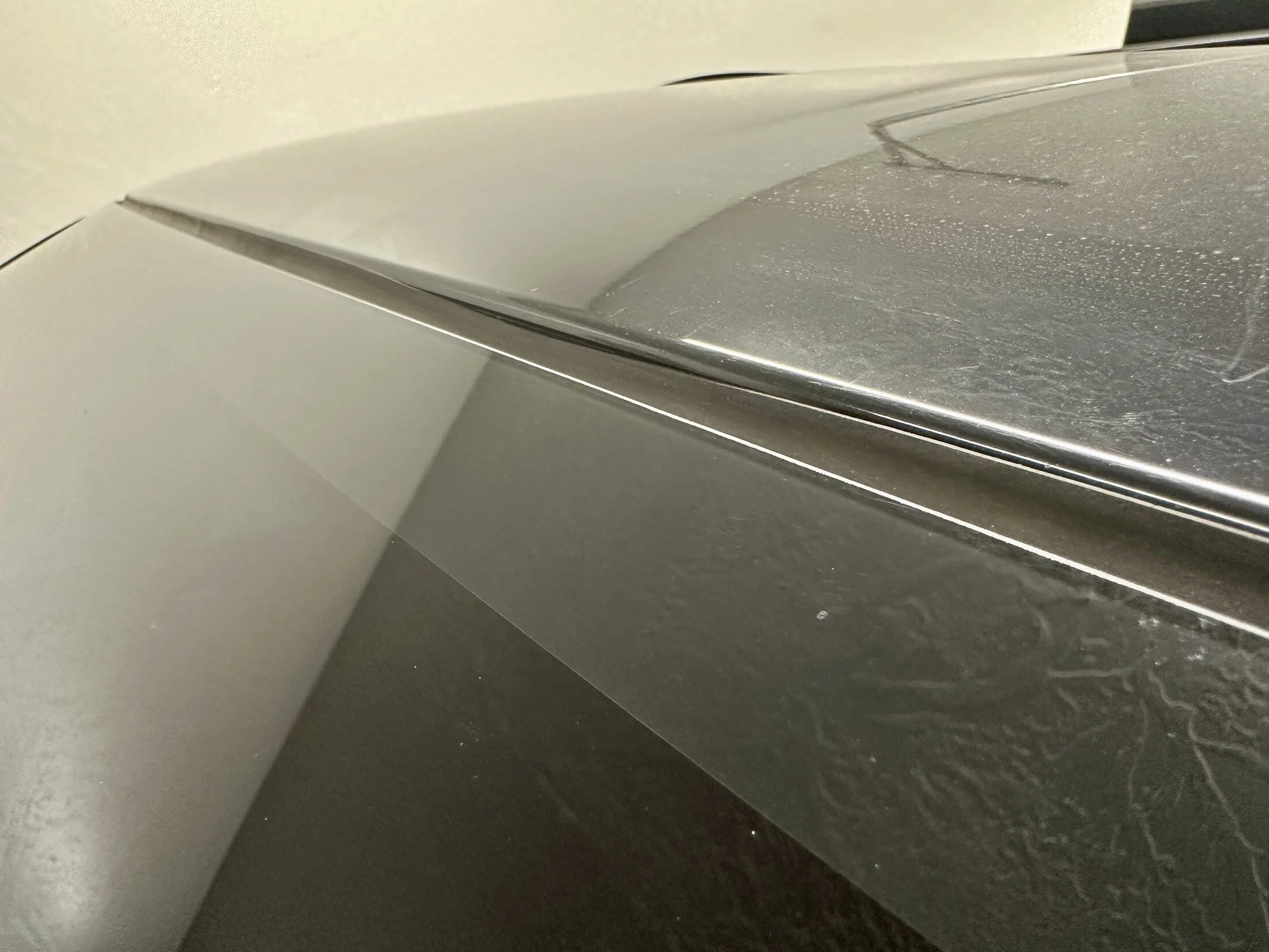

I recently replaced the windshield on my 200 Series based on recommendations from this forum, using a 3rd party company Lexus of Austin referred me to (which I won’t name yet). After installation, I noticed the seal at the top was very wavy and made a lot of wind noise above 60 mph. Additionally, the windshield seems loose, causing creaking sounds that weren’t there before.
I contacted the installer at the company, and he agreed to reset the windshield. However, the technician sent to fix it cracked the windshield while removing the side moldings. Now, I have to wait up to a week and a half out for another replacement.
Four days later, after a car wash (today), I found a puddle of water in the passenger footwell. The installer seemed experienced with this model but clearly made some errors.
Before they attempt a third replacement, I want to know if this water could cause corrosion or damage to electronics under the footwell and how best to dry it out. Any advice would be greatly appreciated. To say I am currently frustrated is an understatement.

the video on this link post#8 is an extensive step by step of what a comprehensive and professional installation looks like on an lx570 (if memory serves me, also a new cowl replacement which was a source of passenger footwell leaks on my lc).
I appreciate this. I’ll definitely review this against mine.
as he describes in the video, a big problem on the cowl is that an inexperienced tech will break the little molded plastic tabs and then it won't fit tightly which is important for keeping out water. it's also an expensive part, some try to just reuse but i replaced mine since a couple of the tabs were broken and the foam had gotten old dry rot in places (10 year old truck).
seems that you have moulding trim problems too which may be causing leaks as well.
good luck and let us know how it goes.
Thank you for posting. I live in Georgetown with a 2015 LC200 that has a cracked windshield. I haven’t done the research yet but will need to replace it sooner rather than later. I am extra ticked off because I have Xpel UV tint that will now need to be replaced as well.
For the water, pull the door sill trim and vacuum out anything sitting under it, where the wiring harness lays. If you get it out relatively soon you shouldn't have any corrosion issues.

Hey @mbdtex and anyone else that can chime in,
Did you ever get the issue with the top seal resolved?
I just had my windshield replaced and the top seal isn’t as bad as your picture but I’m a bit concerned. The seal on mine isn’t lining up against the roof all the way across. There are small gaps between the seal and paint in spots.
I wish I would have inspected the seal before I had the windshield replaced. Did it sit perfect before? Or am I just noticing now that it doesn’t and freaking out for no reason?
If anyone else can check their seal and report back, that would be awesome. Thanks!
Did they reuse the top seal? I'm pretty sure that is something that should be replaced when new glass is installed.
It's attached to the back side of the windshield panel.. seems like reusing it would be difficult if not impossible.
@LC801 that looks unacceptable to me. The point of the seal isn't as much for water, the urethane will handle that. It's more to keep salt, leaves and dirt from getting into the gap then decomposing, which creates acidic compounds and leads to corrosion of the metal. Personally I'd try to get them to fix it with a new part.
That said, when I got my rig they used a totally incorrect trim and I pulled it out, leaving a solid 1/4" gap across the top. No corrosion. I don't live near salt though, and it was arguably easier to keep it clean.
Thanks for the input guys.
It’s OEM glass so I’d assume the seal was new too? That’s a good question though. I wouldn’t put it past any shop to do something weird like trying to reuse the seal.
What I’m dreading is asking them to fix the seal and then finding out in order to do so they have to pull the glass off again. This will only increase the chances of them messing something else up. Having said that, I do live in Salt Lake City and in the winter I’m driving on some salty roads so yeah,I would like to keep the salt out of there.
I don't see how they'd install a new seal without pulling the panel. The seal has an adhesive strip on it that is designed to stick to the interior-side of the windshield.
Yeah 😕 …sigh…

Hey, so the same guy replaced the windshield but with a “Toyota” branded windshield. I’m not sure if it’s because it’s Toyota branded or not but the top seal of mine is perfectly flush now without any ridges. For reference the first windshield the tech installed was about $450, the Toyota brand was $950.
However, it did not fix the leak in the passenger footwell. For that I ordered a new cowl and replaced it myself, took about 5min to do (super easy!). Once I did that the leak went away. I tested it by letting it rain on the car in a torrential downpour, letting a hose run from back to from on the roof, and taking it through a car wash. I am confident in the ability of the windshield once more.

-if you see a leak in your passenger footwell you’ll have to replace the cowl under the windshield. Part # 55708-60091 ($344) easy to replace, under 5min
