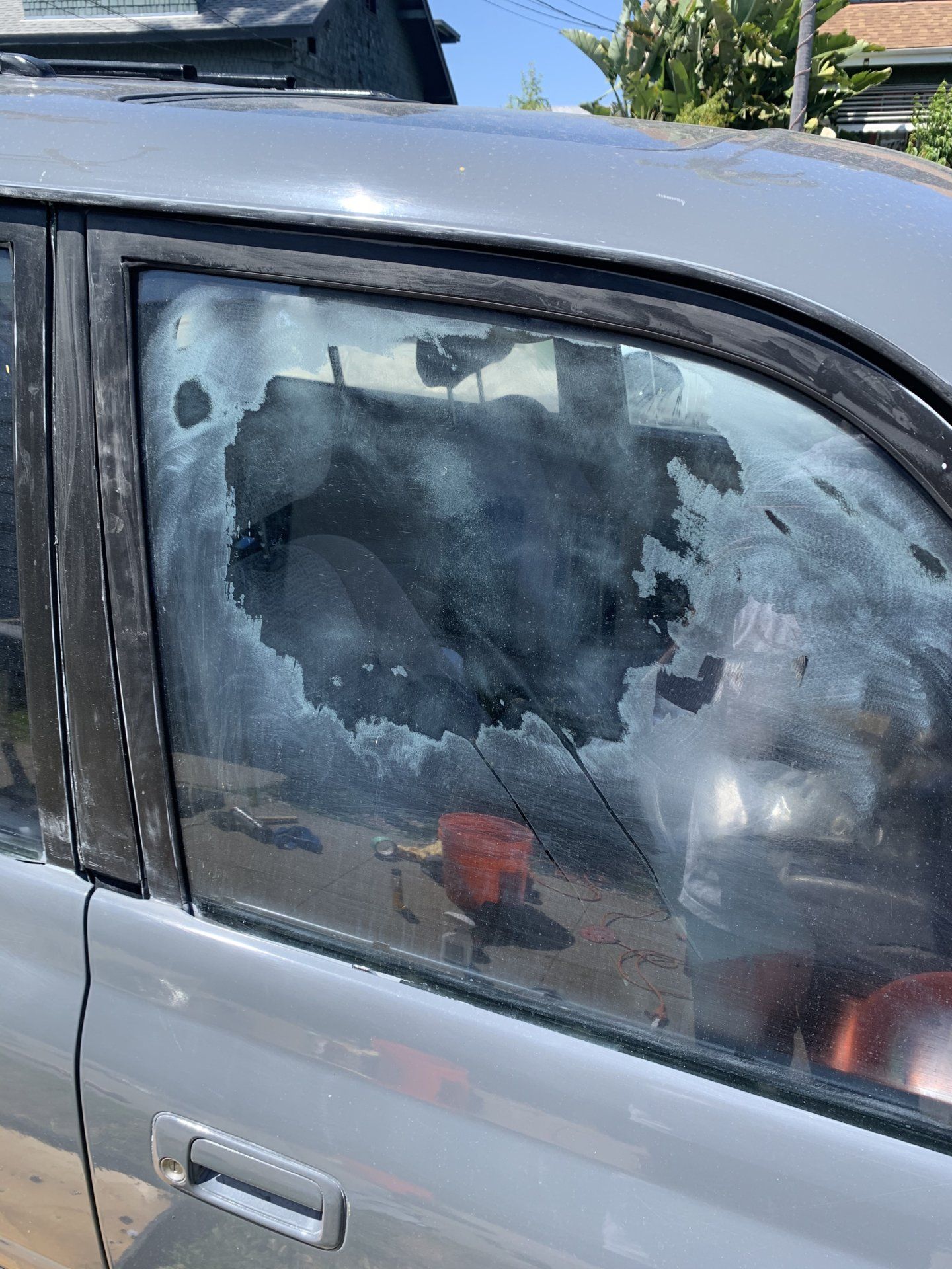

Hey Guys, what's the best way to chemically remove this adhesive leftover from really old window tint film? I've tried scraping it off with a razor blade and it's extremely tedious.
See pic below:
Steam could help.
Hot water and dishwashing liquid.
Good idea to get some tape across the bottom so you don't get all the crud flowing down into the door.
My go-to is WD-40 for this. Soak a rag and lay it on the goo, let is gradually penetrate. It will eventually release the adhesive as a snotty glob, that peels up rather easily with a single-edge razor. Just be careful not to scratch the glass. Then wipe down with GooGone, and then glass cleaner takes the WD-40 residue right off.
I used carburetor cleaner sprayed on a rag, but you have to be VERY careful to not get it on any of the plastic interior stuff because it WILL eat it. Ti does work faster than WD40.
Razor blade
Carb Cleaner on a rag to remove adhesive residue
WD40 to remove carb cleaner residue
Windex to remove WD40 residue
My front windows looked just like yours when I bought my truck. Could not even see out the front windows.
I've read, but not tried, that taking some 409 cleaner and spraying it on the glass then covering the inside with a black plastic bag and letting it sit in the sun will remove the tint film. May work on the left over glue too. Plan to try this this summer to get the old scratched up tint off.
Don't scrape it, you can scratch the glass. I used a heat gun to remove the film and then acetone and paper towels to remove the adhesive. It's pretty fast.
Turtle wax label and adhesive remover. plastic razor blade scrapper for the tough bits (can find on amazon, $6-10 for 100 pack).
It is the ammonia that does the trick it is just hard to work with. I've tried the plastic bag routine with no luck. Spray a bit of ammonia on the tint, with a hear gun on the other side peel it of.
A dull razor blade scraper. Keep window wet with spray bottle of water. Keep glue /tint wet as you scrape it off.Old tint is the worst to remove.Ammonia to remove glue is the best I've used.
