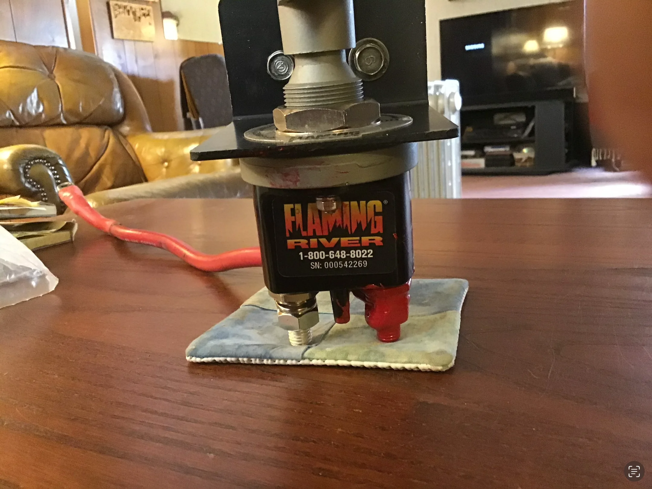

Another vote for a disconnect. I used a Flaming River with a padlock.

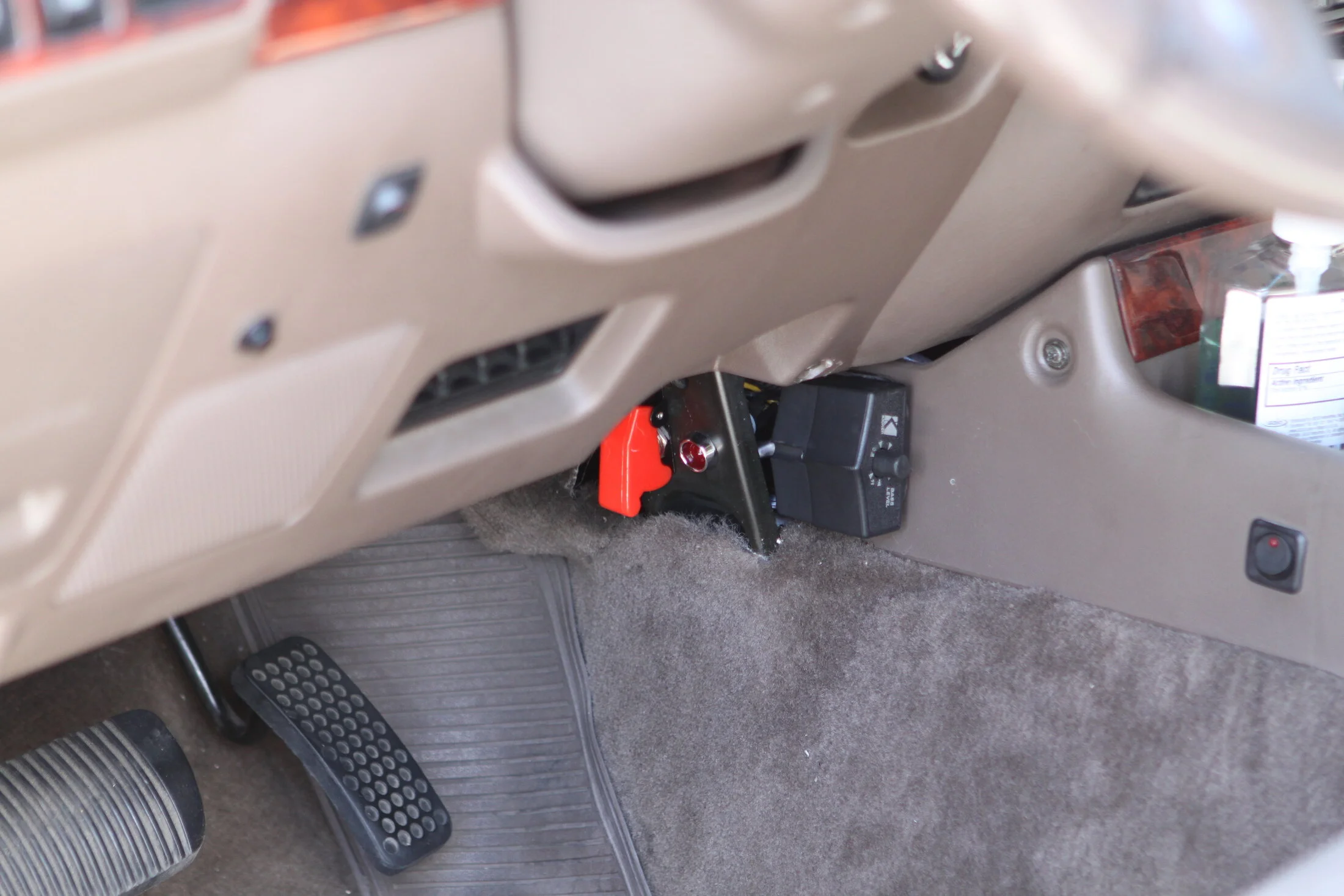

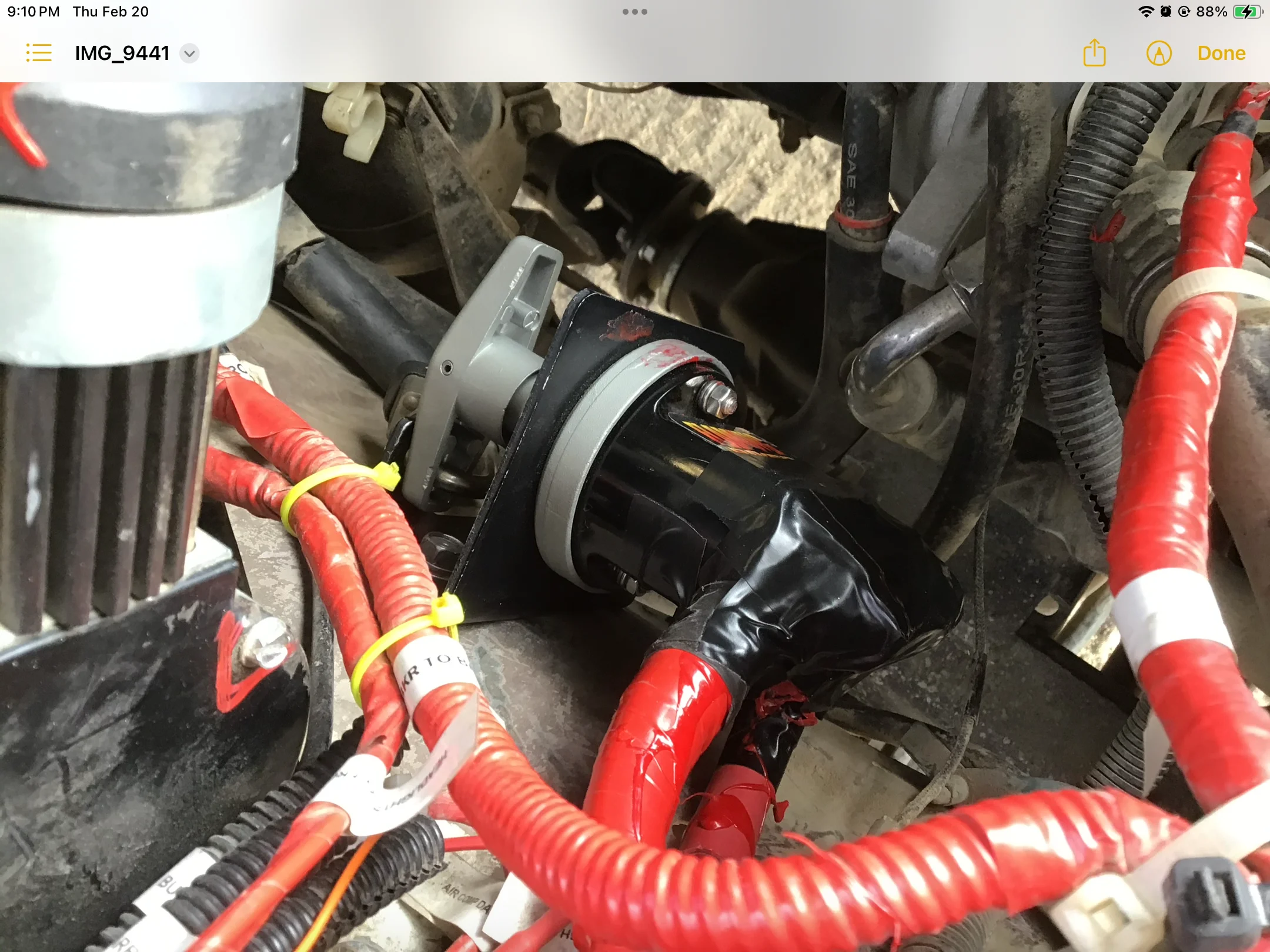

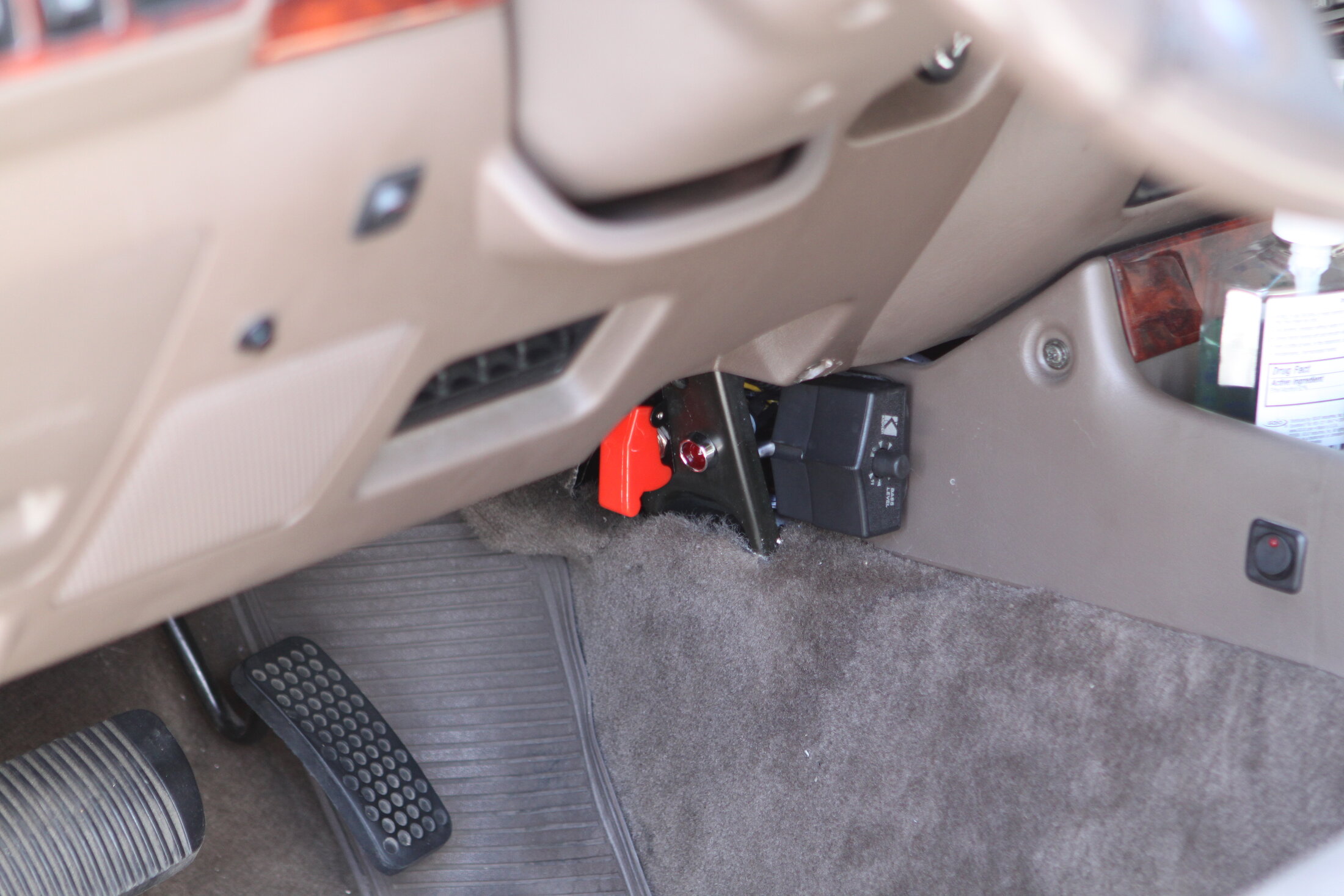

If it was me, I’d do a disconnect. I wired my winch up with one that can be triggered by a toggle switch in the cab. I did this as when I was younger I had a battery cable from my winch short after a crash and fill the cab with smoke. This is the one I used.

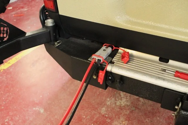

I have one of these that cuts off power to both my front and rear winches as well as an auxiliary Anderson connector on my rear bumper for heavy duty jumper cables.

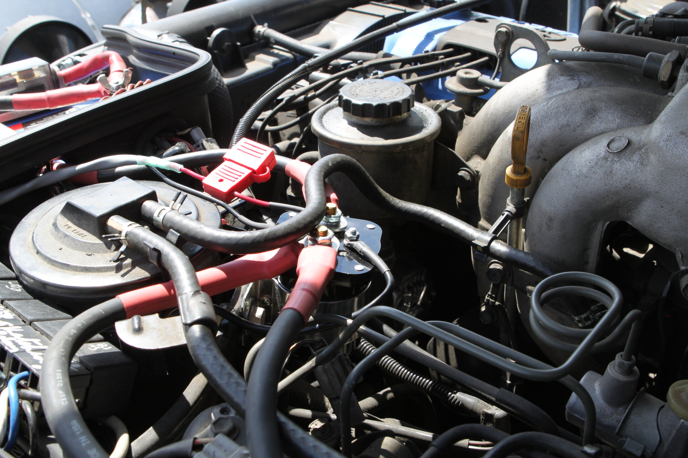

I also have a manual Blue Sea Marine switch wired in parallel just in case the solenoid were to ever fail

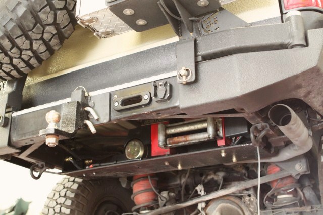

Superwinch Husky 10 wormdrive
