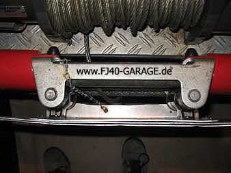

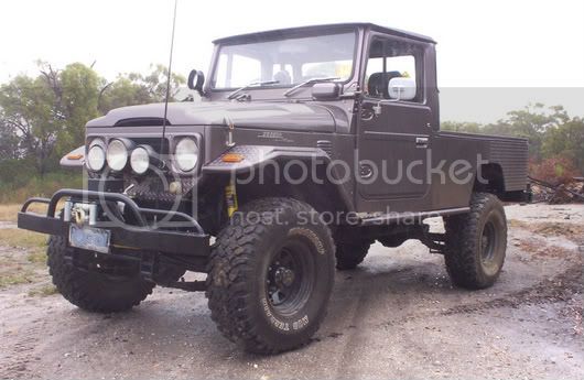

Depends on what winch you like to mount there.
In my case its a Warn XD9000I.
I integrated the roller fairlead into the bumper and clip the number plate on it with some mag light clips and a small chain.
Dont get missleaded by the diamond plate......its just cover for the steelplate below.

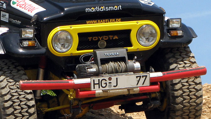

Doesnt work with a 8274 like that.........

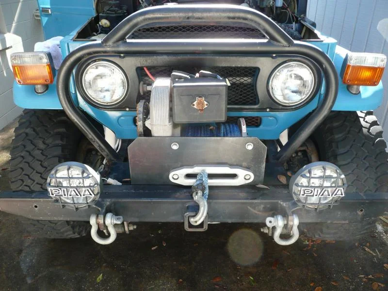

very simply but it works for me

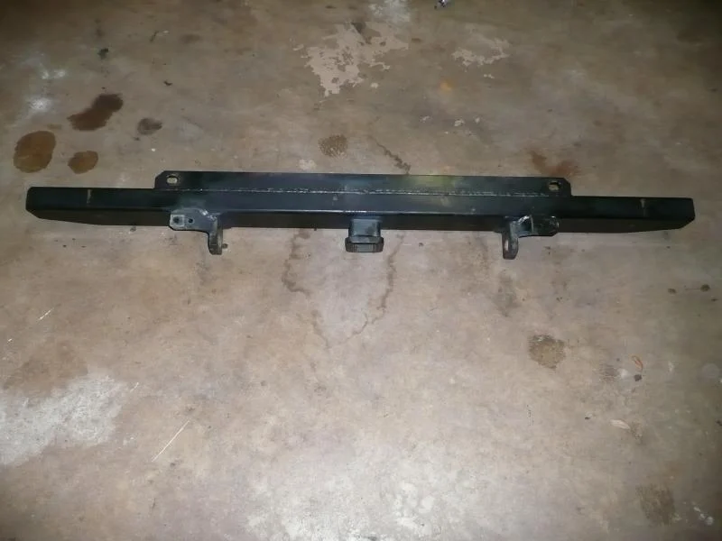

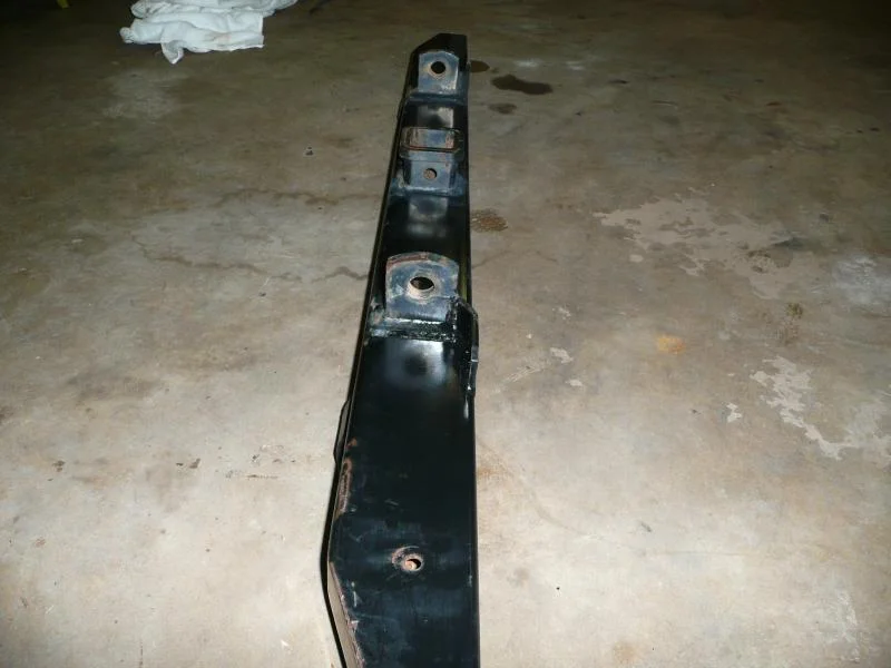

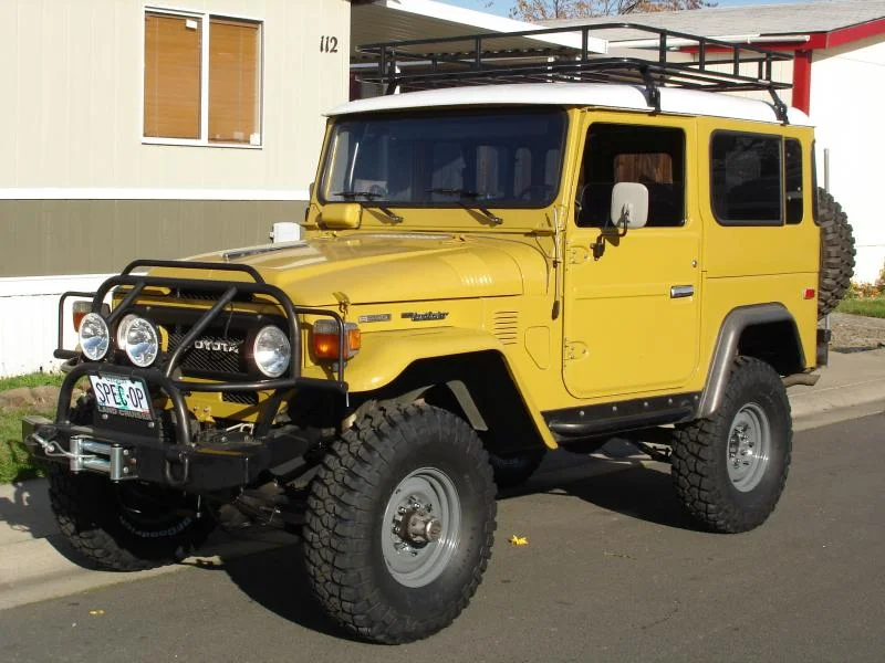

I can sell mine,you just weld a plate to the frame and bolt the winch to that plate..Or if you want the combo: Front bumper,nose guard and PIAA lights then email me,the shipping its on your dime or mud ship from Florida to :confused: The winch and the shackles are in use here.
