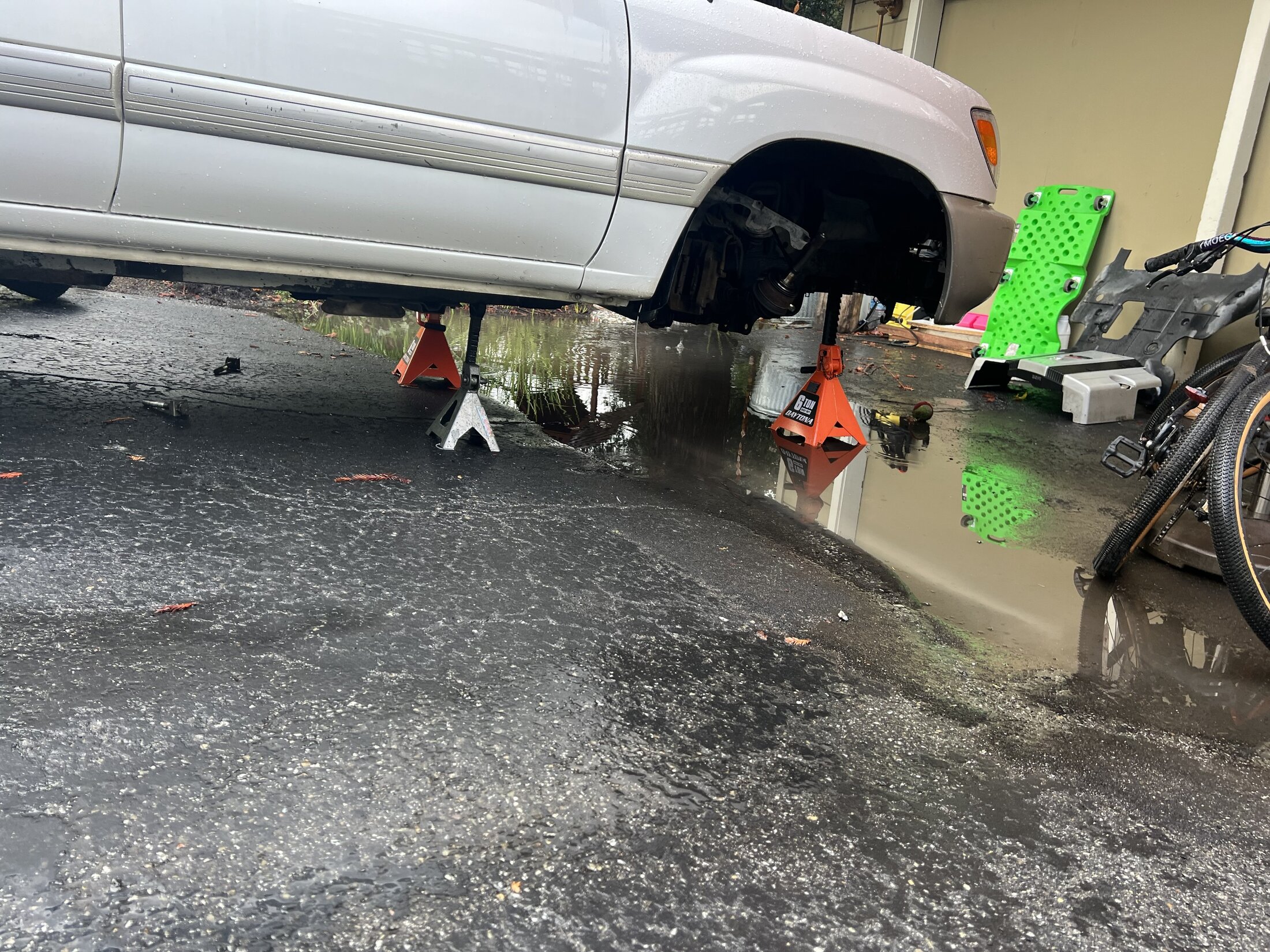

    • Full front knuckle rebuild including needle bearing, gaskets, seals, wheel bearings, ball joints, drive flanges, CV axle… (all Toyota/ OEM)
    • LCA: Cleaned, painted, new tie rod ends, new bushings all around, new ball joint (555)

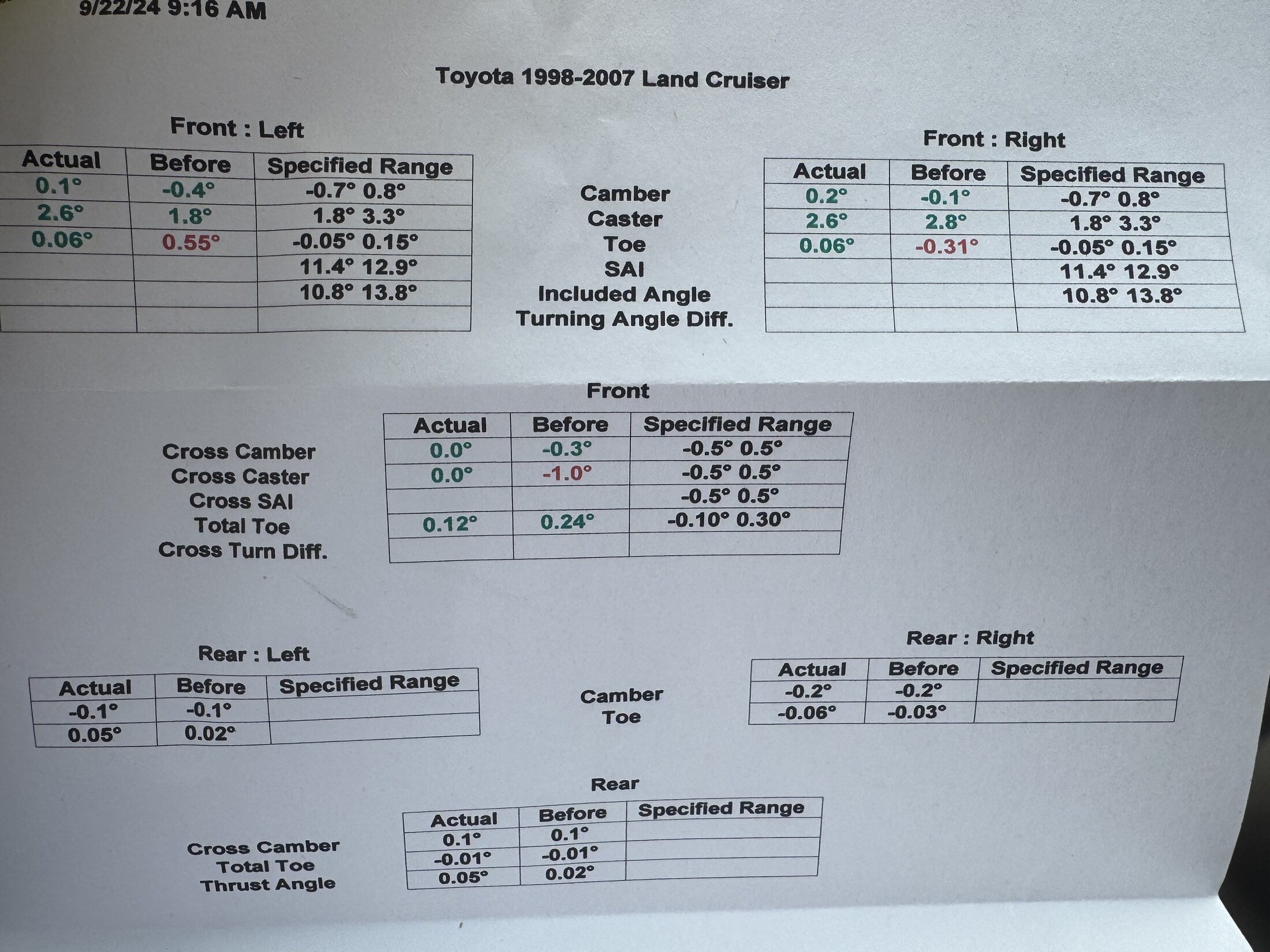

Now I’d say that’s an alignment with 21.75” hub to fender and Dobinson’s 3 degree preset caster alignment :-)
Dobinson parts I have:
- MRA59-A682 3 Way adjustable Rear Shocks (just set everything to medium; bought them to be possibly prepared for light weight vs. heavy weight adjustments, but didn't try anything yet)
- IMS59-60786 Extended Travel IMS Shocks (2-2.5" lift --> 21.75" hub to fender using stock torsion bars)
- Rear Springs C59-167 (0-220lbs additional weight; reason: stock is speced to full car with full load. We're only 4 people and added the rear bumper. Turns loaded and with an offroad trailer we're fairly level, see picture at Colorado River before heading into Mojave Road)
- upper control arms with 3degrees caster correction
--> alignment results above. adjust everything nice and it's a banana job
And yes, diff drop is also installed, Slee. I just chose it, no specific reason. I don't really see any difference in all the diff drops...
