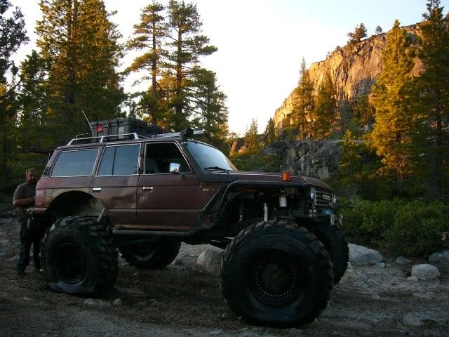

will 39.5"s and 3"s of lift rub?
he is gonna make a thread on it right? i wanna see this for sure.
i think it will be just fine with limited up travel and lots of droop could be a sweet setup.
Its all about the trimming. The c/l of these axles is barely lifted over stock.
Wow, do you have any details on that rig? Gears, axles etc.?
Uh yeah its a souped up 3B-t to H41 to NP205 on FrankenMOG 416 axles with 9.something to one gearing. 16R20 Michelin XLs. On airbags. Full Hydraulic steering. Did I mention body trimming? Probably more unsprung weight than an FJ40.
Headed East this weekend to get parted out I think.

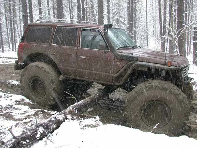

That is just nutty!!
nope :D
not mine but a friends(well it was mine like a week ago) anyways my friend has a sickness that only allows him to build really low cruisers on big meats.
I like him :D
