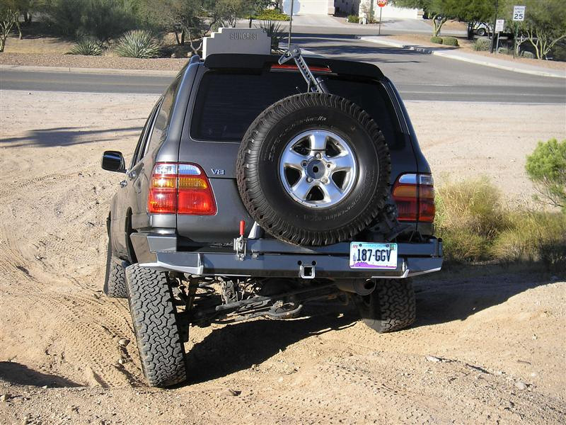

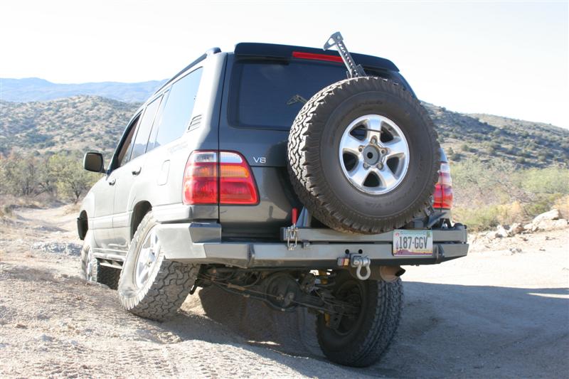

John: I wonder why you have tire rub on your Slee bumper? I only rubbed on the inner fender wall at max articulation...not the bumper itself. What would be so different between our two rigs to cause your rubbing?
I've not seen pics of yours articulating. All I can say is that mine is increcible.
It's rubbing right here though not quote enough to halt progress. Another half inch would kill me, let alone another 7/8".
It's still strange...same frame/body, same size tires, same rear bumper, same lift, same shocks (you have the 74L which are longer...but you have upside +2" bump stops I don't have...), stock upper and lower control arms (then). I am comparing when I had the OME set-up installed...
I know in "measurement terms" the bumpstops should reduce 2" of up-travel. Reality is (from all our observations) that once the stop hits the axle, the axle then seems to rotate even more on that bumpstop. It takes on a teeter-totter effect and that tire just turns in angle-wise big time while the axle doens't move up any more. I think it's because of the added droop on the other side. It's hard to explain but the setup works and adds a lot.
The axle is also VERY crooked when flexed in that pic. The stuffed wheel is far rearward and the drooped far forward. I guarantee you that IF I had a shorter shock on the drooped side and the long ones on the stuffed side, I'd not rub. Of course you can't use that setup.
Check out the turn-in on the rear axle:
