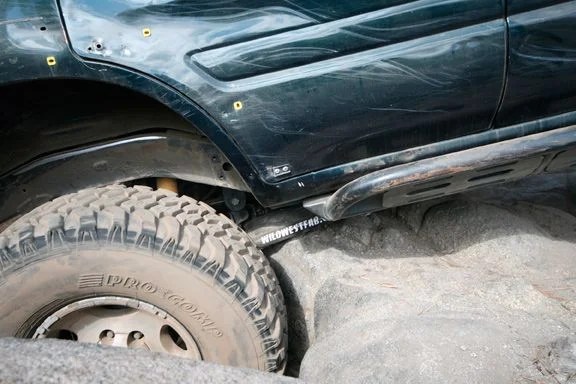

Paying for a part or not has nothing to do with my review, nor ANY review in 4WD Toyota Owner magazine--period. Talk to anyone who was part of my group across the Rubicon for Marlin Crawler's Roundup in 2007. Jason from Locktup.com would be a good start. Trail tested speaks for itself in front of plenty of wheeling witnesses. The Wild West arms kicked ass on a run that went from Loon to the Springs in a day, easily.
I stand by my words, money ain't got nothing to do with it. Either they perform and hold up to abuse, or they don't. Pictures say it all--Nuff said.
Oh and those are Snake Racing's caster corrected front arms on it, too.
More trail testing
Marlin's run 2007
and a few more
Wild West arms NOT hitting rock when normal ones would have.
Finals
last pics of Rubicon test

I see the tailshaft has become the lowset point, where its rubbing on the rock in one pic there too.
