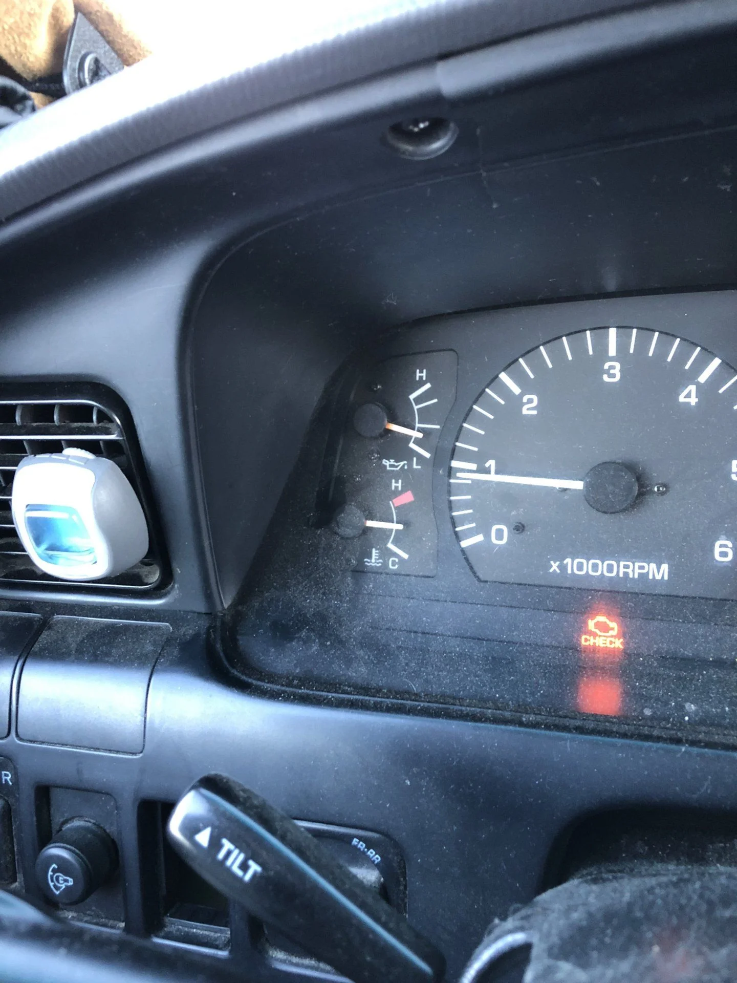

It just recently got cold here in Montana, and I noticed that my oil pressure has gone down significantly even after warming up my 80. I have been using 10w-30 oil and had no problems prior to it being co

From a gauge standpoint, it does not LOOK to be out of line at idle. What is it at 3000 RPM?

that looks fine from the pictures, that's about where mine is normally. the gauges are really more of a guess at the oil pressure rather than what it actually is.
pffftt ... that seems just fine, Mine can hover just above the bottom line when using 5w-30 and the AC isn't running on a warm day. Your gauge is where mine reads with the AC bumping the idle up.
I would be more interested in what its like at 2000 to 3000 rpms than at idle.

Maybe not calibrated numbers, but mine has always been at the third mark when cold and going down the road, second mark at warm idle. All of the ones we work on are as expected, every time, so repeatable. Have had a couple of wires break at the connector, but have only changed a sender as PM, never seen a failure. Don't give exact number, but gives consistent, repeatable indication of oil pressure.
