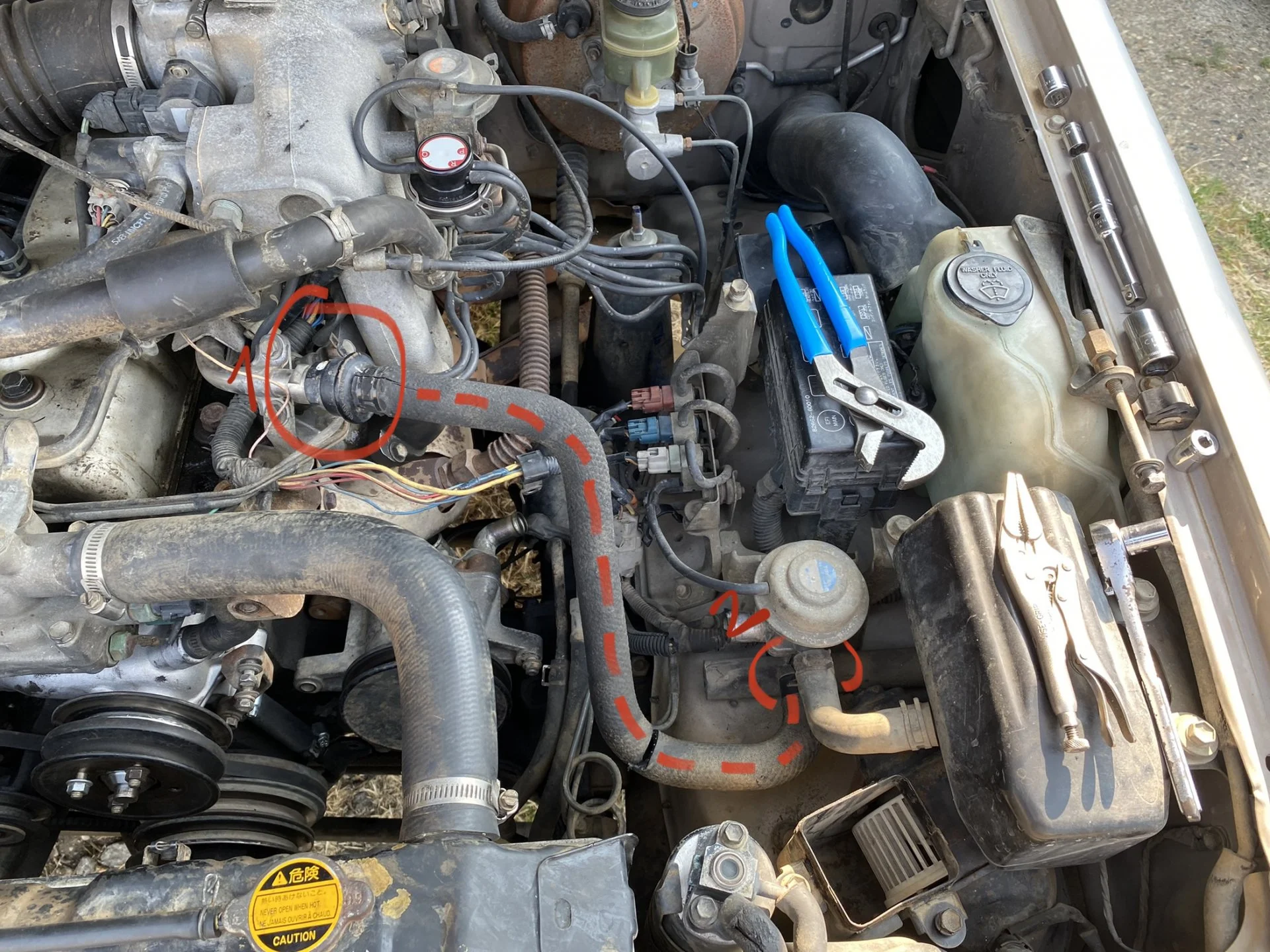

1991. I’m currently missing one of the hoses that is a part of the smog pump/air injection system— would that cause this?
*see picture for what hose*
I don't think it should as my smog pump was removed when I got mine. Not sure how that overall affects the engine. Is the part where it connects to the air injector tube (metal part in upper left part of the picture) capped off or open to the air?
