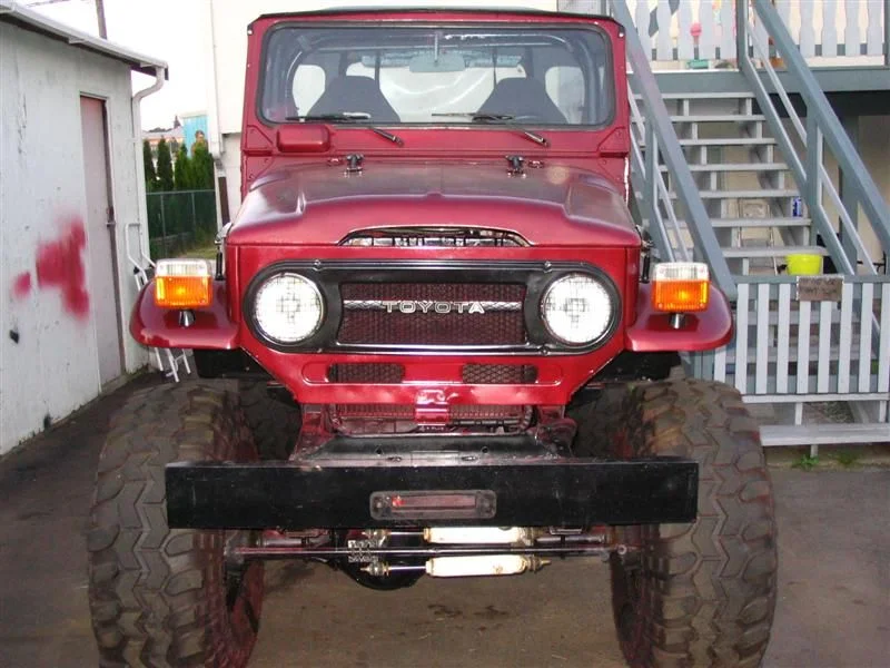

Its not the cruiser lean, installed the leveling plate, Also, installed new body mounts, still the lean in the front. Kinda messed with the body a little, but... anyone see this before?

WOW it really looks bad in the picture

o.k. are you ready
loosen the following
2 bolts at bottom rear edge of front fender on both sides
2 bolts from apron to bib on each side
1 bolt up in front corner of fender to bib each side
2 bolts ineer fender to bib each side
4 bolts holding feneder support to frame each side
check fender supports to make sure they are not bent from fender stepping on by fat guys.
now use bottle jack or something to jack the fender supports at frame or lower them until you got it level( the holes are slotted a little)
a scissor jack on top of tire and lifting on fender support helps droopy fender and help to level things
once acceptable tighten all loosened bolts
After looking closely at your pic I'd say you've got a twised front end. Look at the top edge of the bib and notice how it is not level with the bottom of the windshield. Try the adjustments mentioned above and see if that helps. I've seen this before on a Cruiser that was rolled...

frame aint bent , look at line on bumper , straight , I know , stand up straight when photoing and fill it with gas....
maybe the bumper's crooked?

I agree with this. The order in which you attach the front end makes a HUGE difference. The first time I did it I made THREE trips to the frame shop and they told me I was crazy. The second time I put the front end back on, I got it level and then tightend the fender supports LAST. It required a bottle jack.
