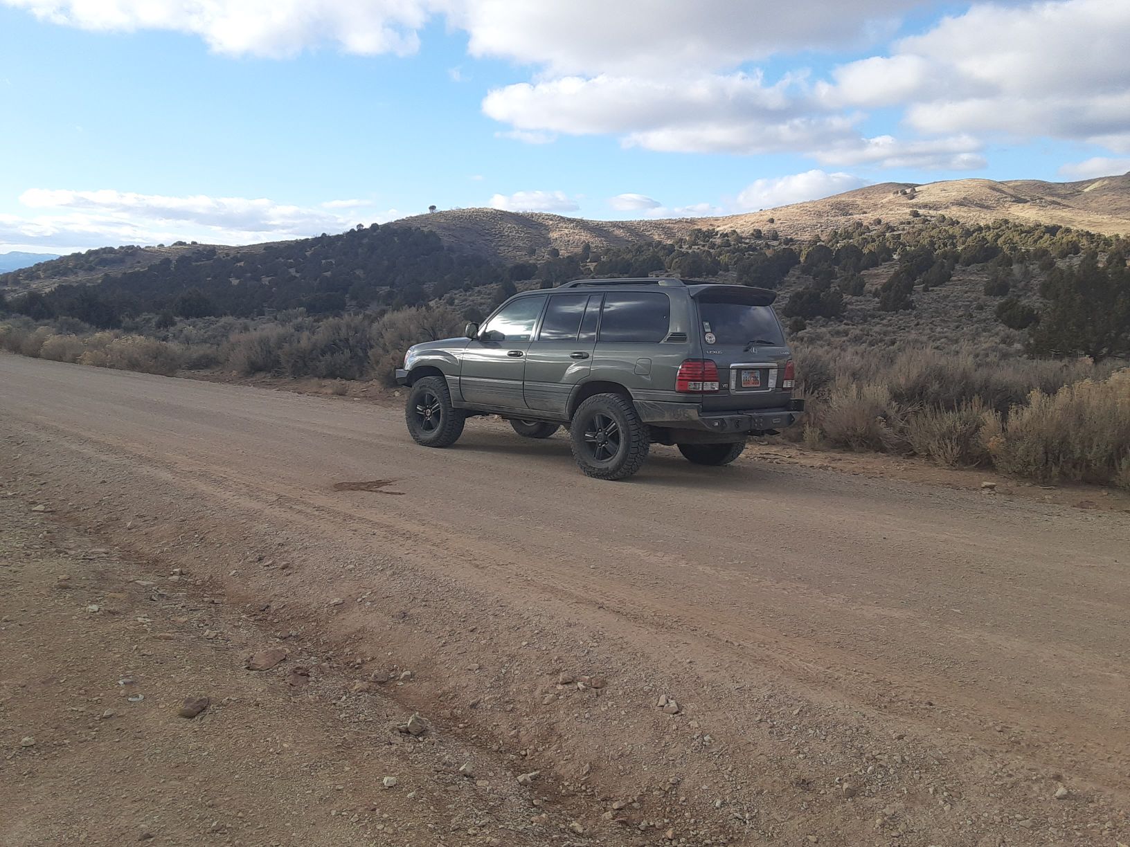

295/70r18 Firestone destination mt2 on factory Tundra wheels.
No spacers, no UCA's, no rubbing
295/70/18 BFG KM3 on Method NV 305 wheels.
Ironman 2” with Foam Cell shocks and diff drop. Pinch weld hammered. Rides great no rubbing. Now time to start bumper shopping. Thanks for all the information!
