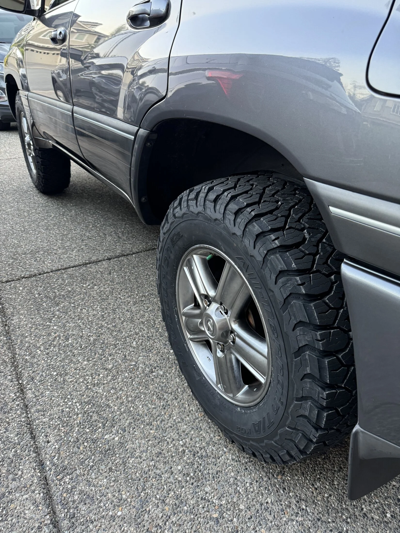

I have installed KO3, so far it's been great! I will replaced KM3 on my 200 to KO3 in the future.

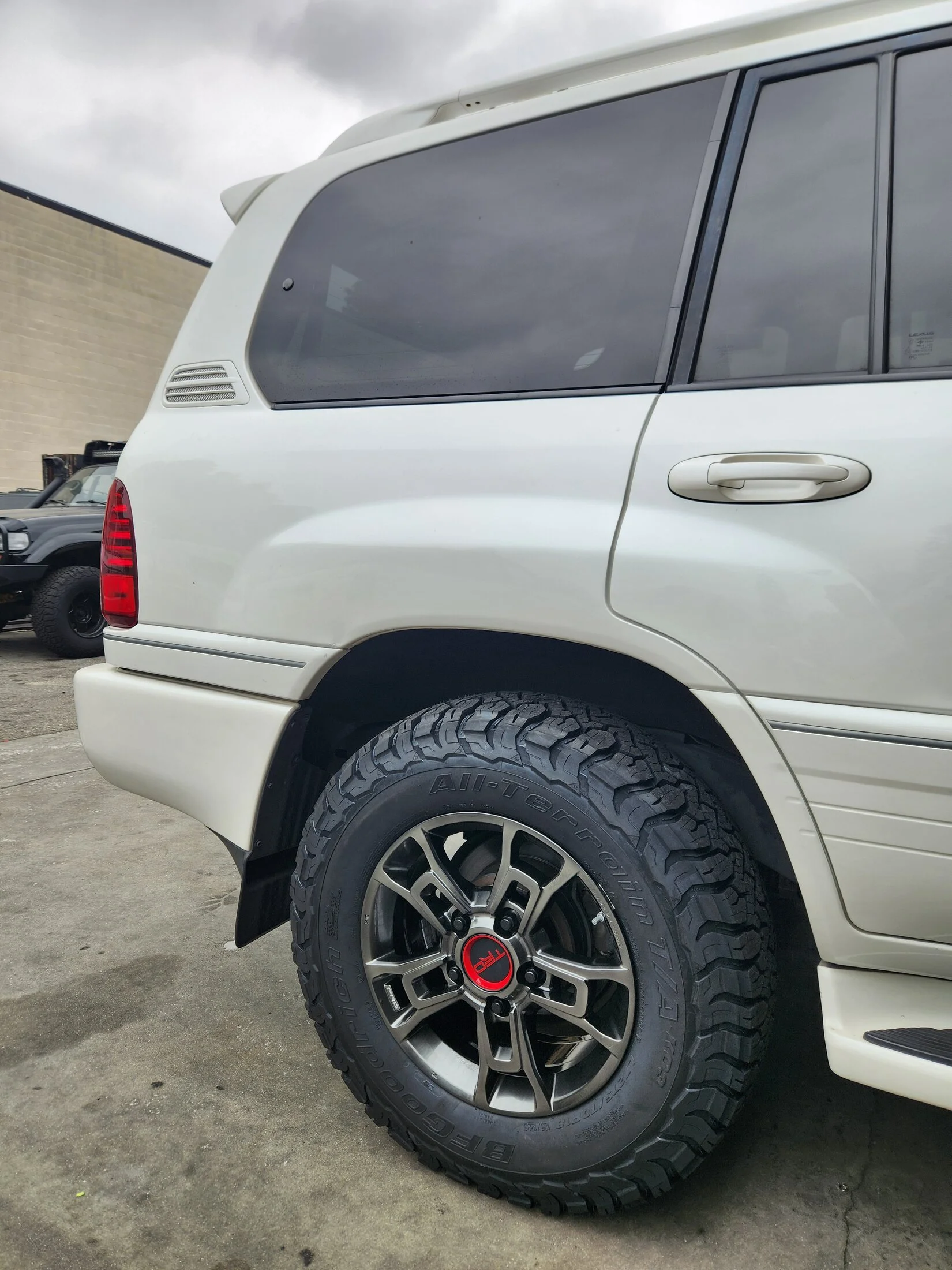

I did KO3’s and so far so good. No issues I have noticed with them being “E” rated.

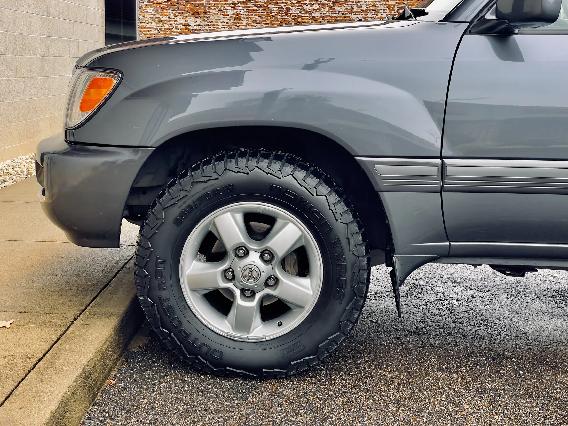

I have 275/70/18 KO's as well. I will not do it again. It's not terrible, but you can definitely feel the "E" rated tires. I'm thinking 285/65/18 next time.

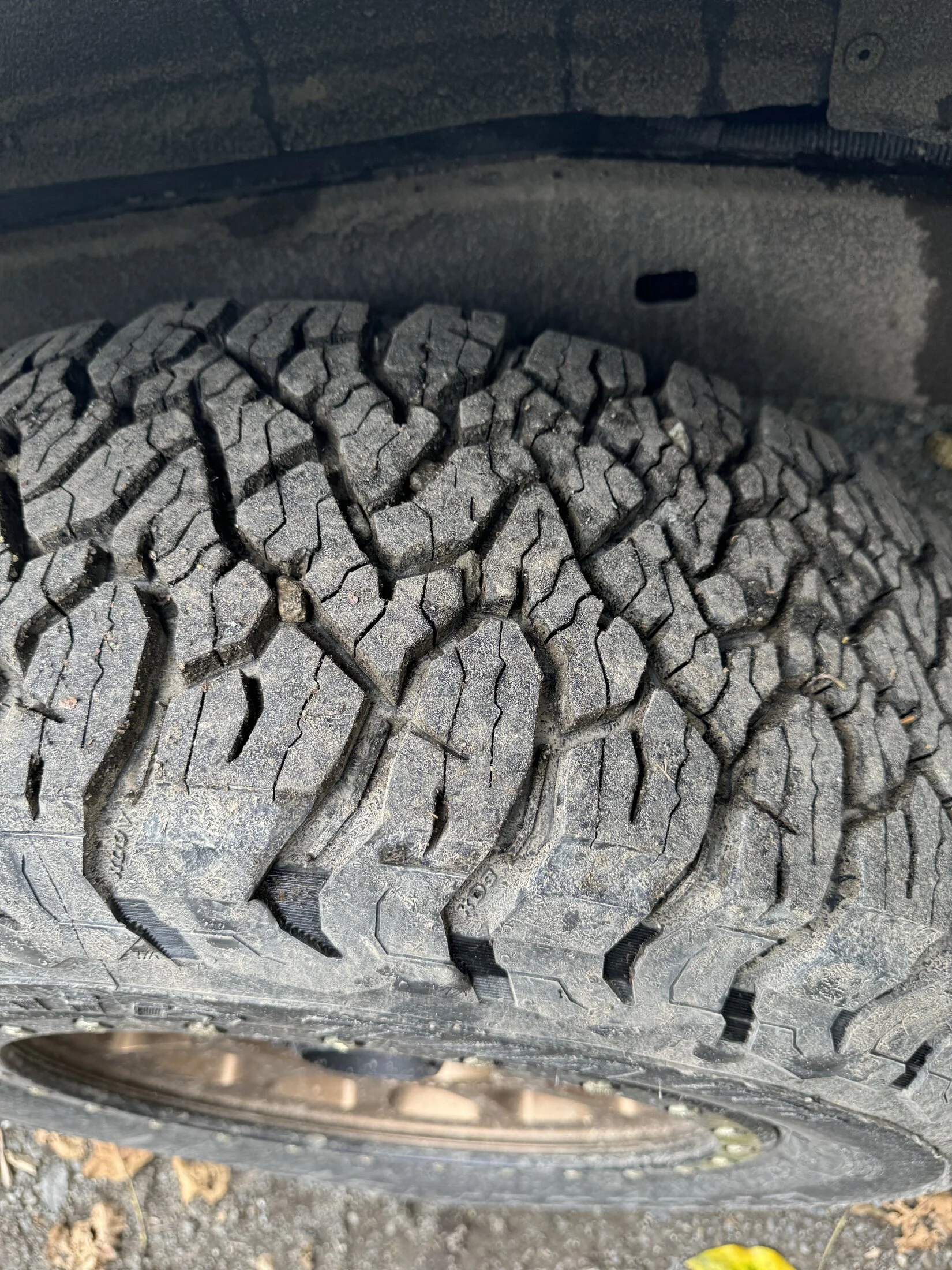

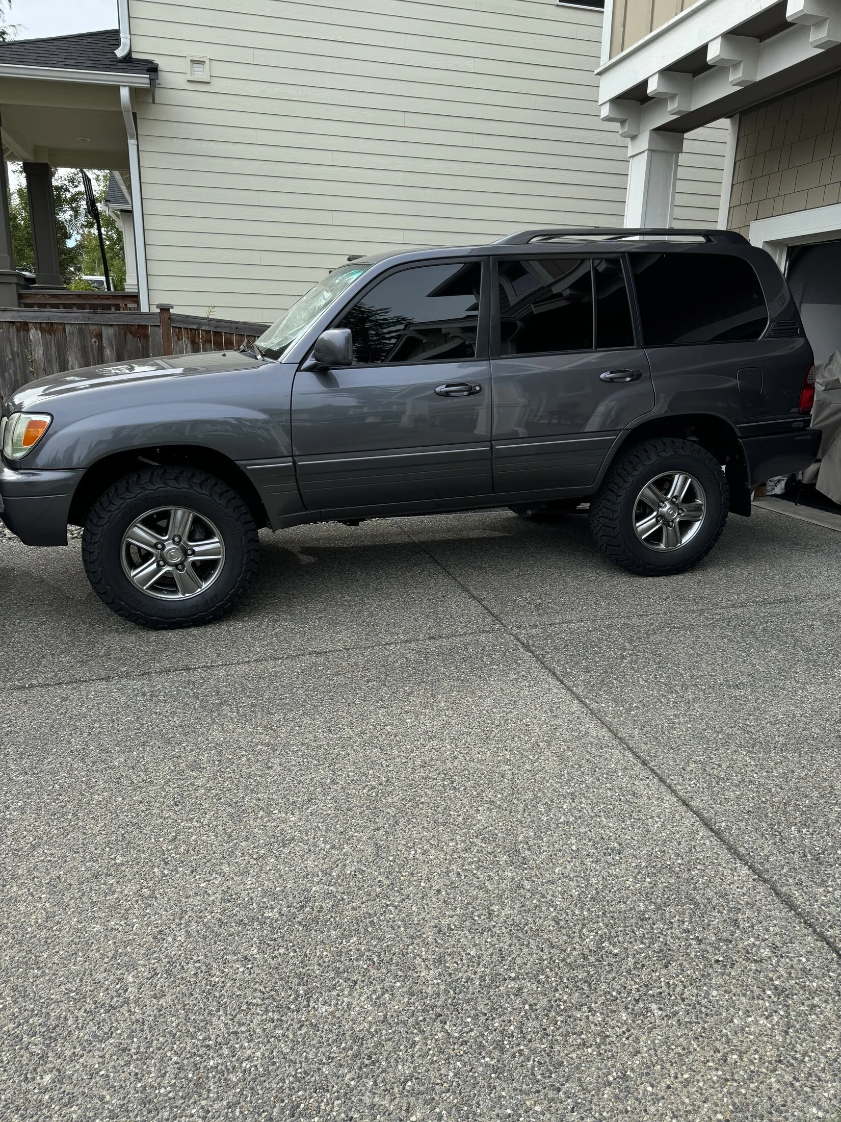

I’ve had my k03 in 275 70 18 E (+25offset) for a little over a month now. They’ve been great In the rain so far. My only concern is how much rocks they pic up when I go on gravel roads. Besides that I love mine. mine rub the very slightest bit when turning.
