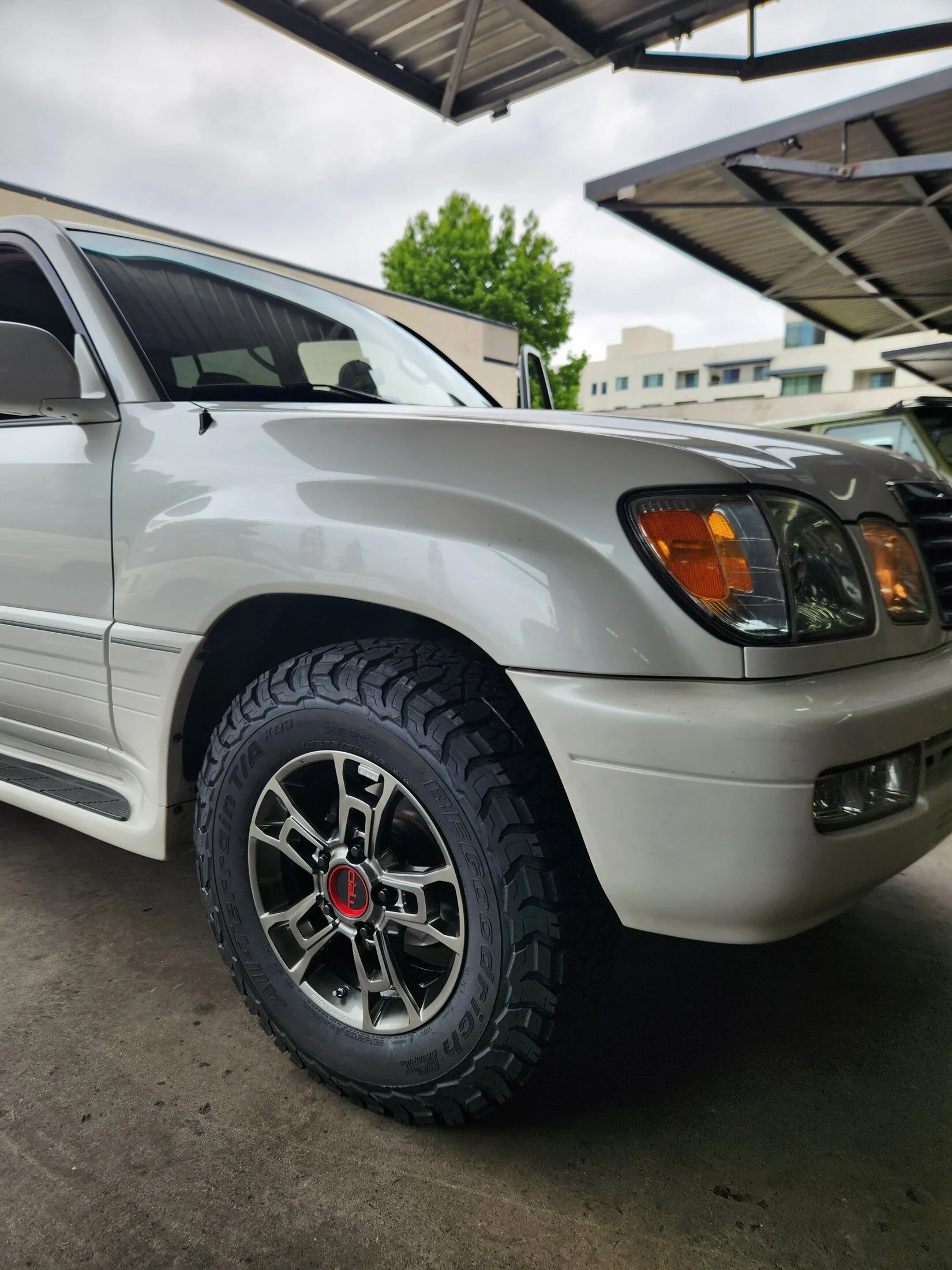

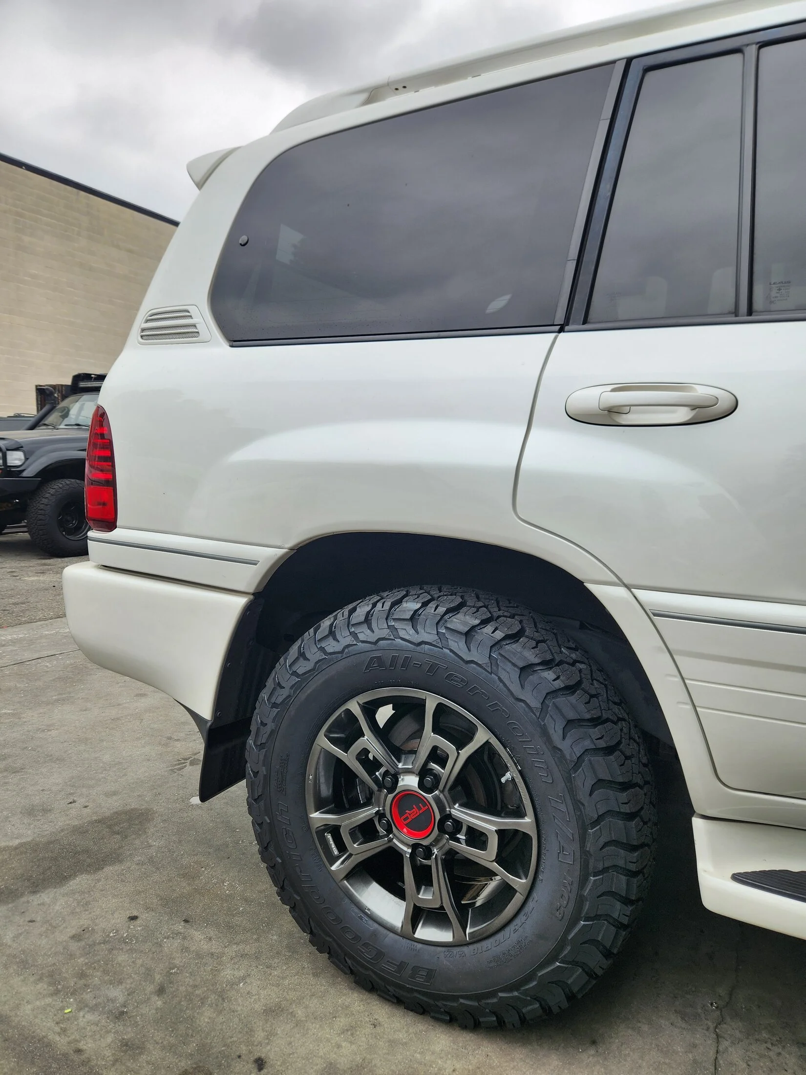

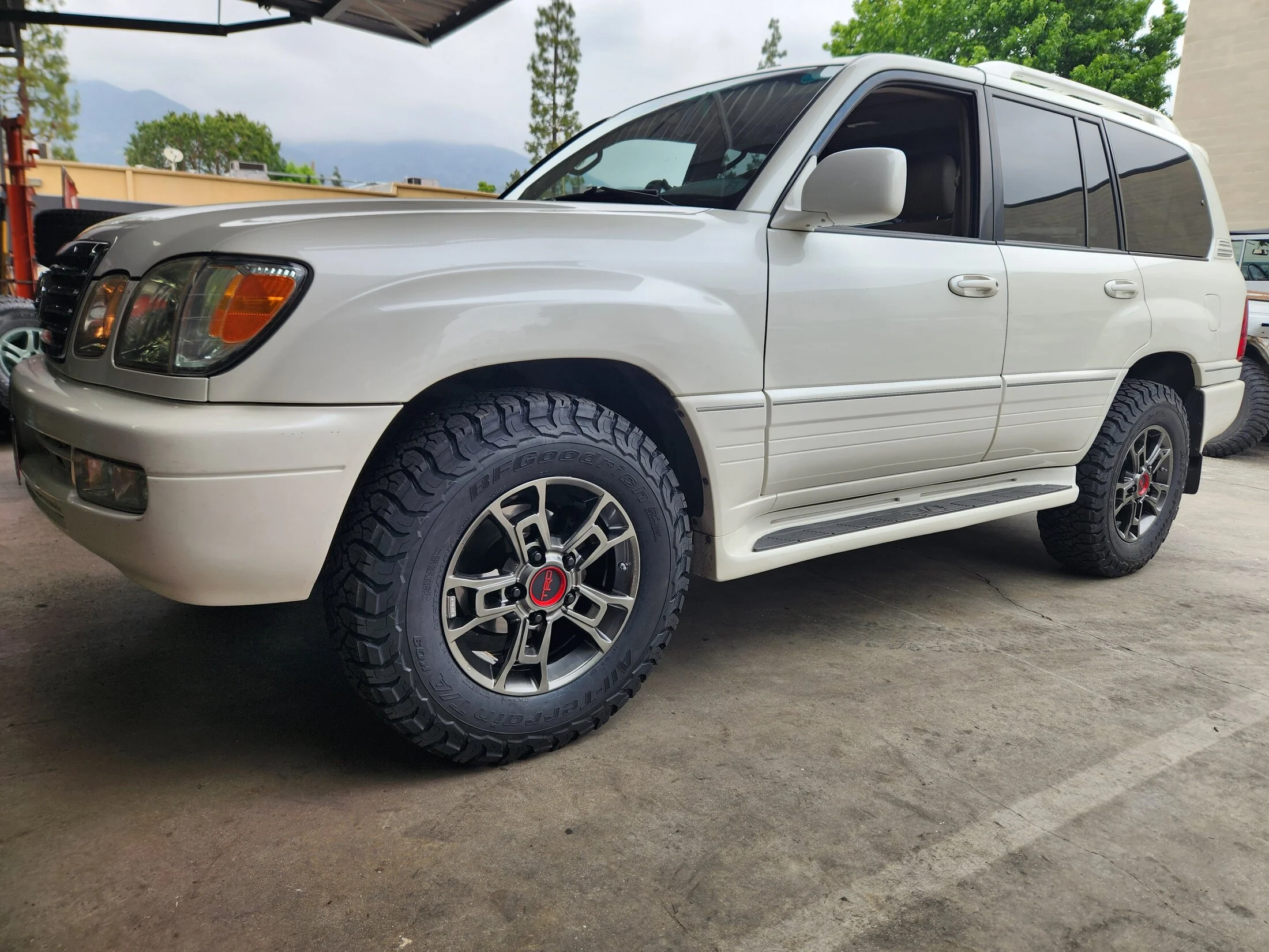

I wish I had seen this thread before purchasing new tires. I bought a 2000 LC a few months back and have been looking forward to upgrading to larger tires since purchasing it. I ended up getting a set of Tundra 18s and went with 275/70/R18 Falken WildPeak AT/4s. The tires look perfect but unfortunately with them being load range E the comfort factor isn’t ideal. I wouldn’t say they are horrible by any stretch but coming from factory size WildPeak H/Ts they definitely ride rougher. I don’t go off road enough to justify the harsher ride so if I could do it over again I would buy 275/65/R18 WildPeak AT/4s in load range SL.
Stock height?
No lift, but I did adjust the torsion bars to bring the front up about .75” — the 265/70/18s are about a 32.5” tire, stock tires are around 31ish.

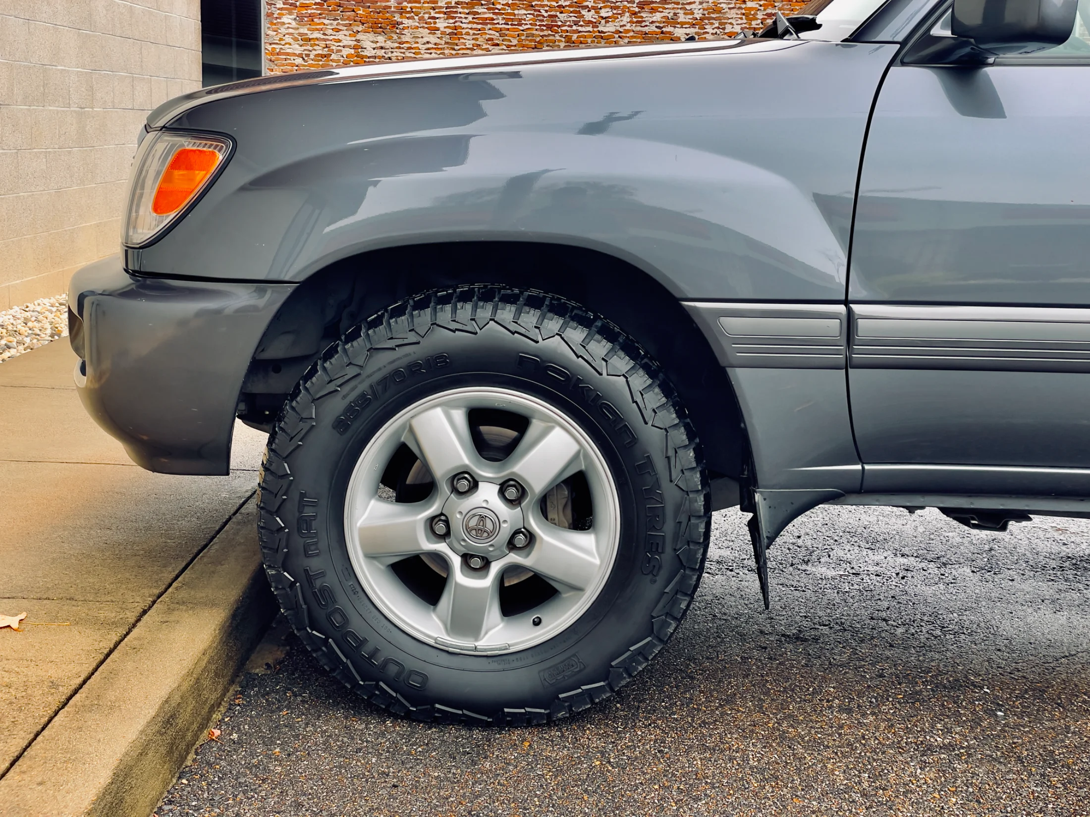

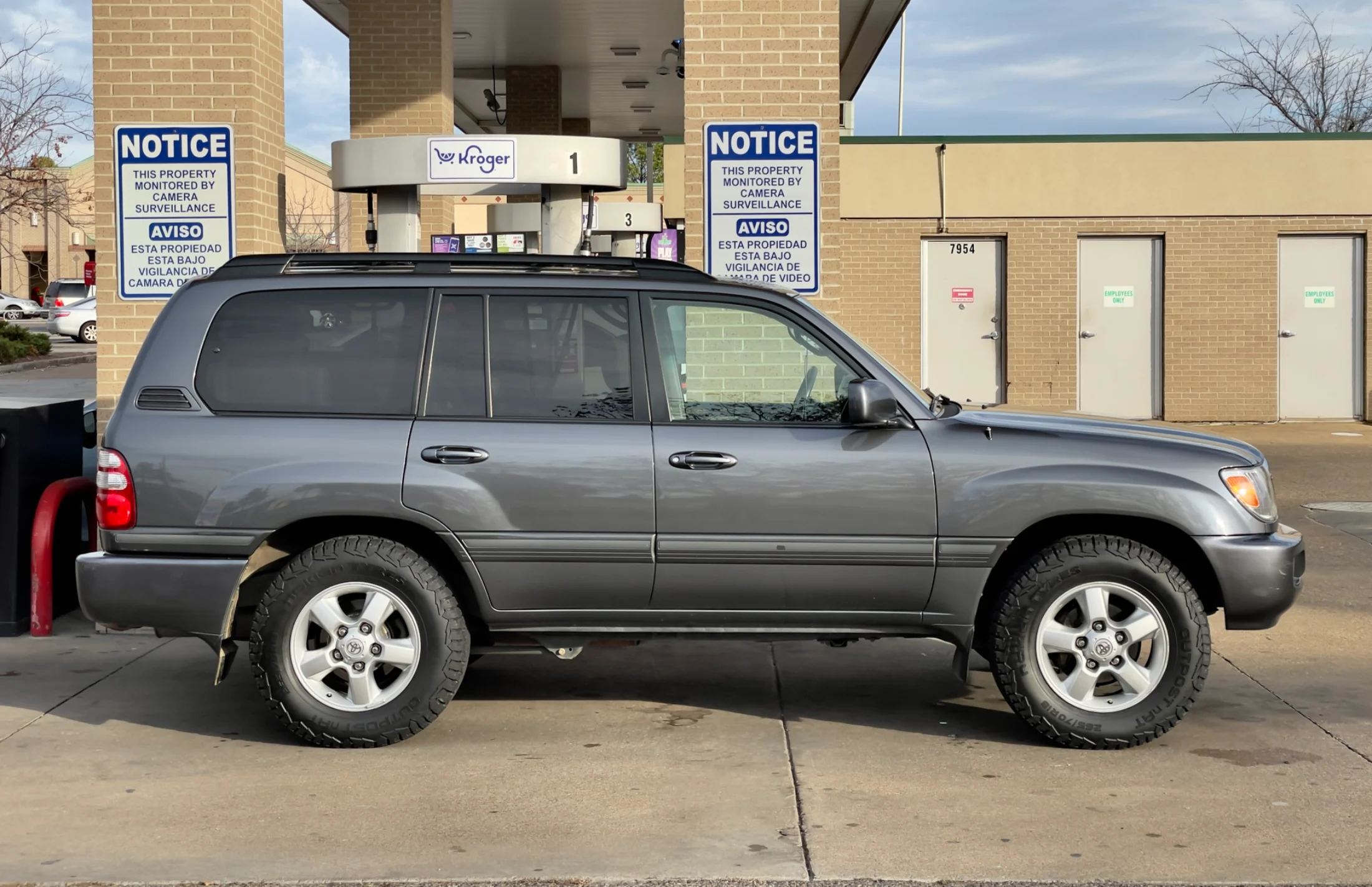

Don’t overthink it (says the guy that does extensive research). Just get some 275/70/18 KO3s. My son just put them on his 2004 LC and they ride like butter. I have 265/70/18 Nokian outpost nATs on mine and also have been great. My 2 cents.

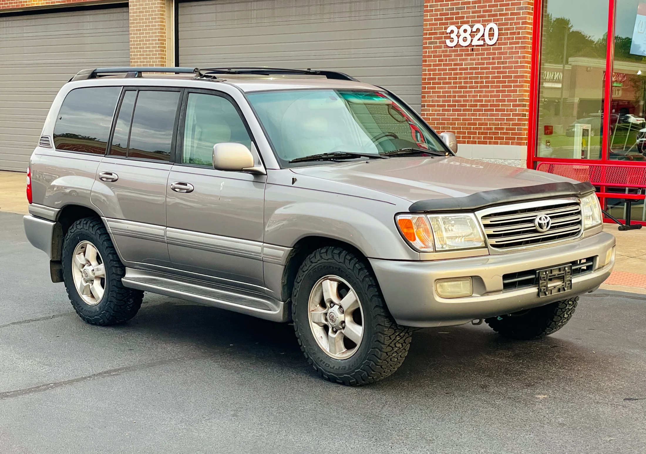

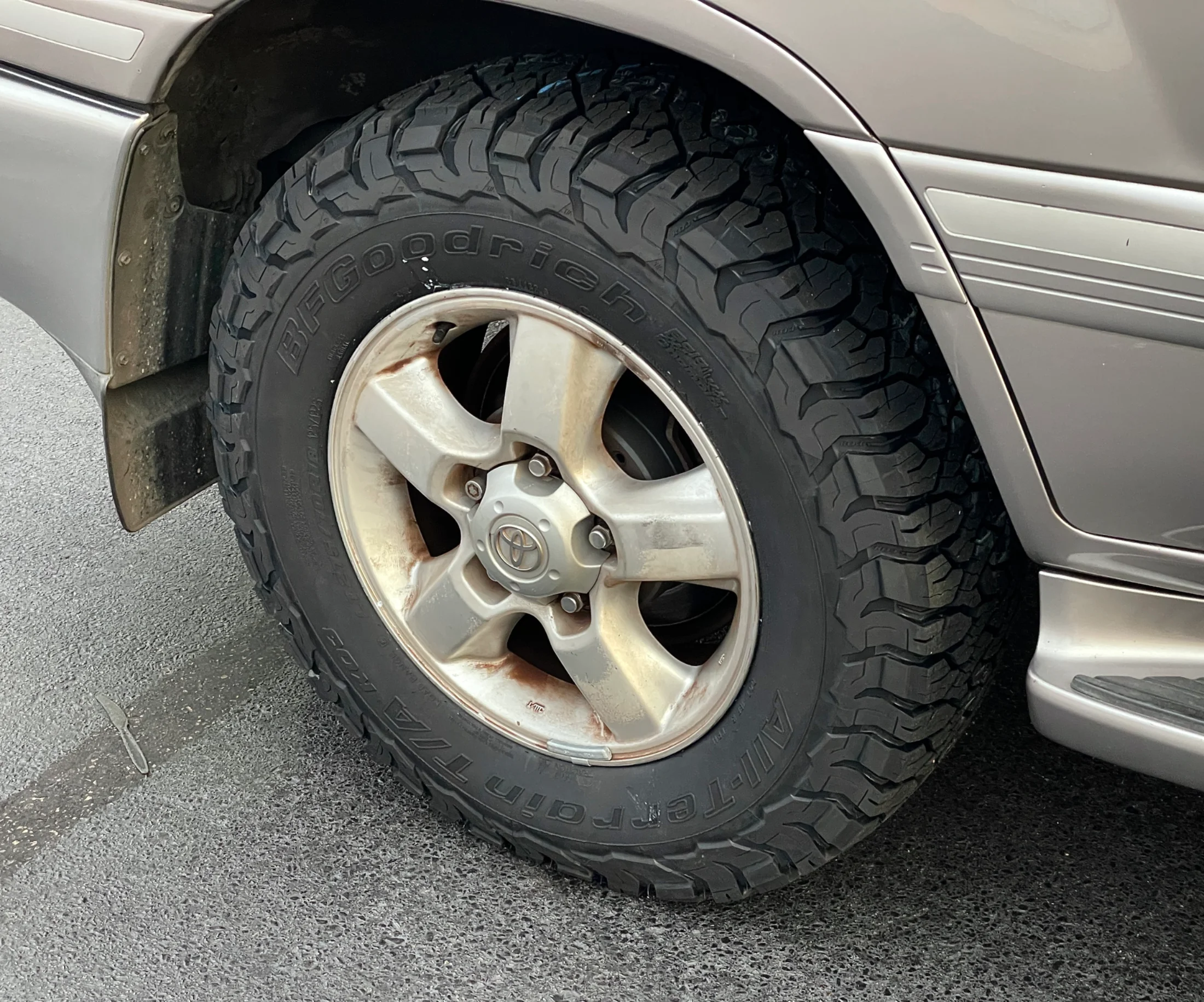

You won’t regret going 275/70/18s. The KO3s on my son’s Land Cruiser ride very well on road and I didn’t notice any difference in acceleration or braking coming from my LC (both stock 2004s) with smaller and lighter P 265/70/18s. I actually think his rides better.
