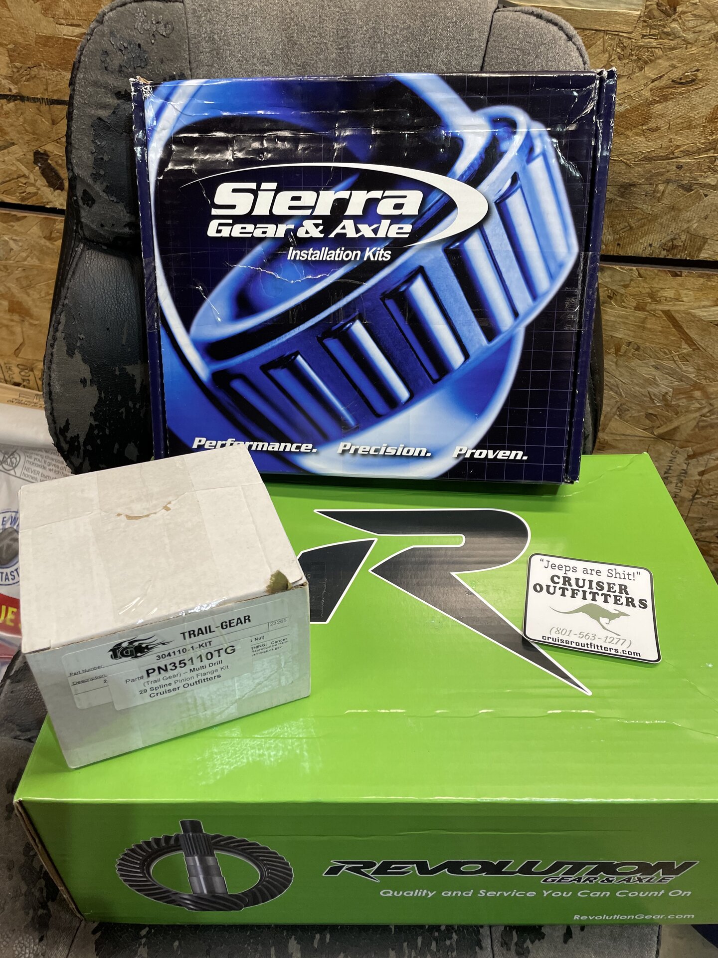

Nitro are china made now. I just replaced my front 5.29 with Revolution gears. ordered from Cruiser Outfitters.
Also be ready to buy a new pinion flange as they upgraded from 27 spline to 29.
The box might be made in China (don't confuse packing material origin with product) but this is direct from their website and my gears were not made in China. Maybe their website is out of date.....?
