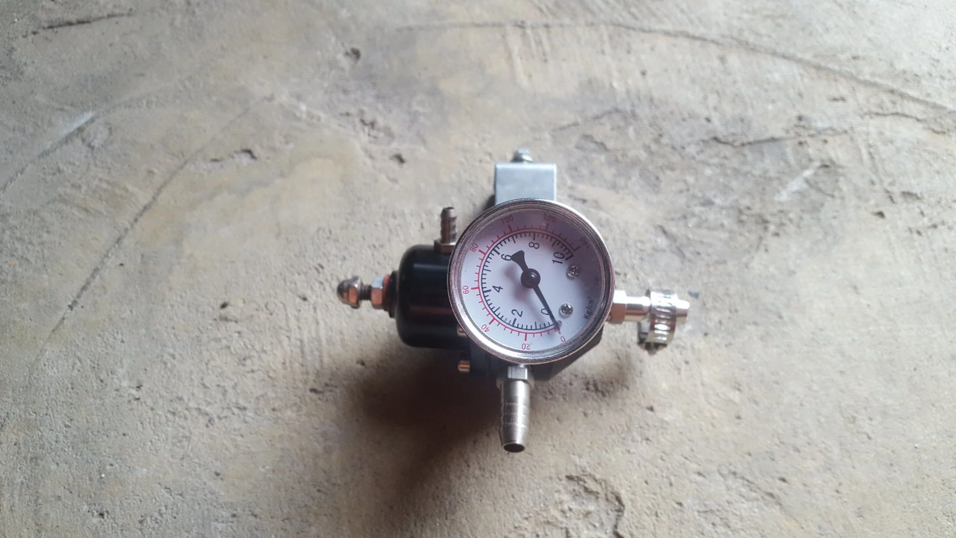

Are you running a fuel pressure regulator? I visited BTB/Man-a-fre in Nevada a few weeks ago. We talked about the fact that they only use webers on their xF engines, and they emphasized that the mechanical Toyota fuel pump puts out too much pressure for the Weber.
No sir. Filter and mechanical fuel pump is all.
I did read something about the pressure being too high so that may be something to consider.
Thanks
@JohnnyFish, this thread looks interesting?
Well, that muddies the waters: Jeep filter, regulator, no regulator…
I should probably just try and find an Aisin carb/air cleaner to get me by until I go sniper. But I’d rather figure out if I am indeed missing something here.

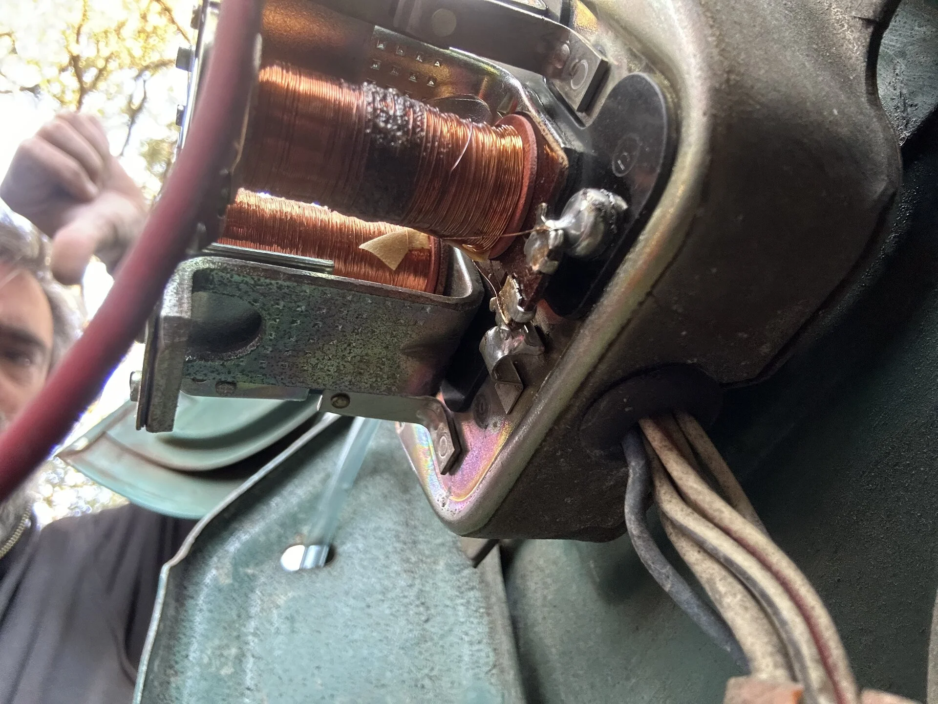

I’m grounded via a fried voltage regulator. Put a couple hundred miles on the girl over the last couple weeks and today my battery decided to start bubbling over. Further analysis revealed an overcharge of 17.5 and climbing. Further further inspection revealed a toasted VR…
