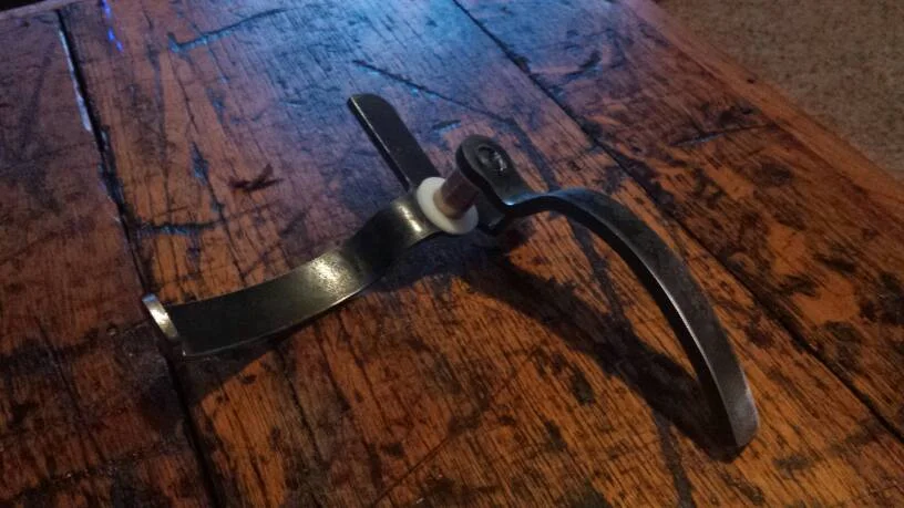

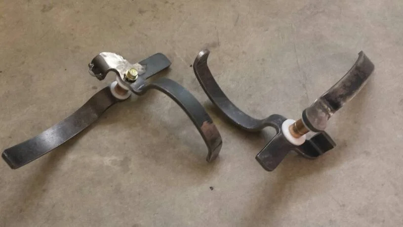

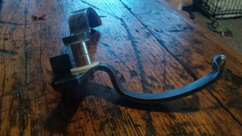

Some pics... not competely done yet but you get the idea.
Look perfect , great work.
I'll take full set including bushing.
Send money to PayPal?
Thanks for the hard work
Almost too nice to use! Now I'm really going to have to give my doors a good once over.
