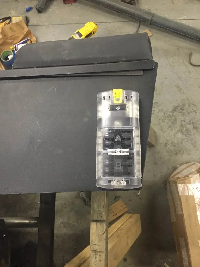

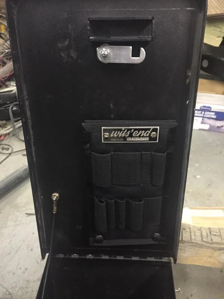

I also mounted some stuff on my center console. Thanks @NLXTACY !
And:
Not pictured: the mounting for the FTM-400DR which will go beneath the center console. The control unit is always remote mounted with it, so you can guess where that will go, and I will use an external speaker because I don't know how well I will hear the speaker underneath the center console.

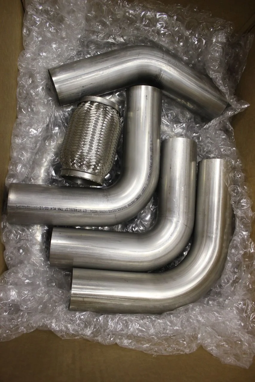

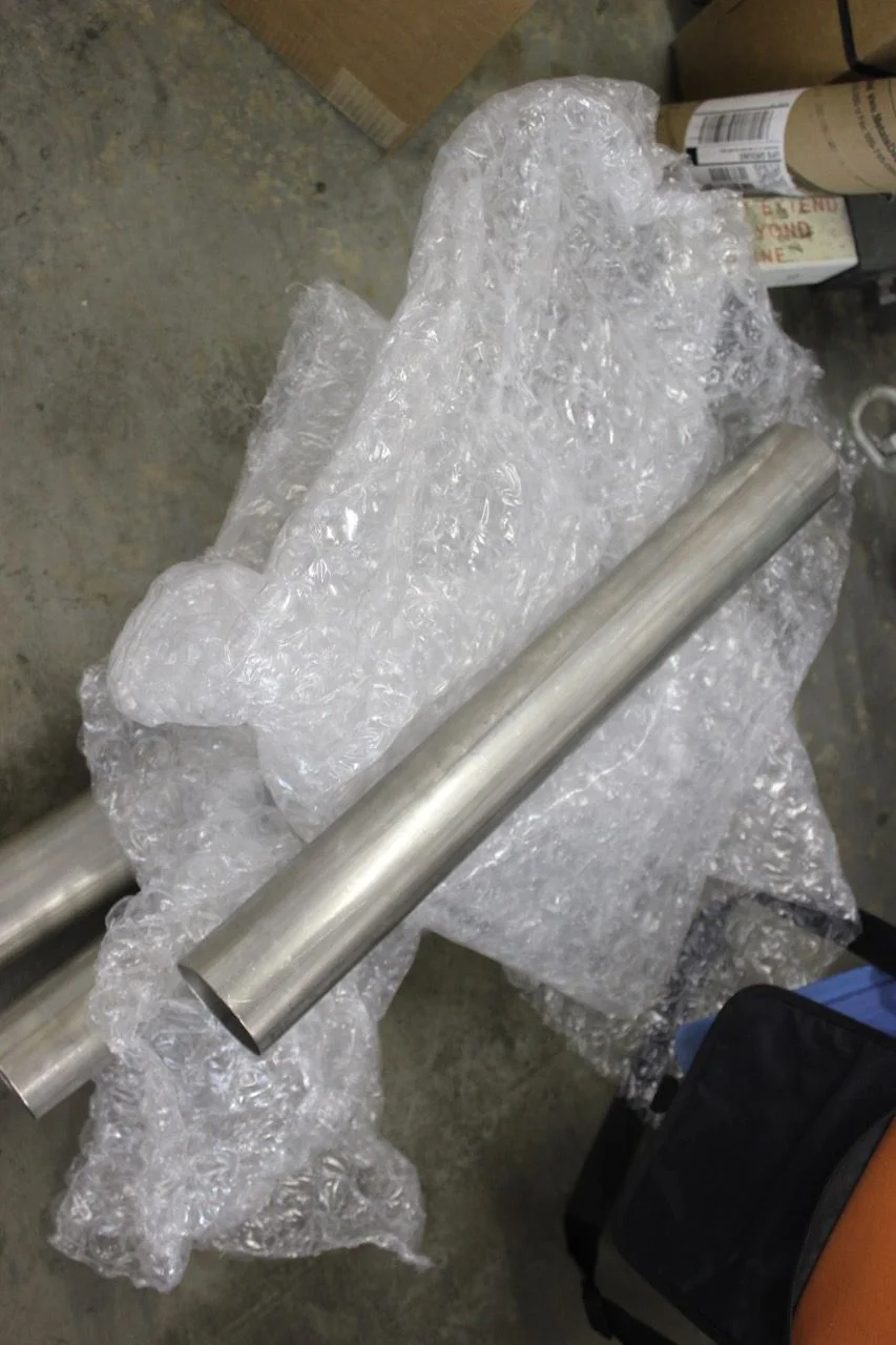

3 inch, 304 stainless. I'll be using all V-band connections, and I also have some stainless bar to bend and connect the exhaust using the Toyota exhaust isolator blocks.

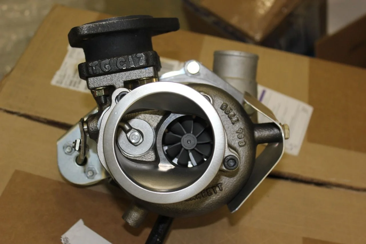

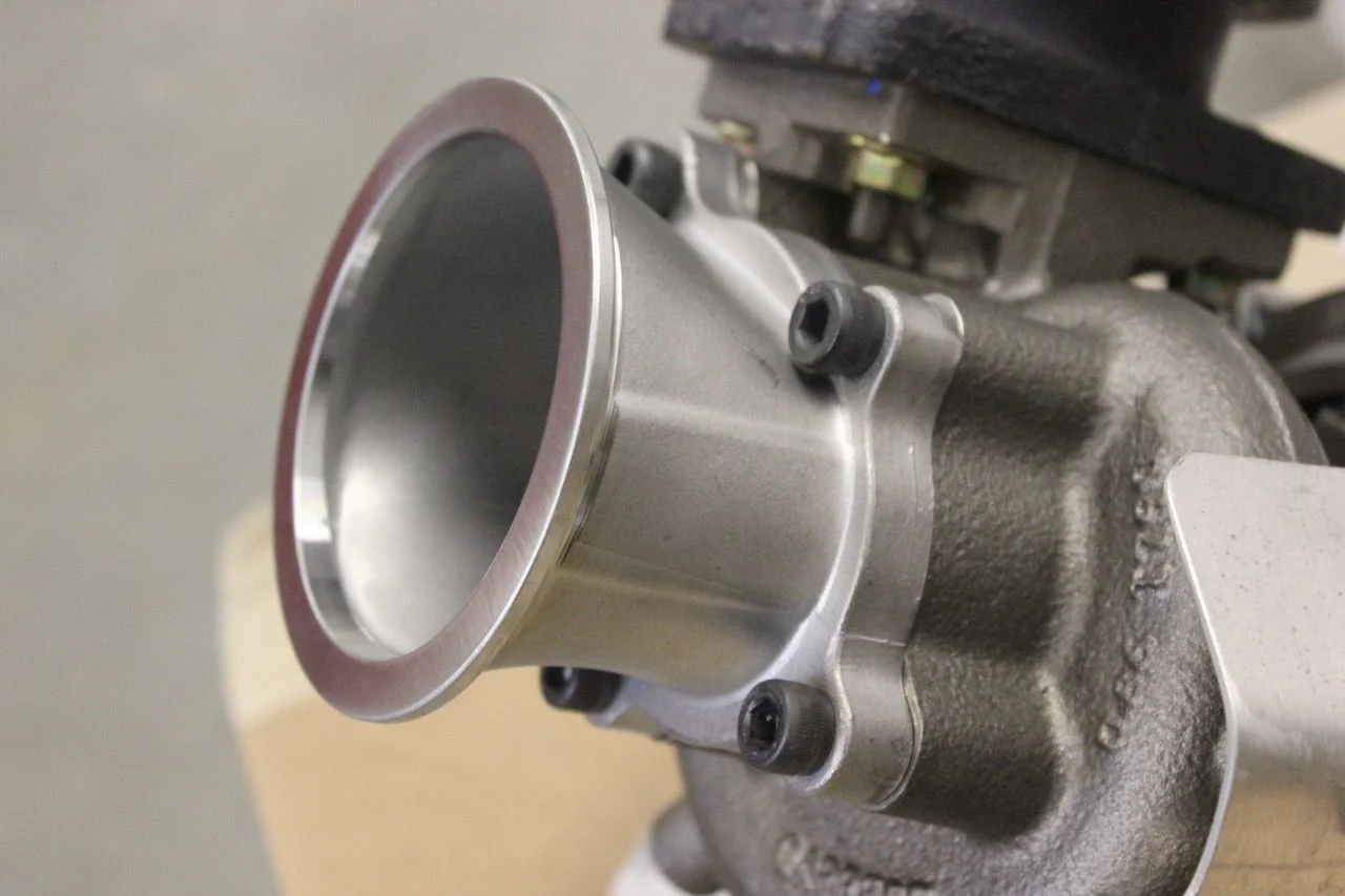

And while that is all cool and stuff, here's the most amazing part of the exhaust. I had no idea this would be as nice as it is when I ordered it.
I'll give as big of a thumbs up to ATP TURBO - The Premiere Provider of Turbocharging Components as possible for this thing (this is the ATP-FLS-023). I'll translate that part number: It's a turbo exhaust to 3" V Band adapter for the GT28 Turbo that Turboglide uses, all stainless steel.

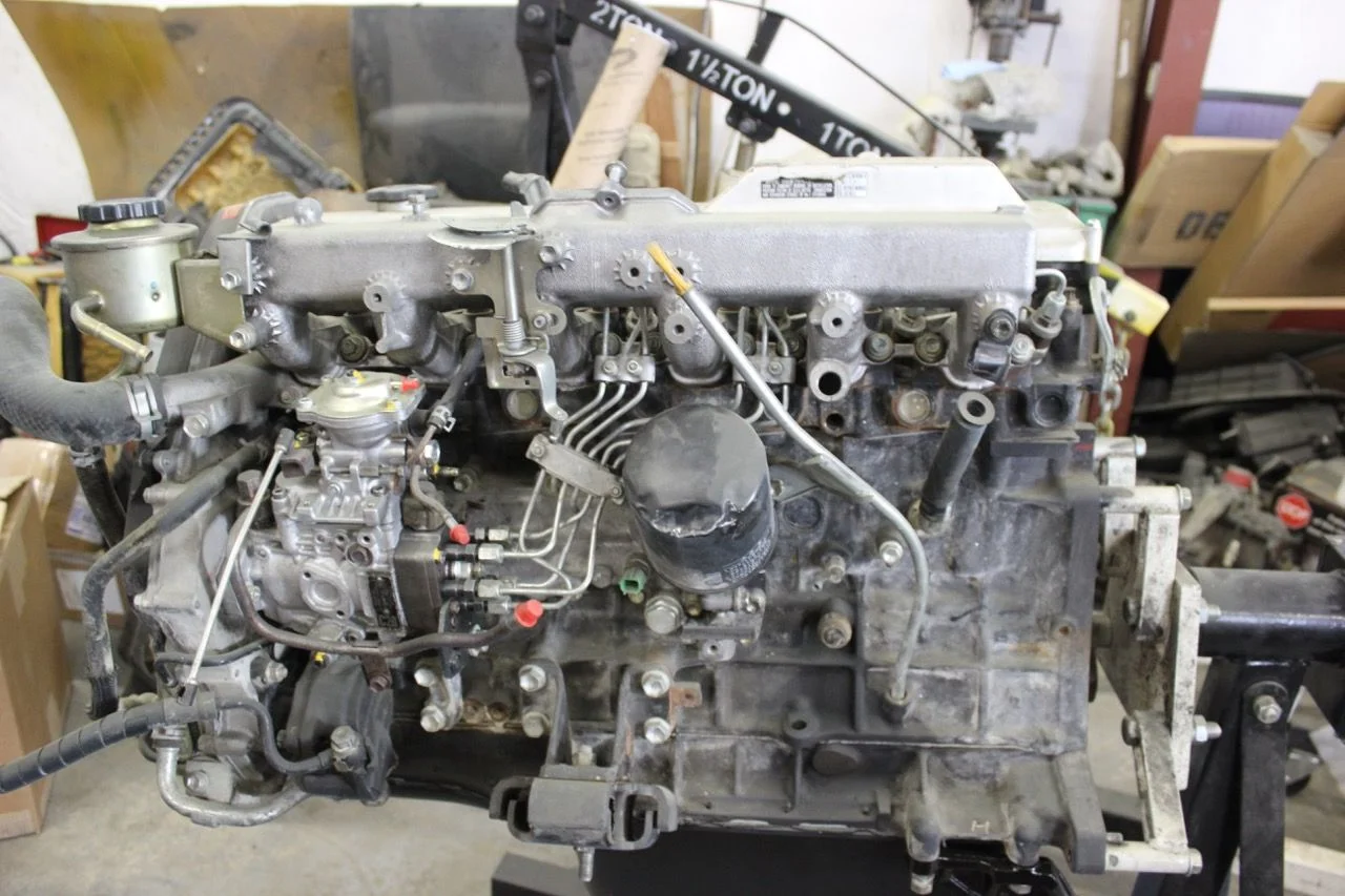

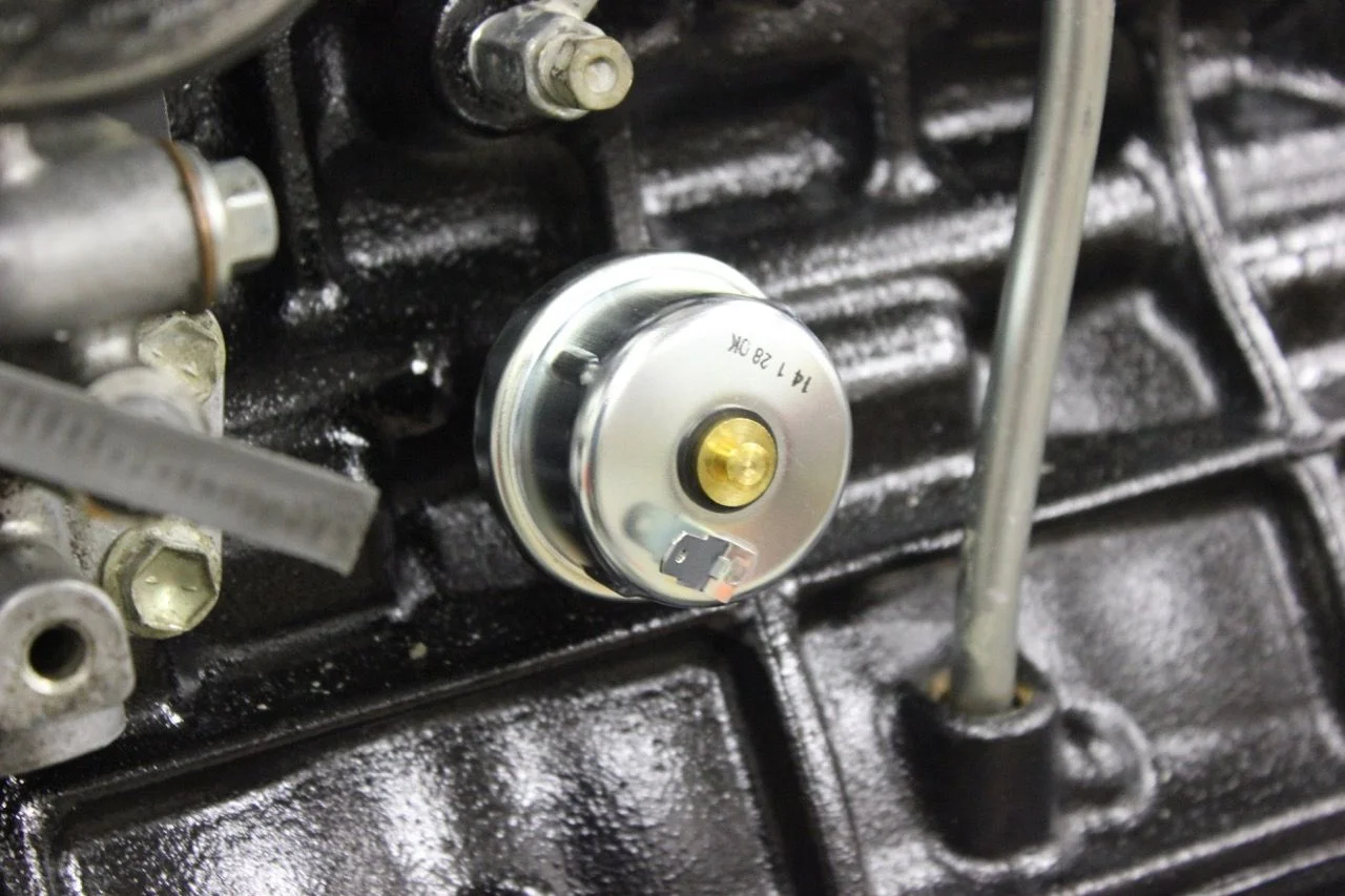

Another thing I did was strip the left side of the engine, clean it, paint it, and put it back together with new seals.
Before:
Good news when I removed the oil cooler! Not bad looking in there. Which is probably the healthiest mine engine I have ever seen opened up.
And here's an "after" pic:
And the new oil pressure sender looks so incredibly sexy on there!
