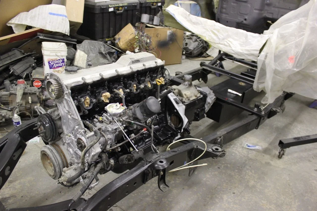

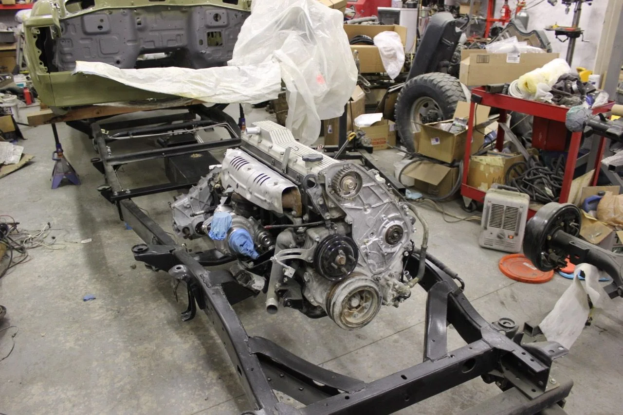

And with that clutch installed, we mated the transmission/Tcase assembly to the engine, and put the whole thing into the frame!

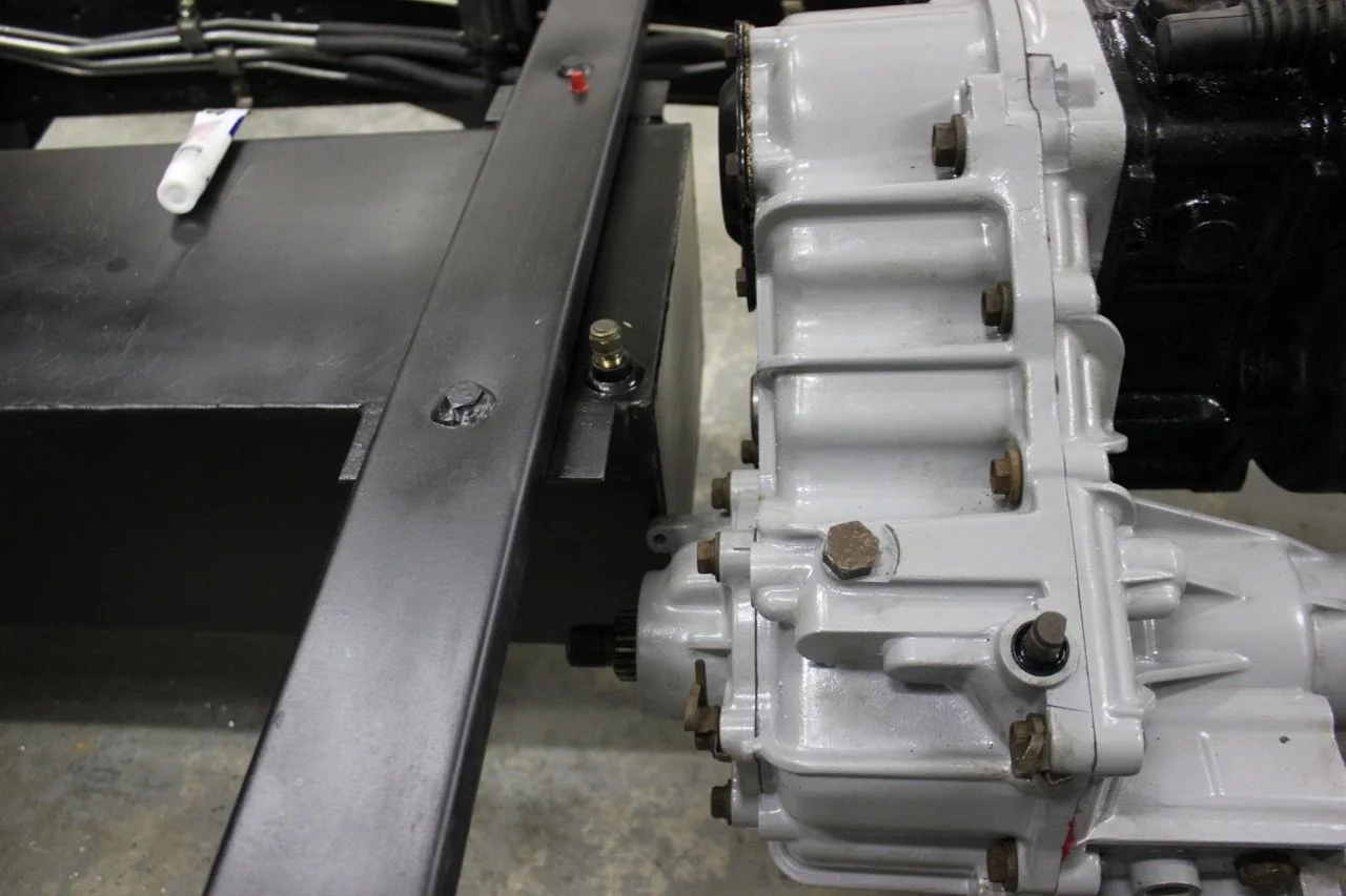

And here's the left side...

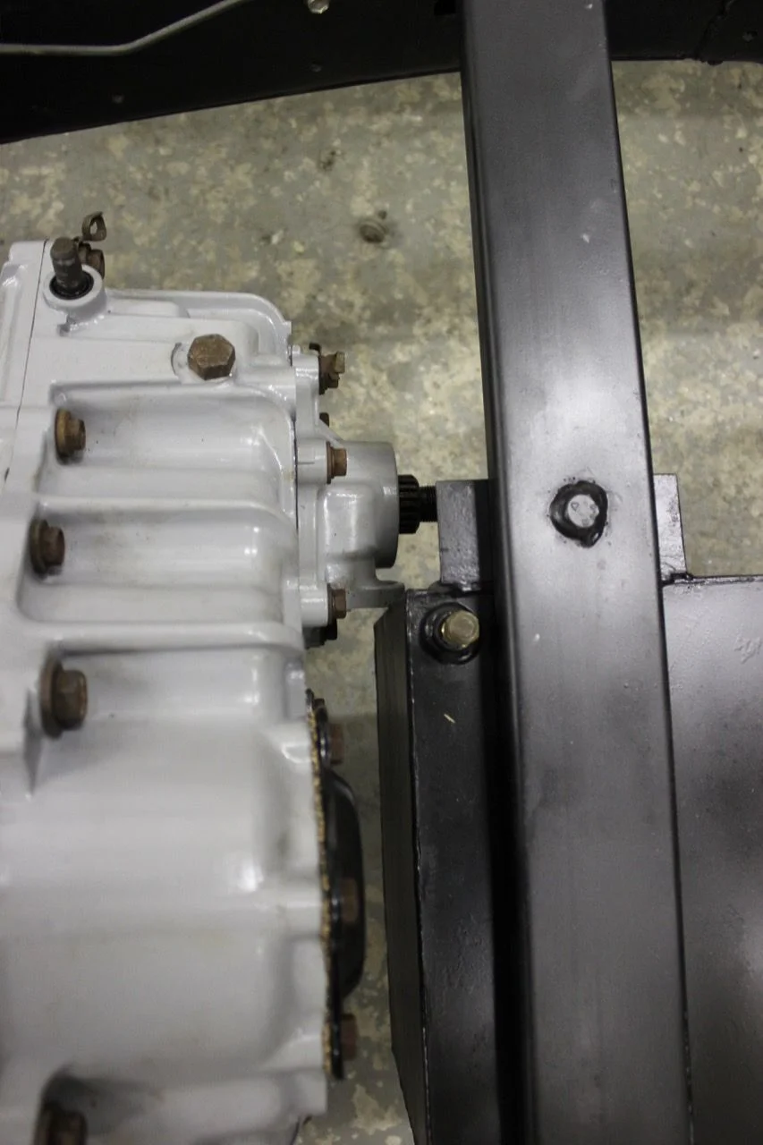

And here's how tight the T-case is to the aux tank. I need to move the tank back a little bit. Maybe 1/2" or so. Not entirely sure how I'm going to do that just yet, but I will.
I also put the turbo on the manifold, to take a good look at how much room I have to work with...

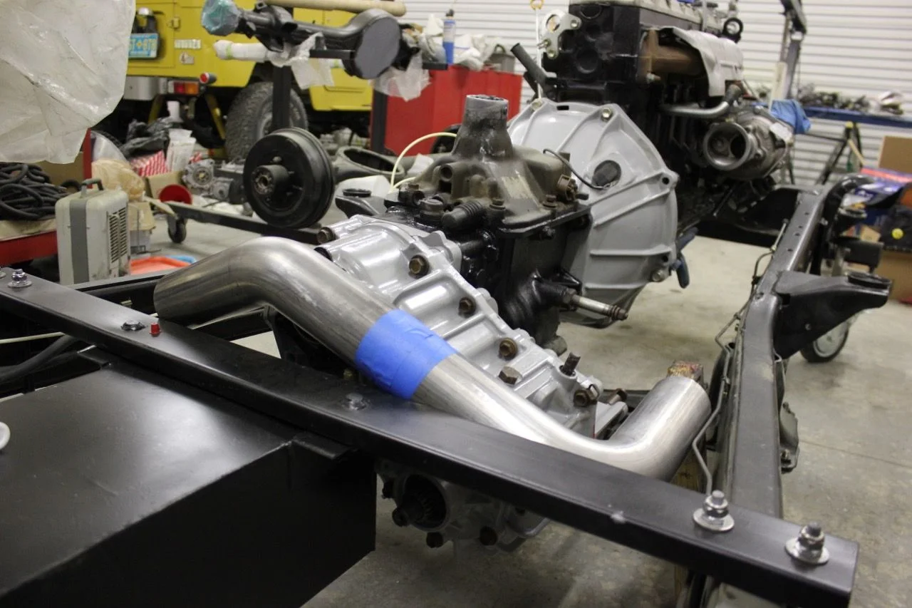

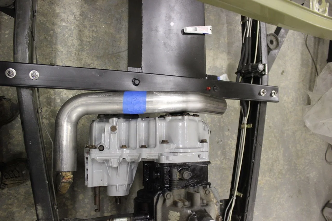

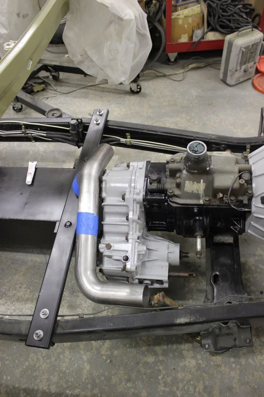

...and then I started mocking up the exhaust. To see if this will work. Not entirely sure that it will, but I'm going to mock up what I can to take a good look at it.
More mocking up of the exhaust. It will be tight, for sure. But I'm thinking this will work. I am maybe regretting going to 3 inch exhaust. This would be much easier with 2.5 inch.
What say you all? I will most likely shorten the leg going immediately out of the turbo, and add a little straight pipe between the 90 degree bend that goes over the T-case and the 45 degree kick up towards the turbo. That's easy enough, and will move the exhaust a little way away from the firewall. On second thought, maybe I want to have it close to the firewall so the passenger :princess: feet are nice and toasty... ;)

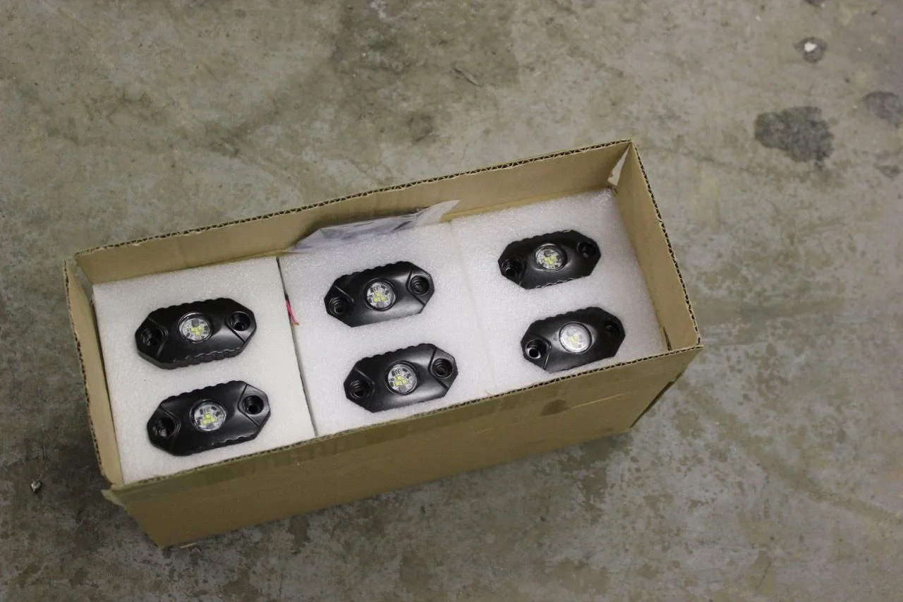

I figure I ought to stop teasing and show some of the goodies that were in those boxes....
Rock lights!

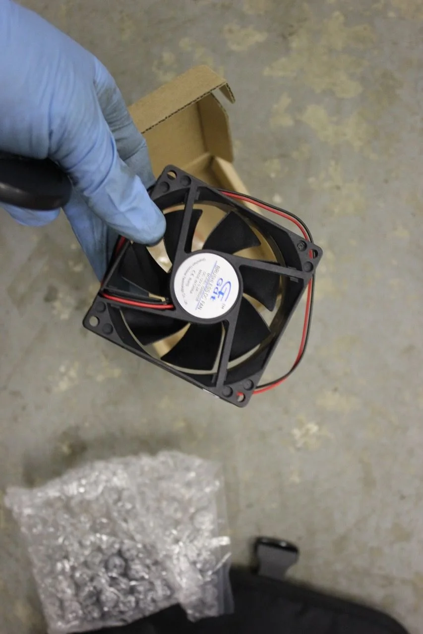

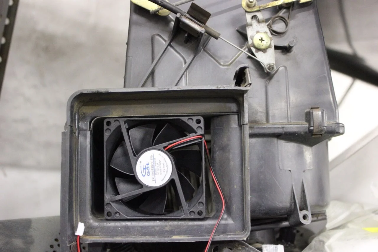

A small (efficient) fan!
Why, you might ask?
That way, when the webasto is running, that little fan (which draws about 0.5A, and flows maybe 1/3 or 1/2 of the air the blower does, from what I gather) can run, instead of the squirrel cage blower. So that the truck can be defrosted and at least a little warm.

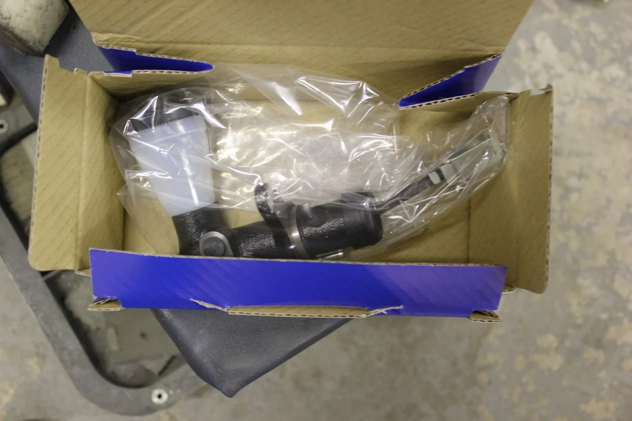

And the last one is the Aisin Clutch Master.

As for the exhaust, why are you crossing over to the driver side? Looks like you have plenty of room to run it down and out on the passenger side.
also interested to know why you are crossing over to the other side. Maybe its obvious with the cab back on? seems like it would really heat soak the floor and maybe even the transmission with the way its routed now. Would it give you any additional clearance to order and utilize some of that 3'' oval shaped pipe?
The reason I was planning on crossing over was to move the exhaust away from the brake line. I figure warming up the fuel lines isn't so bad.
But I suppose I could pretty easily run the exhaust along the right frame rail next to the driveshaft.
I'm not sure if I could fit a muffler in next to the DS though....
Dan
Even if you cross over behind the split case, you're going to be putting significant heat into the brake and fuel lines between the turbo outlet and the transfer case.
img_3202-jpg.1190853
I think it's a better plan to keep the exhaust on the PS and wrap it in header wrap all the way back, or at least to the tailpipe. If you need to cross over for the muffler, you can do it behind the aux fuel tank.
Makes sense.
I'll mock that up next time I'm back at the truck--later this month.
If I go the distance on the right side, I'll just keep it on the right all the way to the exit. Once it passes over the axle (immediately after the auxiliary tank) it's just going out the exhaust tip.
I can probably make an aluminum heat shield for the brake line if it becomes an issue I guess.
Dan
I agree and remember you're going to have to we get that pipe on and off again from time to time with the body in place. Whenever possible I try keep extra room around things because you never know when you need to get your hand up in there to do something.
Maybe you can get it ceramic coated to reflect more heat back to the inside of the pipe.
Pete
We ran our exhaust on the passenger side. Plenty of room but I am tight where we installed the long range fuel tank.
Have a 90 HDT-1 with it's 5 speed in my 60.
I moved my brake and fuel lines to the driver side because that's where the feed and return are on my motor, but the concept is the same. You can see the downpipe wrap in the top picture.
I was going to ask why you were crossing over with the exhaust as well, but looks like I'm late to the party, lol. Cool idea with the computer fan for the webasto, interested to see how well that works for you.
Having the brake line on the passenger side of a LHD 60 makes no sense! Put the brake line on the other side, there's tons of room and lots of factory captive nuts (from the passenger side 2F exhaust brackets you aren't using) to secure it with nice clips, OE-style. I would still wrap the exhaust and heat shield it between it and the floor and fuel line though, don't want to melt your undercoating.
wrapping the exhaust will just be a moisture and dirt trap for an offroad rig. I doubt the exhaust is going to build any significant heat anyway being 3'' in diameter and especially if you decide to run no muffler. my 61 sounds amazing with no muffler. Since you are making fuel lines and such I agree would be easy enough to redo your brake lines and run them on the driver side since the master is on that side anyway.
Disagree. The exhaust will be 1000* or more coming out of the turbo (depending on his tune). Dirt isn't an issue and moisture will burn off really quick.
Muffler is up to personal preference, but wrap is a good idea.
the exhaust will be that hot directly after the turbo not the exhaust pipe. Even with extended drives pulling long hills the pipe will not get anywhere near 1k degrees.
Sure it will. Pyro temps into the turbo can be as hot as 1400* and there's only a 2-300* drop through the turbine housing. That means that exhaust gas enters the exhaust pipe at ~1000*.
Will the exhaust reach 1000* while driving? Maybe not, but I would expect at least 800*, which would still boil brake fluid.
Wrap the exhaust.
