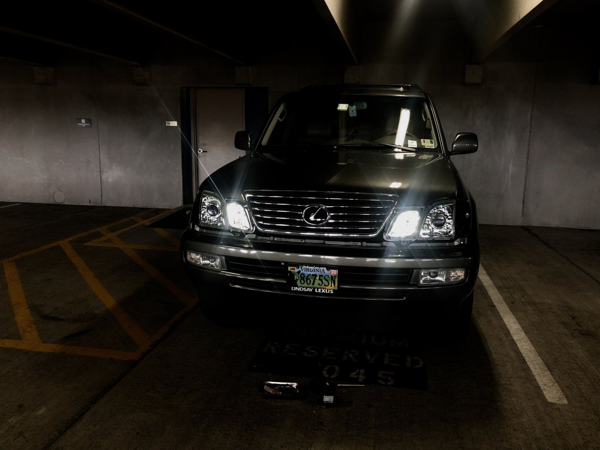

On my LX470, I have Morimoto H1 2Stroke in mine and like them very much! I also put a set of the 9005 2Strokes in the HiBeam location but am having a problem with the PS one flickering and off/on deal, not sure why or what is going on with it.
The thread started with a replacement LED for the high beam location which will not operate as a DRL. We are working on a harness to make that possible with the Morimoto 2Stroke LED. The harness works for those who have retrofitted the low beam with a HID projector and we plan on testing this with a Halogen bulb in the low beam.
As @TXLX100 stated it's extremely unsafe for other drivers to run a LED in the low beam location unless you have a projector like the LX. I have not tested them in the Low Beam side of the LX but when TRS did a comparison they installed them in a projector and got the clean cut off like an HID. @LXstatic you should post some output shots of your low beam and we should have a fix for that flickering and DRL/high beam soon

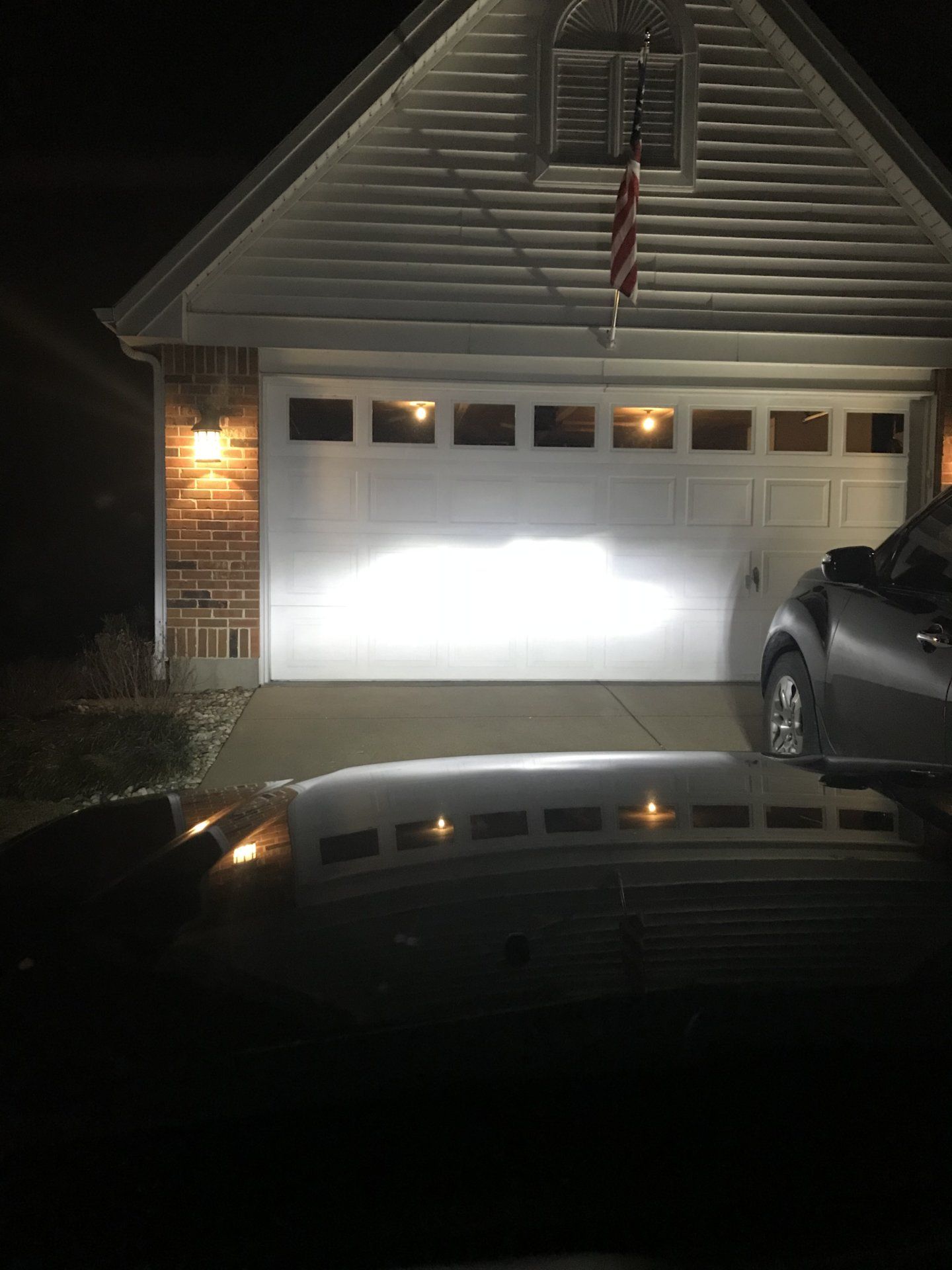

Morimoto D2S Low and high beam
1921431
1921432
Ok will do. Yes, I want to do a full retrofit but a little tight on funds right now... @Luke111 do you have a price for a set of the glass lenses with low beam retrofit? Which one is better the miniH1 or the D2S?
The D2S has the greater output... Full plug and play retrofitted into new OEM housings run $825.00 per side . For the LC crowd I may be offering DEPOs retrofitted with the D2S very soon.... when combined with the 2Stroke in the high beam you're looking at a pretty intense output and your DRL's will be LED
