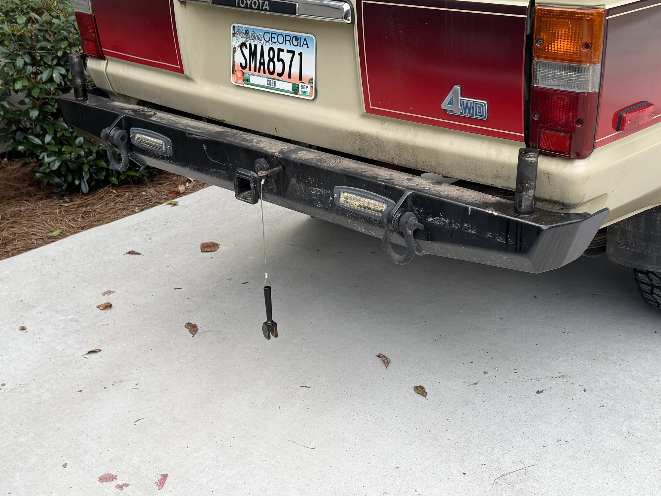

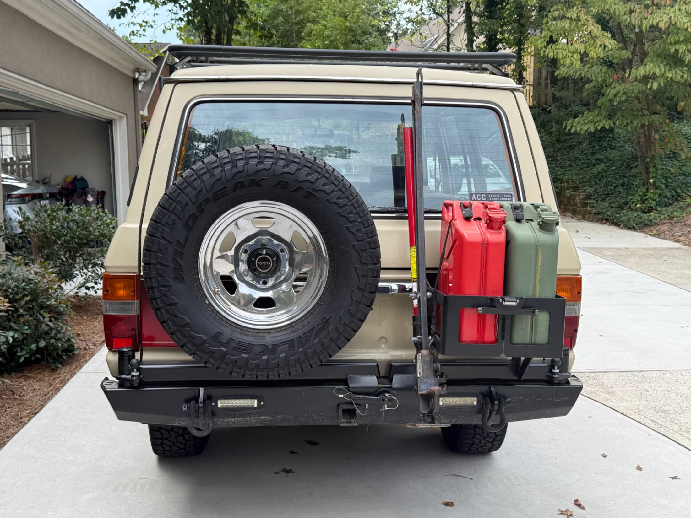

I got my new-to-me 60 last weekend and it came with a 4+ rear bumper installed. The swing arms are almost completely siezed and it’s nearly impossible to get into the rear cargo area.
I got the weather caps off and I’ve been trying to get the swing arms off so I can lube/replace the bushings (or perhaps just leave them off). I’ve been working for two days to get them off the bumper spindles and I’m stumped. I’ve emailed the manufacturer with no response. So two questions:
1) during installation, is there a particular orientation that lets the arms drop onto the spindles? Is there some sort of interior keyway feature that prevents them from coming off or are they just smooth spindles?

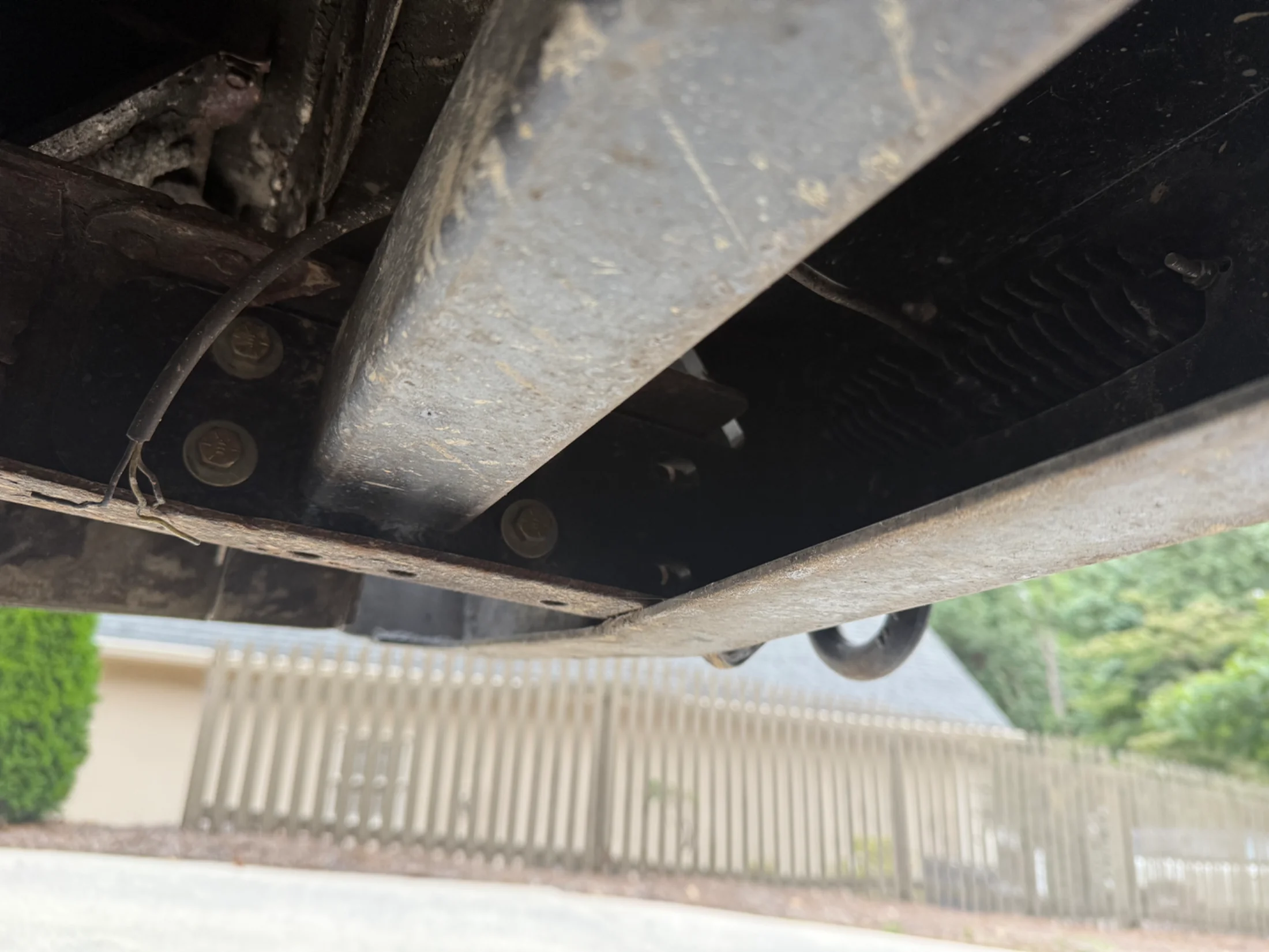

2) was there a crossmember between the frame rails that was removed, and do I need to find a replacement if I go back to a stock bumper?
Pictures for reference, thanks.
The swing arms just slide down on the spindles. Remove the tire, hi-lift jack, and fuel cans from the swing arms then take the hi-lift and use it to jack up the arms as near the spindle as you can get.
A cross-member has to to be removed to mount the 4+ bumper, so if you remove the 4+ you'll need to source a good cross-member to remount a stock bumper.

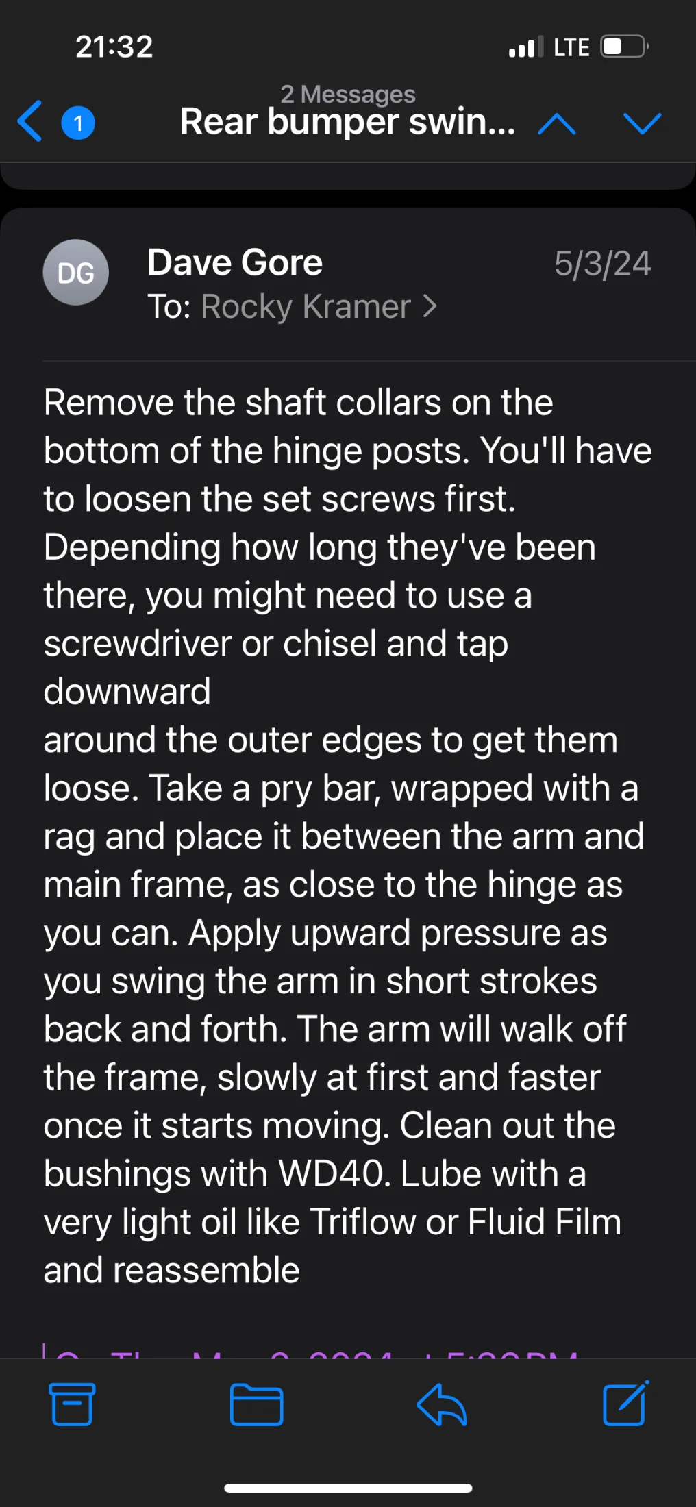

This is helpful, but I don’t see any shaft collars at the bottom? The weather caps at the top have a set screw and I’ve already removed those, is that what he means?
Also, I’ve tried the pry bar and rock technique with no luck. These things are bound on there VERY tightly. It takes almost all of my strength to swing them an inch, and I’m a pretty big/strong guy.
The 40 series design is a little different than yours mine have the collars on the bottom (see attached photo).
But should be the same concept for removing the arms? Mine was also very hard to move back and forth but once it started move up a little it got easier. You might try reaching out to them again and see if there’s a different option for the 60 models.

Thanks! I also thought about installing a grease zerk, but in the thread linked above the manufacturer recommends against using grease with these because it interferes with the bearing clearance and the lubrication (ha!) impregnated in the bearings. He recommends only using light oil like 3-in-1.
