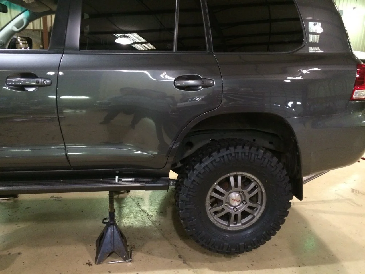

Of those, I'd pick the forged 18" TRD rims. Though as you say they won't push the rims out (which I see as a positive). That said, having just made this decision a few months ago, I'd go with Rock Warriors (as I did). I think forged, 23.5 lbs, OEM wheels can't really be beat.

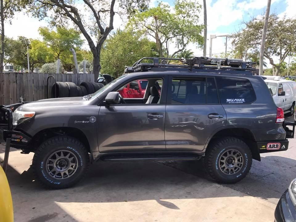

I’d go TRD Rock Warrior, then Evo Corse, otherwise stock, in that order. TRD Rock Warriors are the 1st choice of almost anyone with a 200 for many reasons.
