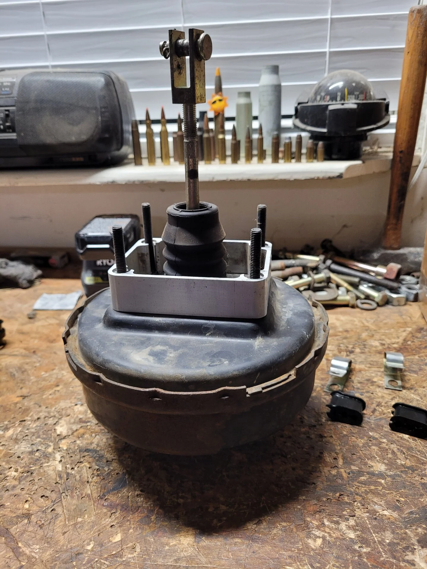

So I'm redoing the brake system on my '83 short bed, upgrading to V6 fronts and stock disc rears, and I purchased a T100 (advertised as fitting V6 early 4runners, pickups) double brake booster to go with the new 1" MC. Does not want to fit. The thread studs are much too short to fit through the firewall and have any standoff away from the firewall, which doesn't allow any room for the steering shaft. What booster have you guys used successfully? Thanks!

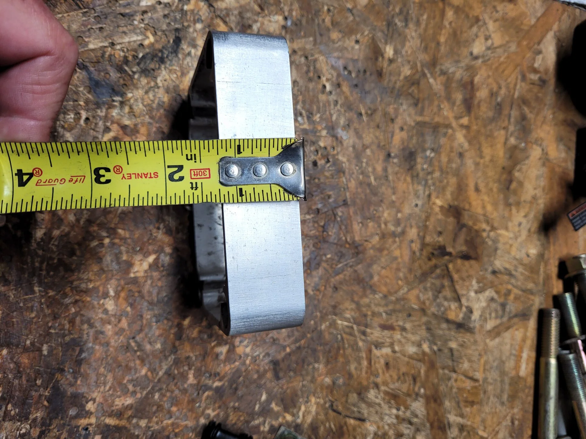

It seems the spacer is to give the booster outward clearance from the firewall for the steering shaft to slide under it.
In my interweb searches it seems that if the larger V6 calipers are used with the stock booster and upgraded 1"MC, the brake pedal pressure sucks. I hoped to use the double booster to get good brake pedal feel, but the diameter of the later brake booster is significantly larger as well. If there was a double booster with longer studs it might work, but not sure what year/model would be compatible...
My advice is to use the 4rnnr V6 booster and m/c. I own one of those trucks and the brakes are the best Toyota brakes that I've ever driven. Light pedal, not terribly long stroke, and most importantly, good modulation. The only question is how to adapt the booster to the early truck. If the booster's studs are short enough it might work to use coupler nuts and some set screws to extend them.

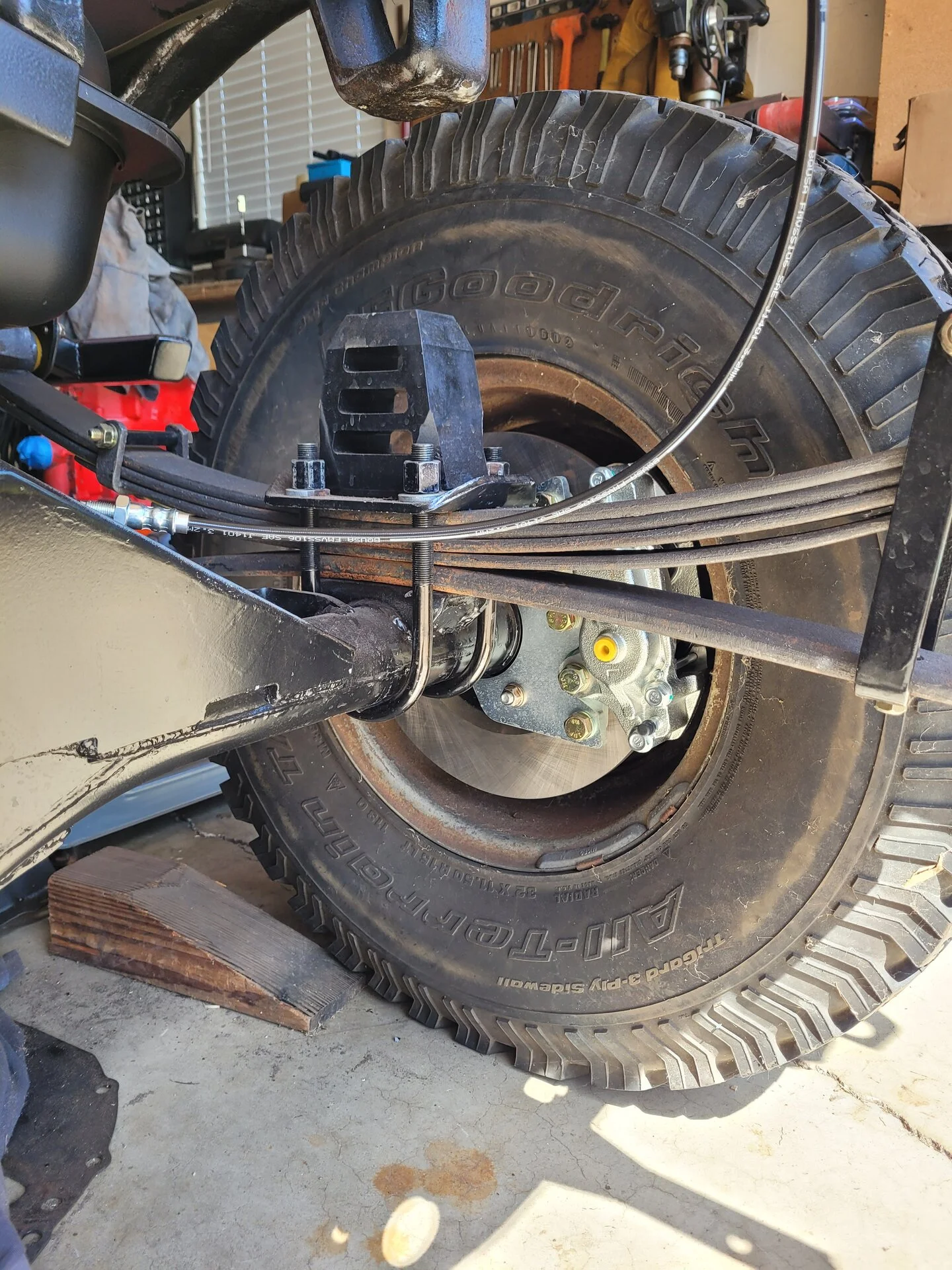

Does anyone have experience with the stock MC/Brake booster and the stock front discs and replacement rear discs? After chasing part #'s and ???'s, I've come back around to maybe just replacing the rear drums with discs, which I have already done, and keeping the stock front brake setup. I'm not running anything over 33's, and I don't recall the brakes being all that bad on the truck (although it's been 15+ years since she ran).. I'd like to upgrade the fronts to larger V6 discs, but not at the expense of a crappy pedal feel with a 1" MC, without the 2xbooster upgrade..

My only reluctance to rear disk conversions on our trucks is the parking brake. Ya, you can get a disk on the transfer case, but my experience is they don't hold. There has also been lots of noise about using Eldorado calipers, but I don't think I ever saw a functional install.
These are the stock solid front rotor and caliper. I hear ya on the parking brake, I do plan on the transfer case caliper. Interesting to hear your feedback on that.
I suspect that is going to be too much rear brake at speed. You'll end up having to crank the proportioning valve way down. There is a 2 piston caliper used on the 2WD trucks, but it is only a ~5% reduction in piston area. Not enough to make trying to get them to fit worth doing it.
It is really hard to generate enough clamp force in a mechanical caliper unless an excessively long cable pull is allowable. A drum brake is actually better suited to a parking brake type of use.
Any of those Caddy hydro-mech calipers are a waste of time. Although borderline too big for the rear of these trucks the service brake function works like it should. I've never known anyone who could keep the p-brake function working for any period of time. That includes a pretty anal Mech Engineer who wrote an article on how to make them work, and then gave up and went with the Explorer rear discs because he was always having to twiddle them to keep the Cad calipers functioning correctly. The Explorer p-brake function is a drum inside the hat of the rotor. I know of no one offering these brakes for a Toyota and that's a crime.
