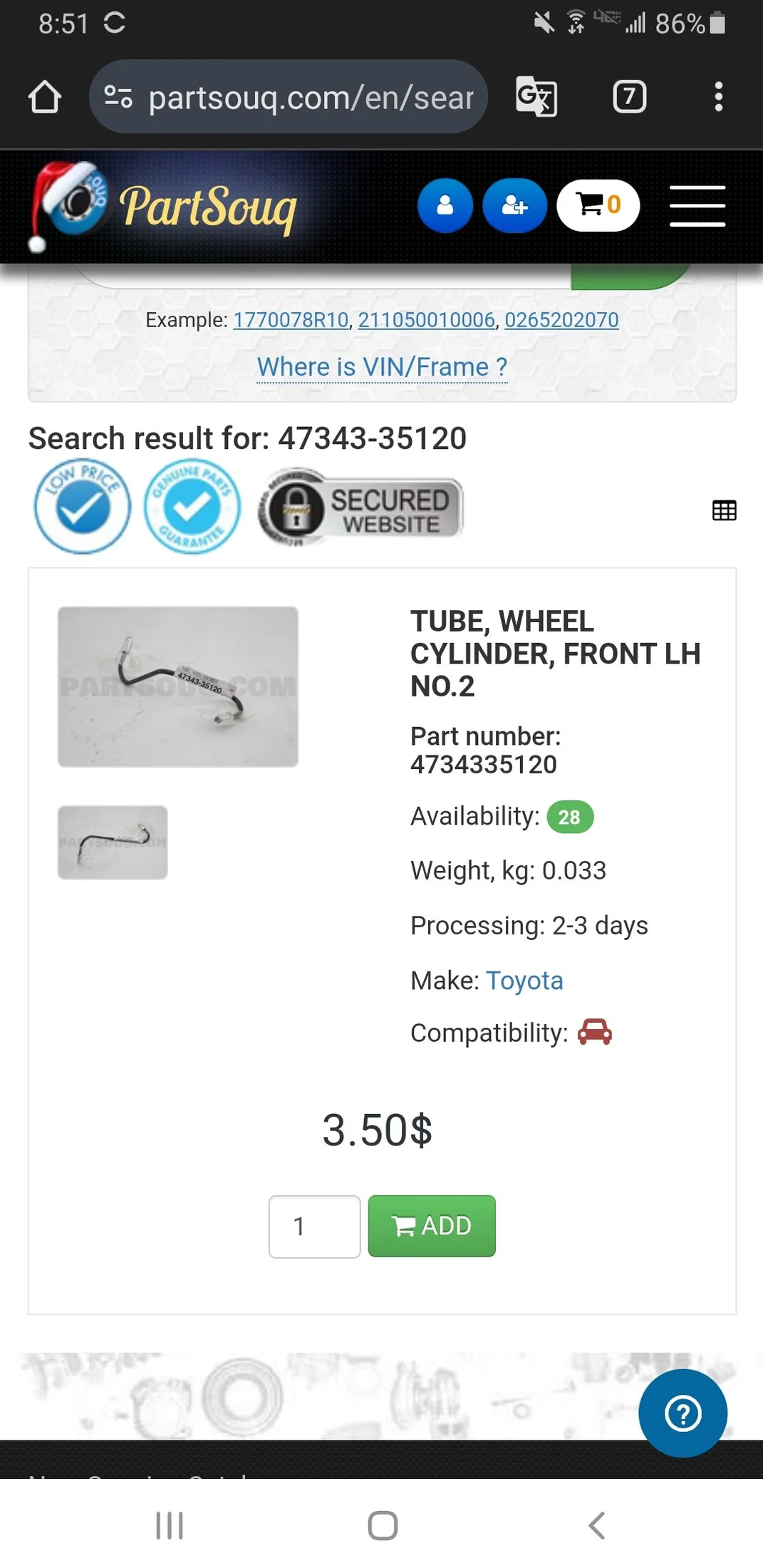

do you use Toyodiy.com or partsouq for searching parts?
appears those parts are still available. just curious where you found your nla numbers?
Damn. I did check partsouq and my search came back not available. Perhaps I was using an old, superseded part number. Thank you.
That almost looks like the whole axle line.
probably not for $3.
i used the pn from his yotamasters link.
Sorry. Typo. That looks like the line used on solid axles.
