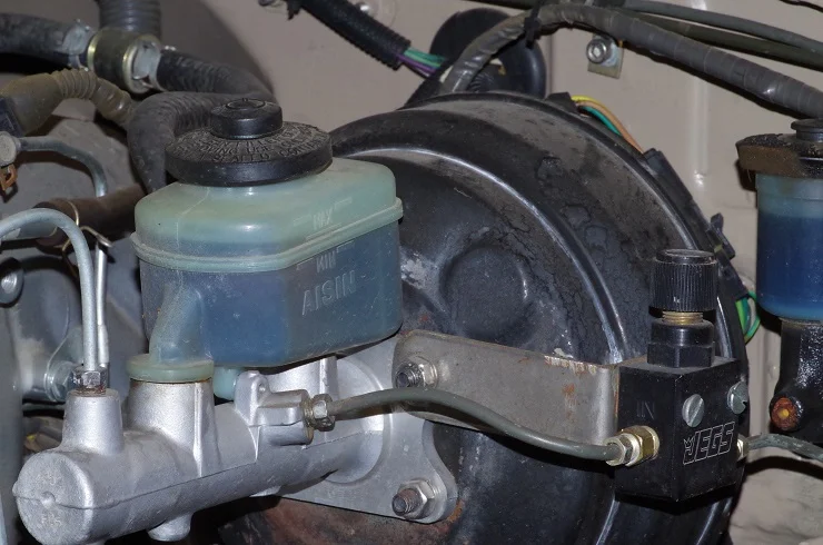

That's what you need to do when you convert to disk in the back. Here is how I did it on my FJ40.
I like that, nice and easy access. My plans were/are to use the vented larger rotors and calipers up front, and the stock solid rotor setup in the rear, along with the proportioning valve, I was thinking it might 'even' things out for brake pressure.

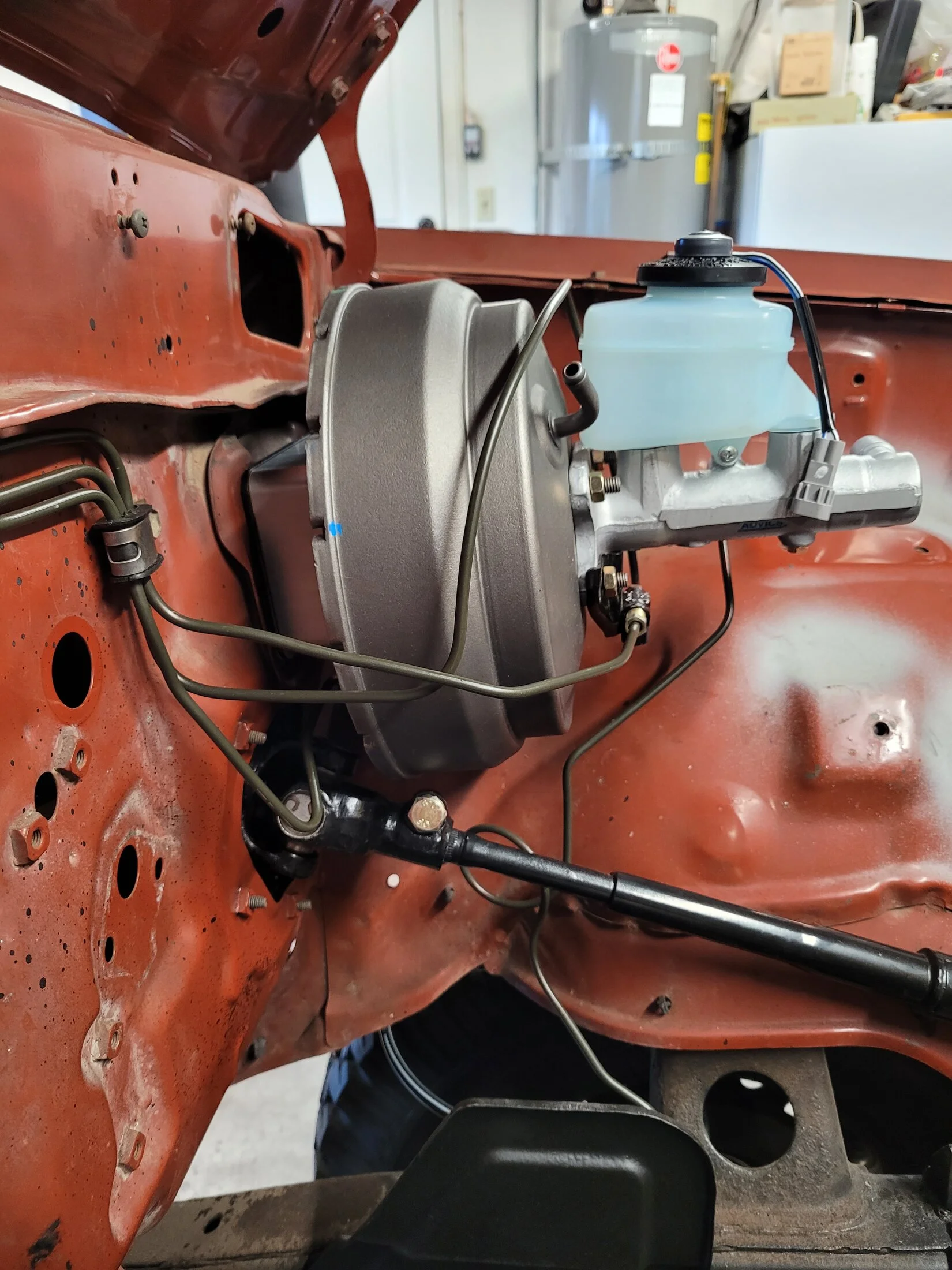

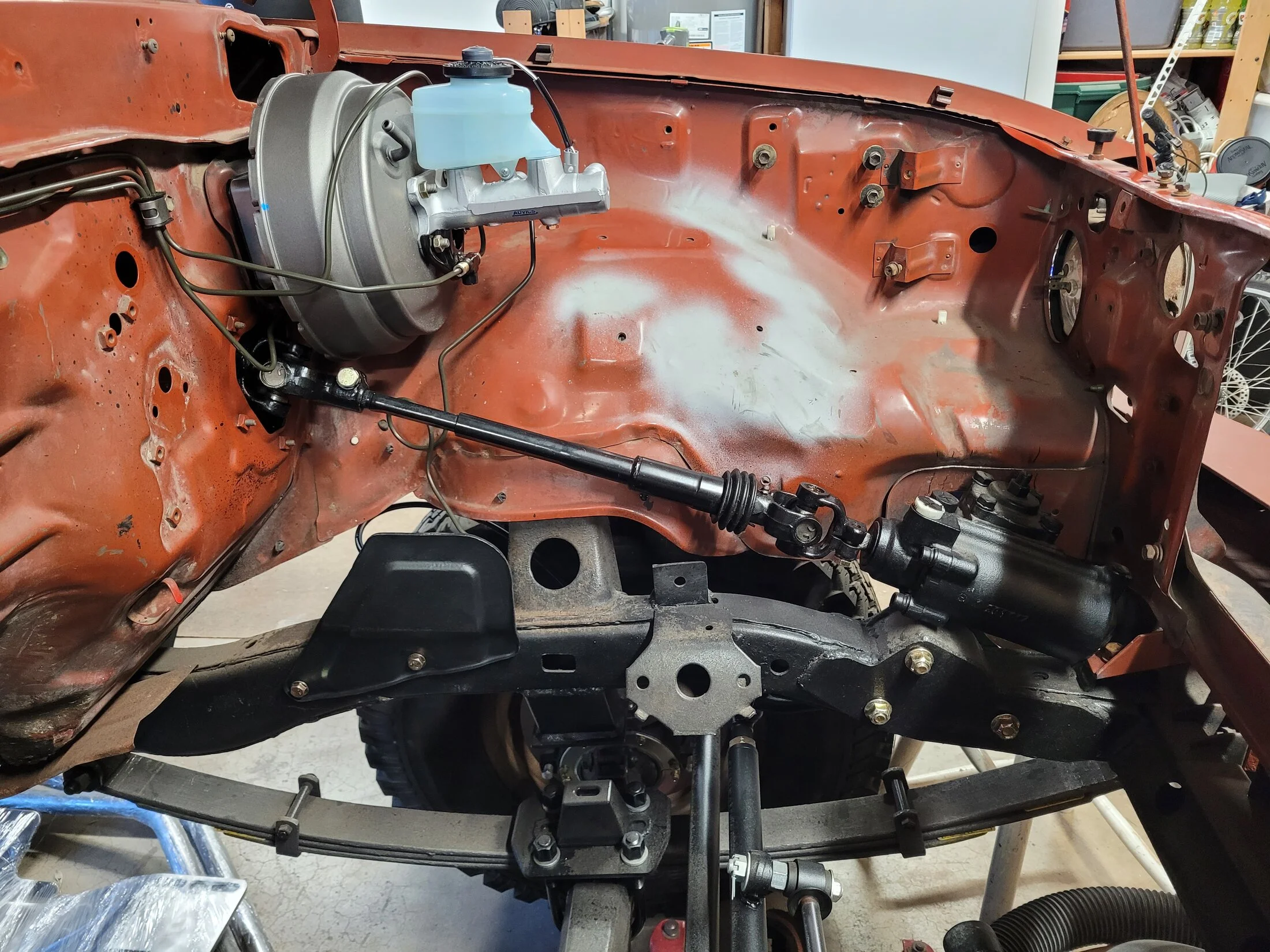

Ok, so here's the Cardone 53-2785. It fits, but it's tight! Your steering angle might be a little different, I've got it set up with crossover steering and a newer style steering box, but the angle should be relatively similar. I pre-bent all the hydraulic lines from the originals (don't laugh too loud, it's my first attempt at the miserable things), so it actually fits the stock arrangement fairly well. By the dimensions, it doesn't seem like it would be that much larger than the stock unit, overall about an inch wider in diameter, but it's just more substantial all around. As you can see, the clutch reservoir was the one hang up. I ended up bending back a tab and a half of the 'lip' on the back of the booster and it gave it just enough clearance. Not a lot of space, but it seems like it should work. Now you guys have me seriously considering going back to the stock drum/e-brake arrangement in the rear.. Does anyone have experience with the dual brake booster/1" MC combo with the slotted rotors and V6 calipers in the front/ stock drum rear?? Thanks
No experience with that. The closest that I come is the stock '88 4rnnr brakes, which are close, but not close enough.
FWIW it looks like the slip in the steering shaft might be one (?) spline off. Ideally those U-J's want to be in phase too. I hope to hell that you're never turning that shaft at the speed of a drive-shaft, so the importance is much lower. But if the steering feels a little wonky you might start there.
Everything is a 'loose fit' right now.. I plan on pulling it all and doing bodywork/paint and re-installing, but will note the splines when I reassemble for sure.

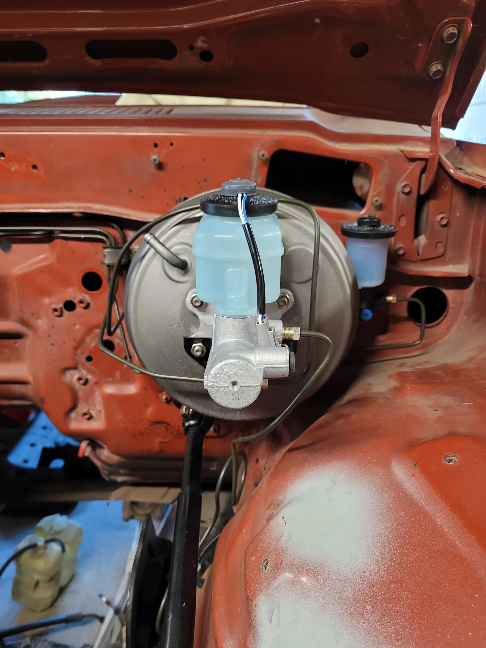

This is the common setup for those of us that have gone with FJ60 rotors, V6 calipers, and the 90-95 booster. Works just dandy.
