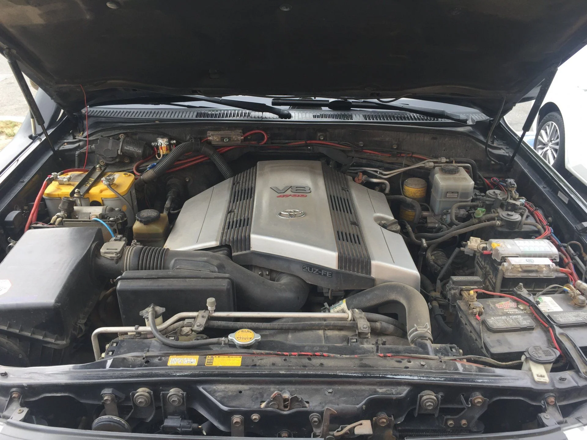

Hey Y'all,
I'm finishing up the wiring on my 100, but now that I have Slee's 2nd battery tray in with my compressor and IBS 2nd battery system, where the hell do I mount my fuse box?
Where have you guys mounted yours?
@RobRed I know you have a similar setup, where did you mount yours?

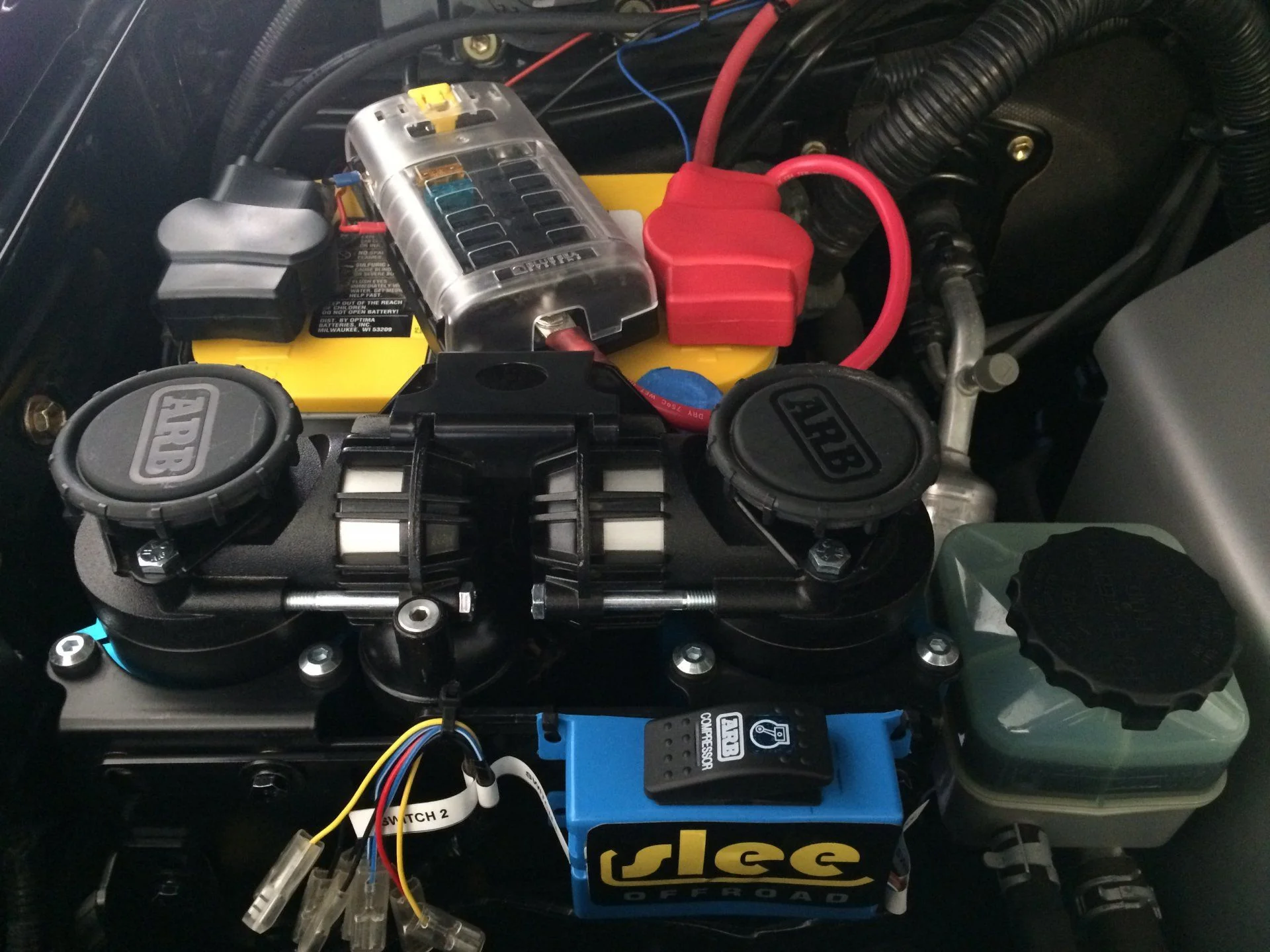

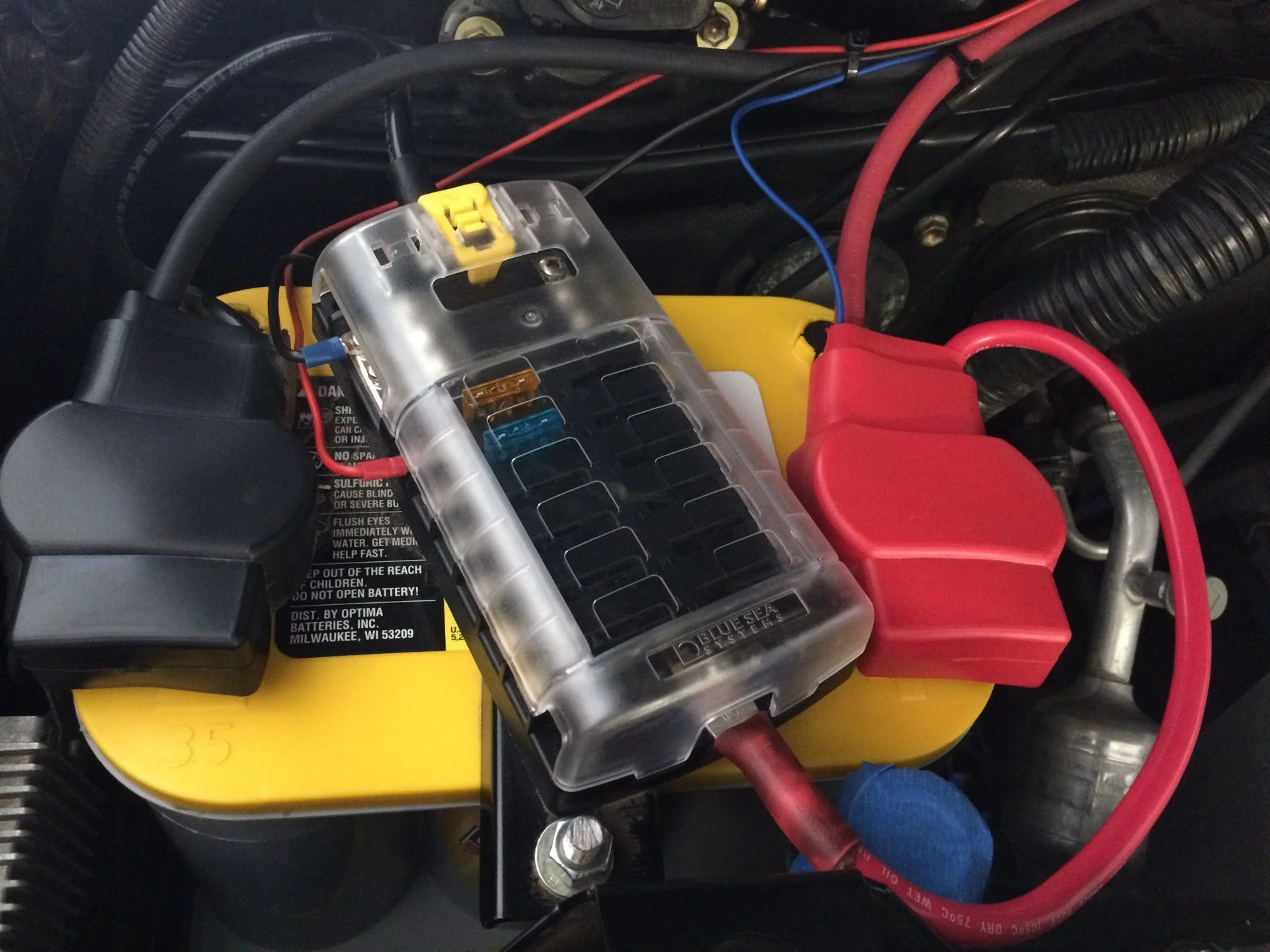

You could relocate the PS reservoir to the space between the airbox and the passenger side headlight, that's where I moved mine. That could create some room next to your second battery. I don't have a compressor in my setup but here is my second battery with a tray for my fuse box and 2 circuit breakers...
I like that setup. I was wondering where I should relocate the P/S reservoir to. That sounds like a good spot

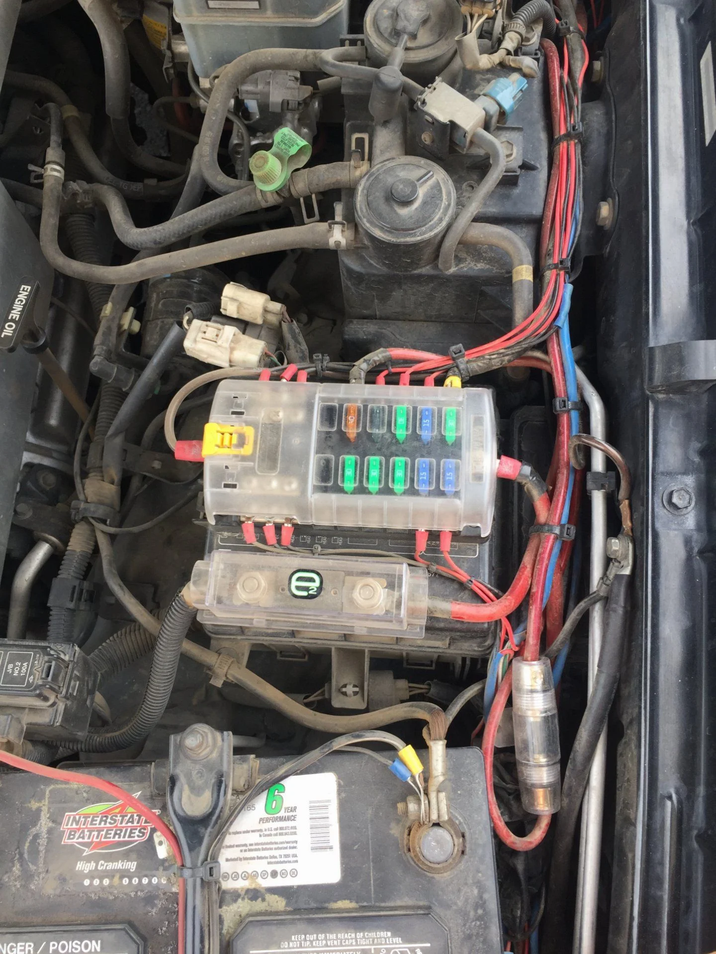

I mounted my fuse block next to my main battery because I had ran a couple thing there before I decided to get fuse block. I did run it off my aux battery, I just ran some 2 gauge wire back and forth a couple times.
That's what I've been thinking is the best idea. I didn't want to use that area in case I need to get into the main fuse box, but it seems like the best option if I want to keep it in the engine bay.
