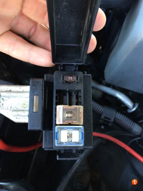

Hi All - I noticed there is an unused fuse spot in the fuse block on the battery terminal (assuming for some other model or something). I am installing an aftermarket amp for the stereo and need to wire an 8 gauge wire with a 30 amp fuse. Any reason I couldn't use this spot to wire in the amp?
Sure, I could wire an inline fuse block or something but (1) I want to keep an OEM aesthetic and (2) I come from the motorcycle world and am anal about wiring and hate the look of inline fuses.

That is exactly what I did when I installed my Nav-Delete/ stereo retrofit. Take care with the torque on the fuse block bolts… don’t want to crack the plastic fuse block.
Installed a 120A fuse in that spot to power the 1300w 5 channel amplifier... #1 AWG MTW marine application tinned copper wire with hy-press copper ring terminal at the fuse block, bullet connector at the new amp mounted under the passenger seat… All wiring in 6/6 nylon convolute split tubing. Labeled the fuse block cover with a p-touch.
Works great. Installation looks OEM.

I wanted to use the OEM fuse block as well for all the reasons stated above. But, I couldnt find a good supply of fuses that fit. They all seemed to be pretty proprietary. What did you use??
Got mine from O’Reilly auto parts… $20 at Toyota.
