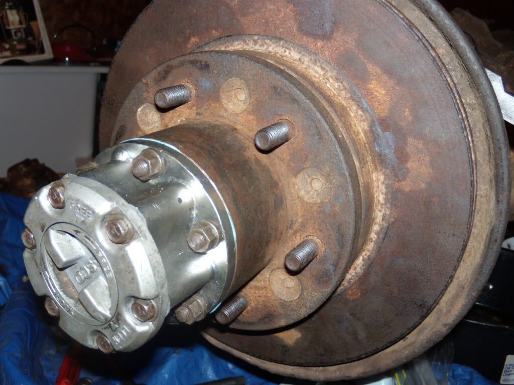

Just what it says. Have a 80 fj40, rebuilding the front axle. Rotor was cracked need a new one. Tried a couple of part stores, and the stealership and each time sent the wrong one.........is there something im missing? On my junk the rotor bolts to the hub. Every rotor i have received is missing those holes, just has the lug holes, what gives????

In a pinch you can drill the rotors, two holes should already be there
