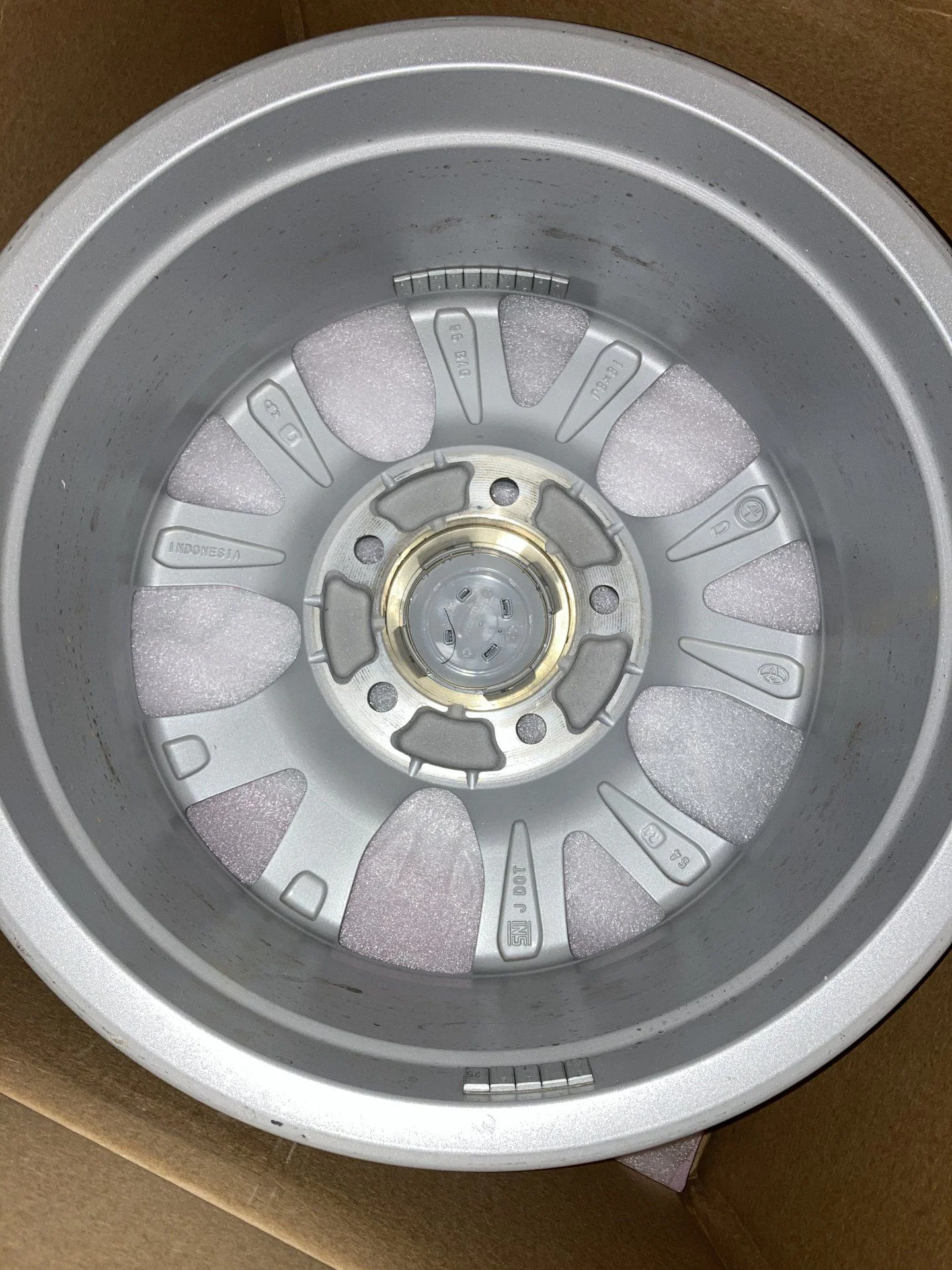

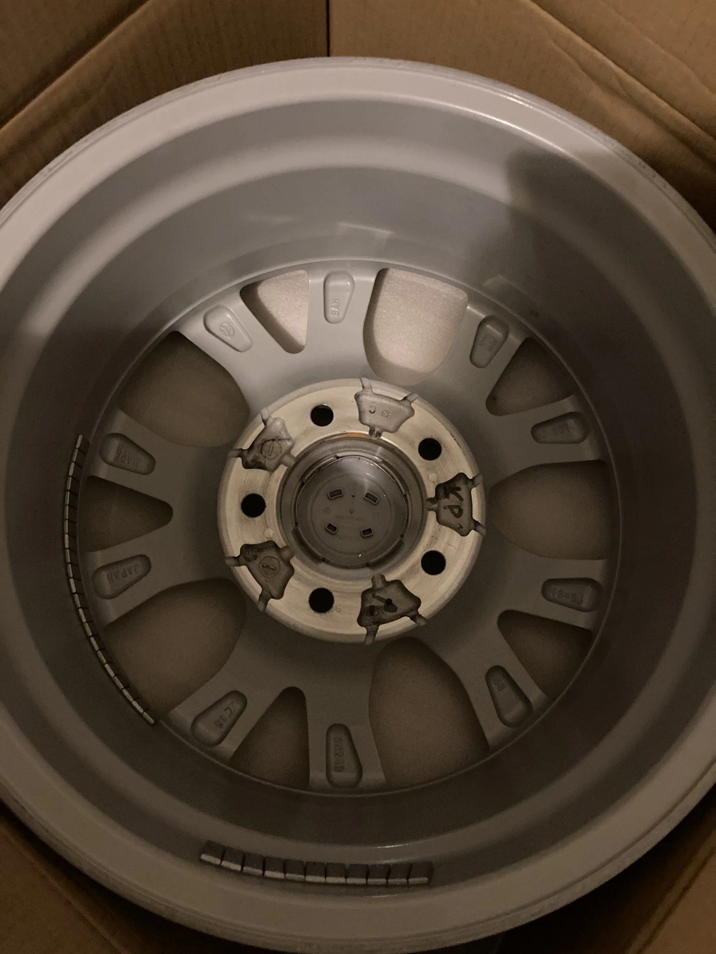

I purchased 5 oem landcruiser takeoffs from ebay. Three of the wheels have Japan stamped on the inside but two of the Indonesia? I was thinking that the wheels were all manufactured in Japan.
I don't know about where they are manufactured, but that looks like a s***-ton of weights.

Then I’d start wondering about the weights as mentioned above. A small OE size/supplier tire needing that much weight seems highly suspect.
So I guess it seems like something is not right. I am not familiar with wheels. I assumed with all the great eBay reviews that it was a good deal.
I’m no wheel balancing expert but having had tons of tires, even large ones, the top picture is more like what I’d expect of a stock tire.
That doesn’t mean it’s faulty, just makes me wonder what’s going on.
If you put tires on there and they are straight and balance up fine.. perfect.
I would think it would be the tires that needed all those weights, not the wheels.
That’s my point. Why would a stock tire that came on a new cruiser from the factory need that much weight? Clearly they just left the weights that were used to balance the tires moved to the BBS wheels but this seems odd.

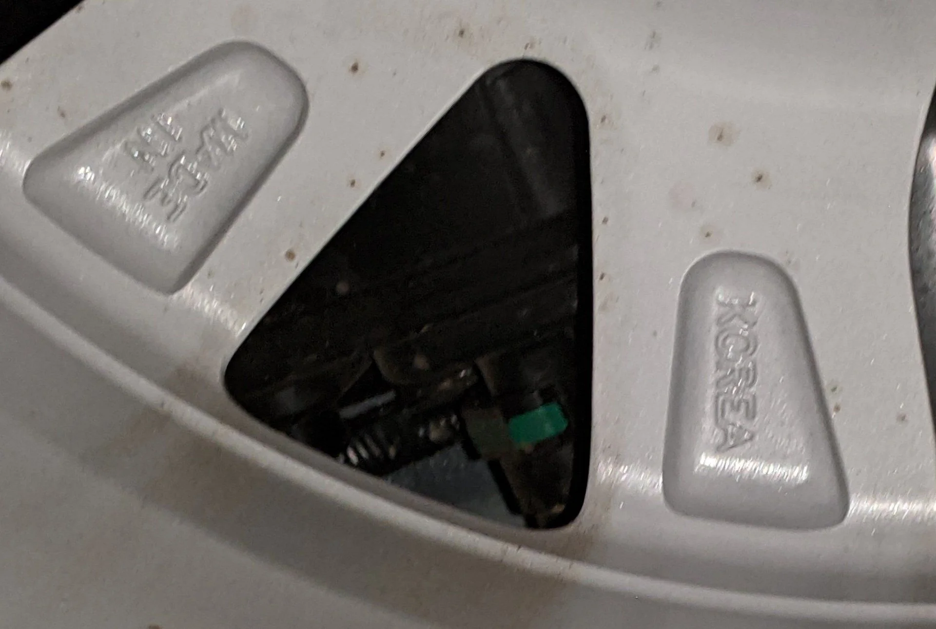

I have some Tundra 18” wheels that were made in Mexico. Others were made in Japan. Same wheel model.
I can’t speak for land cruiser wheels but Toyota uses a “getsudo” method to allocate aluminum manufacturing across multiple wheel suppliers for the Tundra and Tacoma models.
For example CAPTIN in Canada may make 60% of a certain Tundra or Tacoma wheel and the other 40% may be made by CMWA in Kentucky. They are identical but share different internal part numbers for production ordering purposes. To the customer, you can only tell by the markings in the back of the wheel.
The allocation percentages change every month too.
As for the weights. 140g or less per plane is within Toyota OEM spec for Tundra and Tacoma aluminum wheels.
For example, in the first photo the second wheel appears to show 105g on one side and 55g on the other. Would be within OEM spec for Tundra BUT whoever put them on did a crappy job on the 55g piece.

Interesting. And solves it.. thanks for the info.
Thank you for all the inputs. I feel at ease that these are legit. Even an optimistic person sometimes doubts items on ebay/amazon. Five Dollar oil filters have become knockoffs.
