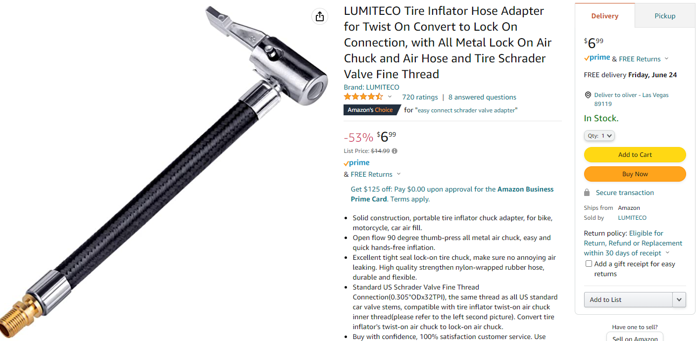

Here is a really cheap and fast way to air down.
buy 4 of these:
You can attach Staun valves (or similar) to these as well if you don't want to air down too much.
These will also attach to the screw on hoses that come with viair\smittybilt compressors to make airing up faster.
