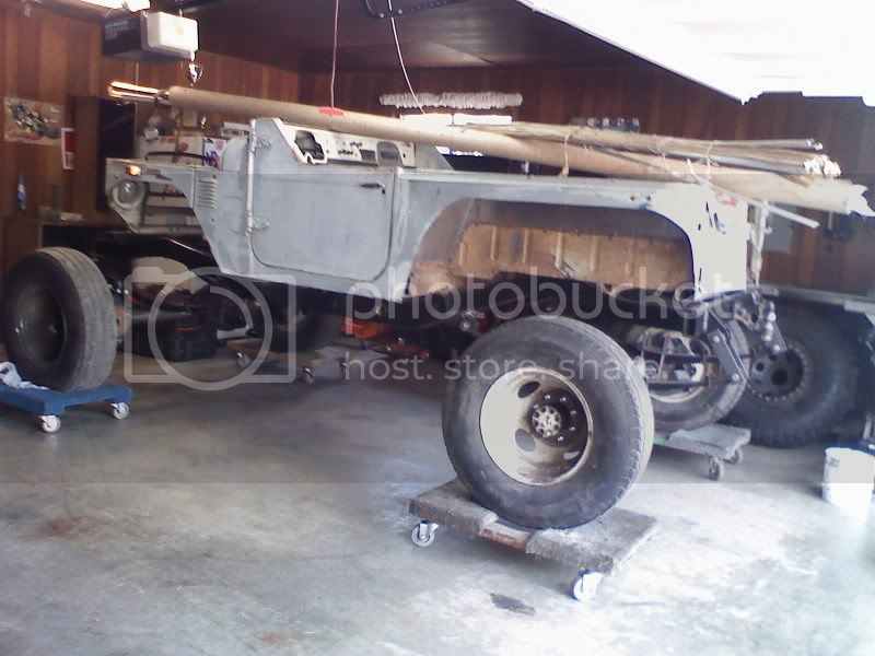

My work in progress:
The final wheelbase and ride height aren't completely fixed yet. It looks like it's going to want to sit at about a 116" wheelbase with about 26" at the belly. It's on 4 linked full width 1-tons (HP D60 front, D70U rear) with full hydro steering, and 42" IROKs. The track width is a bit on the wide side at 88". Approach and departure angles are both full 90s.
Ah, BellyDoc...I spend so little time over on the PBB, but I have followed your build thread over there. It seems I'm due for another update, as it's been a few months. That pig seems to have at least a mile of weld in it, hehe.
I used to think 116" was ridiculously long....anymore, it seems to be a nice wheelbase and there are some sweet rigs coming out in that range.
