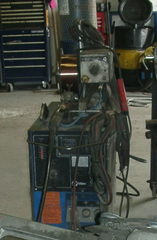

That's likely going to be my next welder. Best bang for the buck I can find. Its replacing my thousand year old Miller only because I don't have access to three phase power any more..
Not to get off-topic but if you wire in a phase converter you wouldn't need 3-phase, no? I understand they are pretty cheap and very efficient.
Yeah that's an option. $500-$800 for a converter to run a huge old welder or $800 delivered for a tiny new welder and then I can sell my old one. Seems like an easy decision when I don't need 100% duty cycle anymore.
