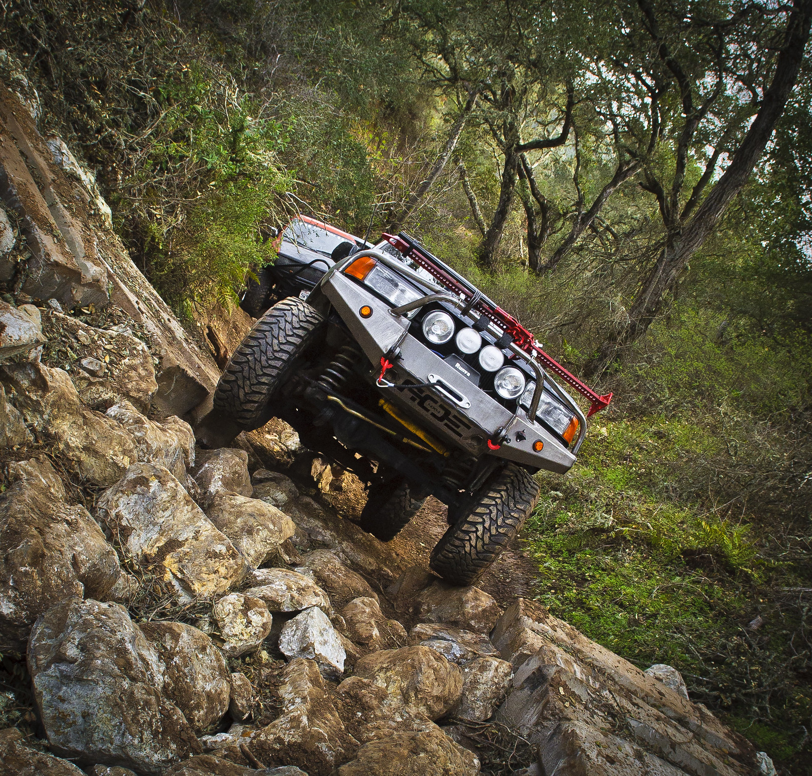

This is about as flexy as I've been able to get her while still staying upright

That was in Hollister, the "Jungle Trail".
The paint job? That's DIY ************
I've heard most people refer to that trail as "can opener" :meh: if it's the one that ends with some stepped concrete blocks and some rocks.

That's the one! No idea of it's official name, that's what all the guys were calling it so I went with that...

You might be right in calling it that. It's worse now than it was earlier this year - here's from the last time i went through it:
Um.... I've seen how you wheel Chris and while I'm not disagreeing with you I think the results of what your rig looks like afterwards will dissuade people from your method of "flex".
