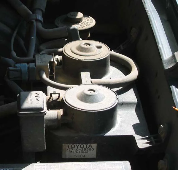

My roomate has a 1996 SR5 4runner and this little box is making a weird harmonic noise after being on for 5 minutes. More when idling. The pic show where the noise comes from. Is this something he should be concerned with? What is this box for?
Thanks for the help.
A quick search on that part number comes back charc canister assembly.
We figured that out but why would it make a whining noise after being on for awhile ? It is loud enough to hear it from inside the truck
Could be that little vaccum switch. Also, there should be more hoses than that on a typical charcoal canister, check if you have any open ports. If all else fails, take it apart and see what makes it tick.
Good luck,
Dan
Take it to your local dealer. There's a SSC (Special Service Campaign) out on that problem, they should fix it for free. Sometimes they give you a blank stare, but keep insisting, it's in the computer system on that model, I've seen it.
