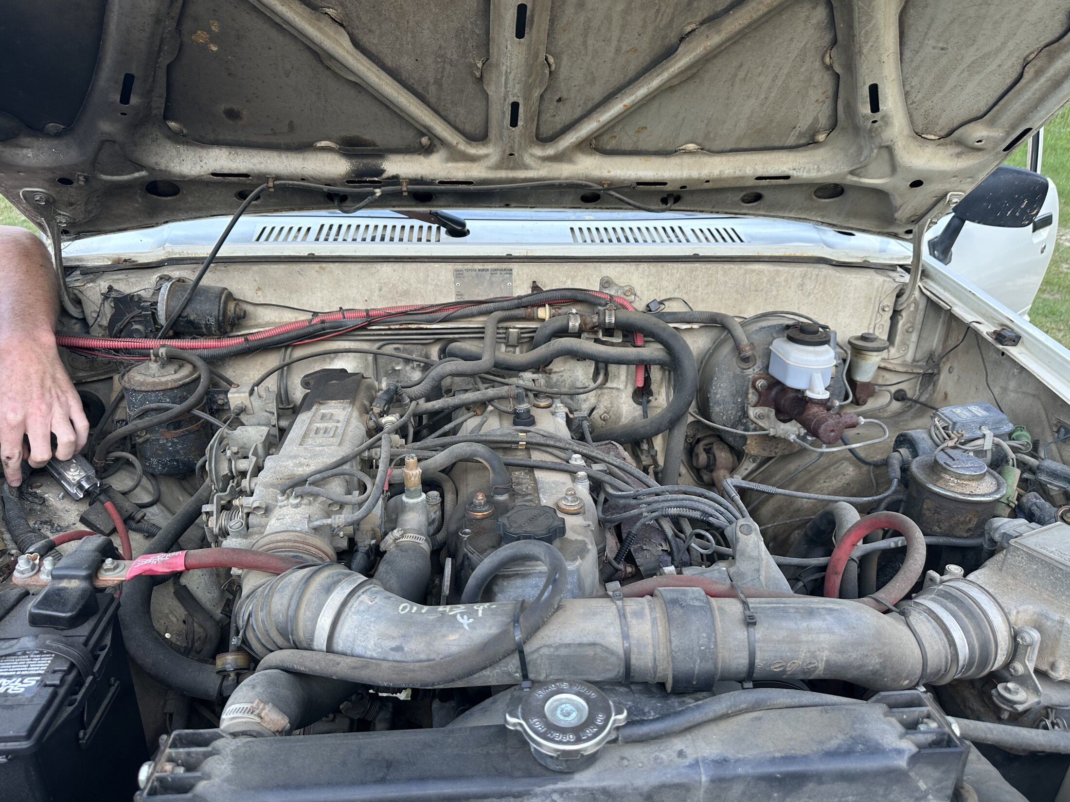

Looking at an 85 4runner near by. 230k on the 22RE. Rebuilt at 190k along with the trans. Sounds and runs good. Has oil leak maybe 1/2qt every 3000 miles.

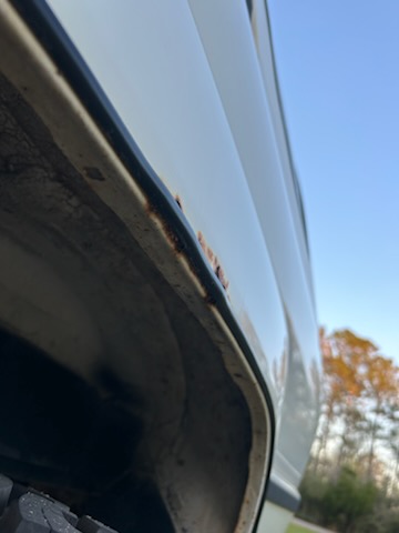

Has some rust issues but not terrible IMO. How bad does this look? The hole beside the windshield and the seam inside the drivers door jam concerns me. Top has never been off. Would you be worried about rust under the lip? Rear fender lips have some rust.

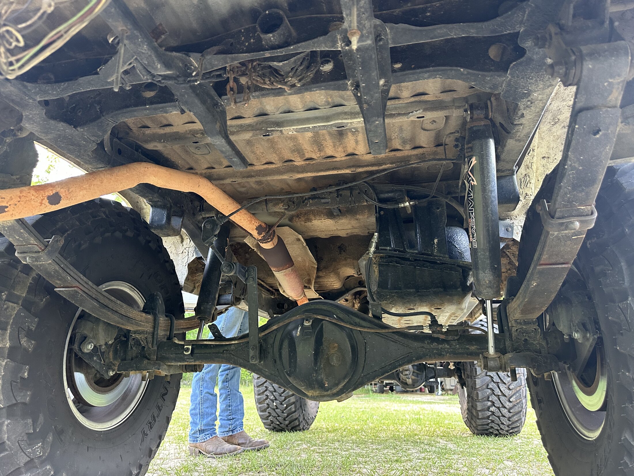

Lifted up on 37’s with 5.71’s in the rear, stock gears in the front. Said he never used 4wd and never got around to changing it out.

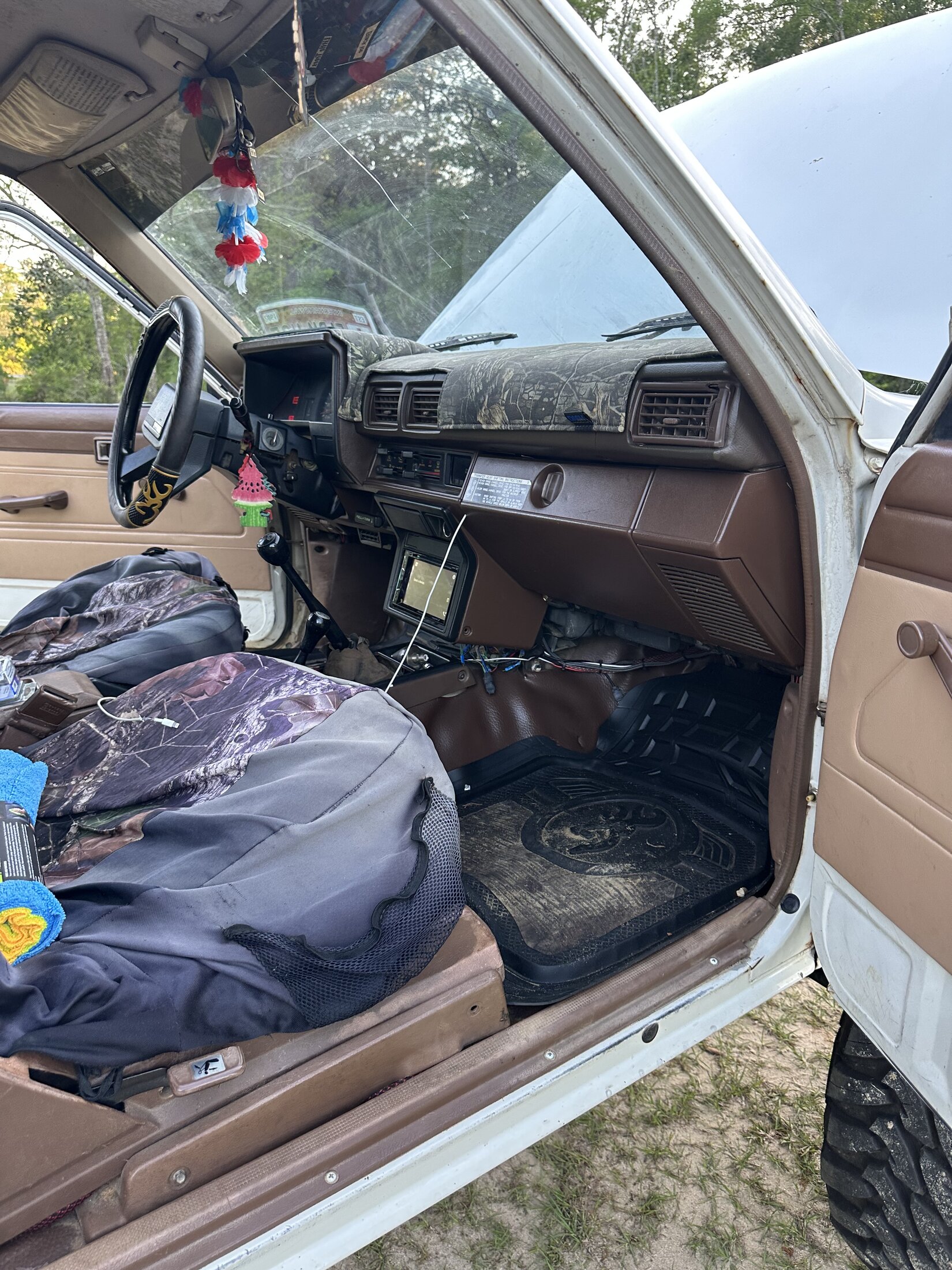

Any idea on a price range? Interior is pretty rough but no rust in floor boards or up underneath. Seats are shot and some of the plastic paneling near seat belts is shredded.

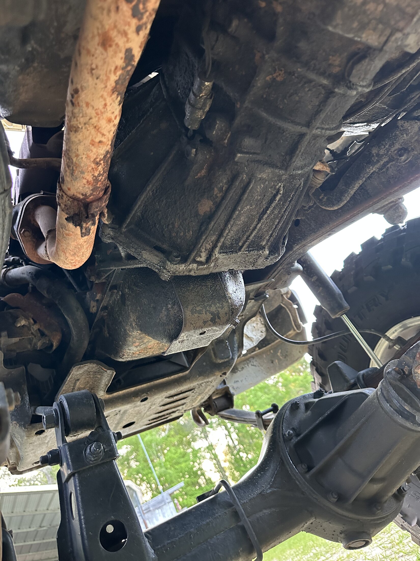

The body doesn't "look" too far gone yet. The visible rust is just the surface. It's definitely worse underneath but now is the time to get a handle on it. The windshield frame would be my biggest concern. I'd think that it could be pretty bad under the urethane sealer. Overall it looks like a decent truck. I guess it depends on what you think of the rust. If you want it fixed and pay someone it won't be cheap. If you have the time and skill, I don't think it's too far gone yet. Look inside the cowl and make sure it isn't rusted out. Does it have any filler on it? I personally won't buy rusty trucks but that's just me being spoiled in the desert climate I live in.
Front diff NEEDS to be re-geared. I'd think the asking price should reflect this. Not too expensive if you can do it yourself though.

The rust around the windshield is concerning. If its in that spot, guaranteed its in other spots under that chrome windshield trim. Thats a $5k max rig in my opinion. Maybe $3500 since it leaks or burns 1-2qts of oil per oil change. Thats a significant leak. It has a huge skyjacker lift and tires that sounds like you'd be selling anyways. If the price is right, grab it. But if youre looking for a more stock rig, id start looking for something thats not molested by a previous owner. Judging by this one it looks rode hard and put up wet. I dont like buying other peoples junk unless its a full tear down or for parts.

I wouldn't buy this one at any price. It looks beat, the mods are bad news and the rust is problematic- especially around the windshield. The fender sheet metal is real thin on these, so once rust gets established they could rot away quickly in your warm, humid climate. IMO, also expand your search to newer first gens with IFS. Want reliable? You can run 32 inch tires on these trucks with no lift.
