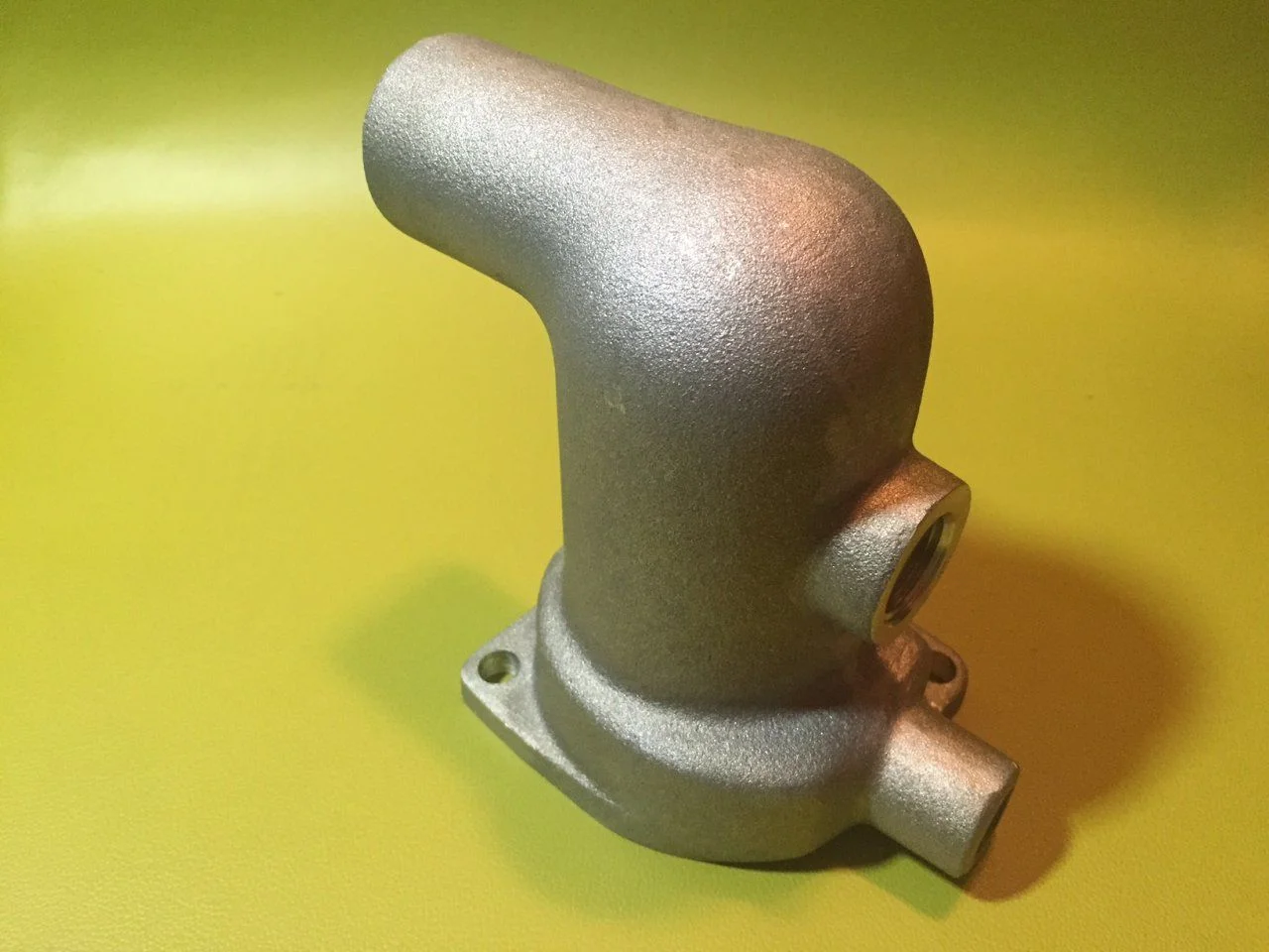

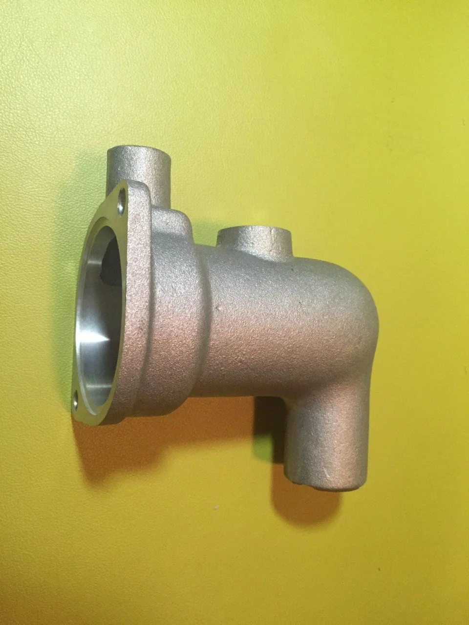

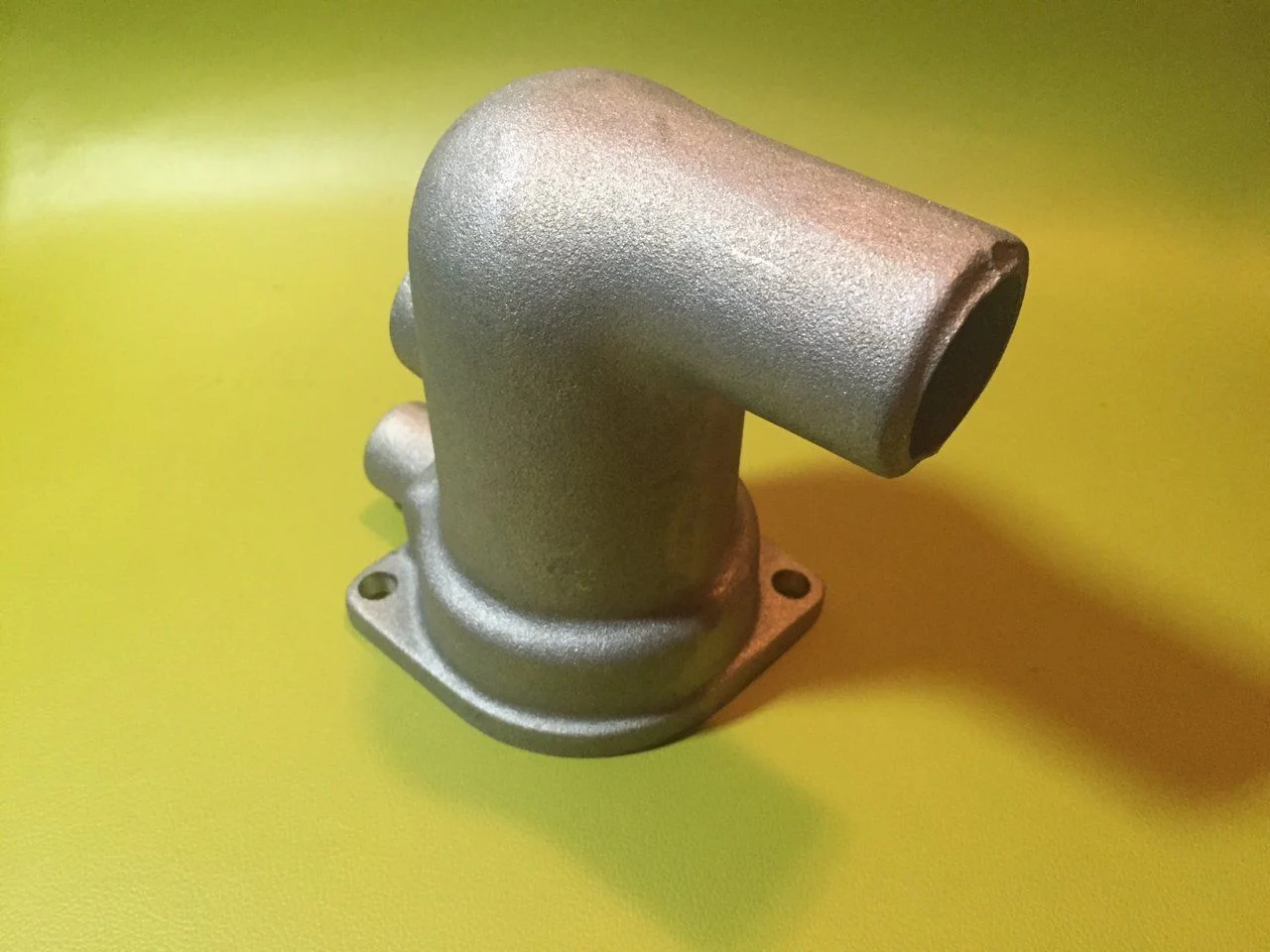

Something weird happened. Here's the story: I asked Toyota to send me some 16333-61020 thermostat housing through a special order, which is a thermostat housing for oil-cooler equipped cars from '76 to '79. It's a part on its death bed, but that's another story.
What I got is something I've not seen before. I am quite certain they built the wrong part. Does anyone know what this is?

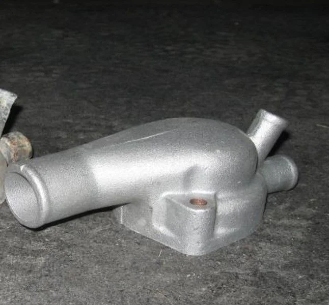

looks very similar to the early F 135 housing
I'm guessing @65swb45 might know ....
Looks like my F135 housing... except 50 years newer.
Does yours have a port on the neck as shown in my photo?
Can you snatch a pic of yours? What year is your truck?
If this is for a pre-'69 vehicle, I can't look up the part number because it's not in the Toyota database.
It's prolly on the early micro-fiche, for anyone who has access to that. I've seen it posted in pdf format, but can't find it now...

But the part picture above is definitely not 16333-61020.
Great, Beno is here. Any idea what is the part in question?

That part is from an FJ25. 16333-60020 is the correct part number.
Really? Is this information only available from micro-fiche? Do you know if this is a live production part?

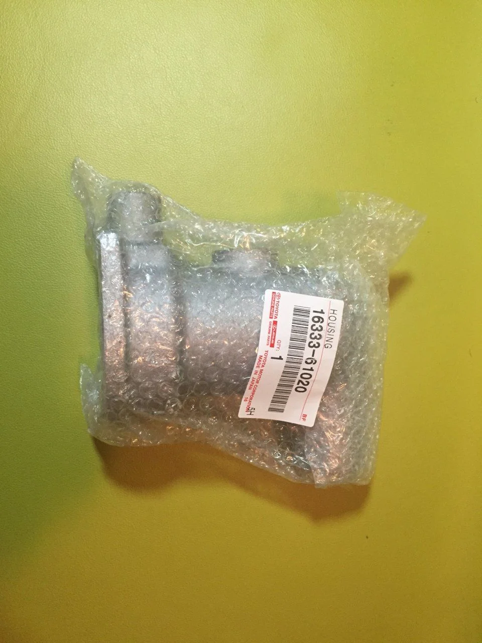

It's odd that I got this part with a 16333-61020 sticker. I guess they missed the "1".
16333-60020 is long discontinued so you basically got something packaged incorrectly. Great find. Worth it's price since that part specifically is long gone.
Yes, microfiche parts file.
Do you know if it's supposed to have a port in the back?
I'm posting these questions in the FJ25 Forum.
