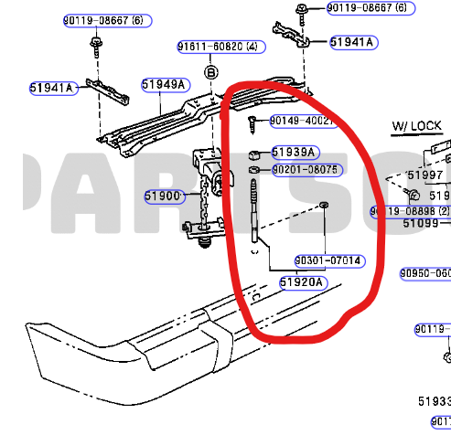

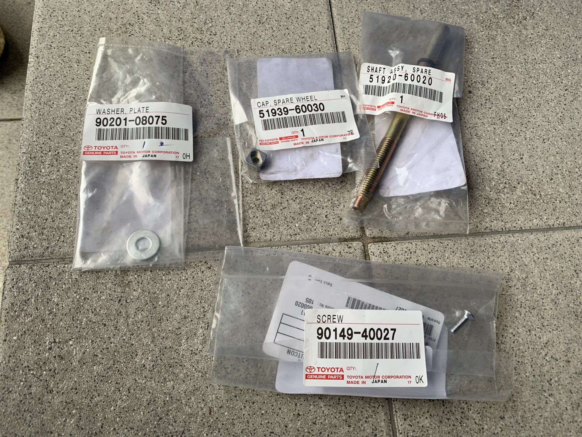

Found a post on it.
Thats pretty rad. So the bolt blocks the spare tire port above the bumper. They could have made it a little nicer looking/a little shorter haha.
Found a post on it.
Ahaaaa yes that makes sense. So mine is in the ‘unblock’ position as I can lower my spare without a problem and that would also explain why it’s in the way as it is supposed to be down in the ‘blocked’ position during everyday use. Thanks so much for finding this!
Hahaha, this is the bolt I have been on a crusade (ha) trying to replace on mine. It’s a bolt to prevent theft of the spare tire, as posted above. Where is your Cruiser from? This only existed in “sus” markets AFAIK, so mine is from the Gulf and they usually had it. US/JP did not. It basically needs a new metal plate and obv the bolt which is stripped in my case which makes me sad. I think it’s a cool, but useless, feature. Especially since you probably have a rear door mounted spare too. So they could just take _that_ spare :D
